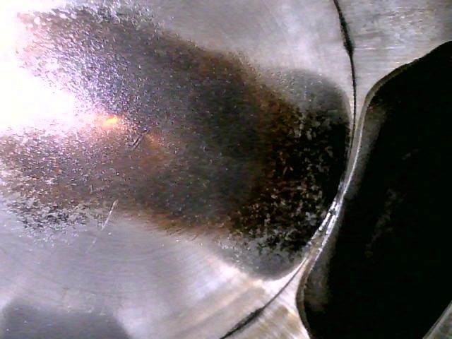

Update:
140AC / BE5 / 118 - 20° timing
Has a couple hours on it now, multiple high speed runs, one full 2-mile uphill WOT torture test. Seems good, runs strong but suspiciously cool ... couldn't get the temp above 248°.

hopefully the burn pattern gets wider. Wonder if lowering the exhaust port to below piston crown might help.

dropping the exhaust port to meet or sit slightly lower than the piston will in all likelyhood shift your power across the rev range and move it more into the overrun.
seen that done to an older malossi and PM tuning used to do it on there malossi kits..
is that good or bad or possibly both depending on your point of view?

SoCalGuy wrote:
Update:
Any chance you had an air leak on the old top end that's now fixed?

If the timing is really 20 degrees, then that's plenty. How does the spark plug look at WOT? Main jet might still be a bit big but I wouldn't change it until that piston is fully black.
As it held out uphill, it's not far away.

Plug's too dark. Still sputters 1/2 to WOT.
Possible. But there was literally no sign of a leak at either the base or the head. Engine idled fine, temps were reasonable... no other weird symptoms of a leak.

Weird and frustrating, especially on what you thought was a reliable motor. A loose stud turned into a head leak, turned into a seize at 60mph on my Sprint motor a while back after I *thought* it was reliable. It made me a little paranoid, as I'm sure you can imagine.
The BGM head went in the mail today, so you should have it first part of next week, they said. I'm using one on the Pinasco 177 I'm building for my VBB right now. Assuming I have some time to work, it'll be running on the stand for sure, maybe back in the bike this weekend.

Update, to wrap up...
After 500 miles or so, advancing the timing from 18° to 20° has made a noticeable difference in piston coloration. See pic below.
I'm calling it resolved. The takeaway: I think the combination of too big squish and too retarded timing at high revs caused too much heat down in the barrel, eventually melting the rings at the exhaust port. Advancing the timing moved combustion up closer to the head, where it dissipates better.
Thx all. Hopefully this piston will last a while longer.
