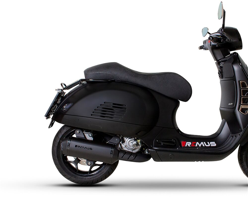

Hello fellows, i'll go with Remus Notte Edition. They have a racing only version, without cat and the mufler have removable db-killer👌
The photo is just an example…ordered it but hasn't arrived yet…
BR: Aron

I saw that in the SIP website this week when ordering some bits n bobs and thought it looked rather nice…
If you have the time and the inclination I'd appreciate your feedback on it - especially as it's de-catted. Interested in how it runs and what (if any) mods you have to make.
If you're UK, will it affect your MOT?
Thanks for the post!

Will arrive next week. It's without cat, but with hole for the lambda. The guys from Remus told me it's plug&play.
I think I may just be about to change my mind on my exhaust, the more I look at your photo…!

If in your country it's not such a big problem with the authorithies if you do not have cat, order directly from Remus, the on without cat is half price and the muffler have removable db killer😉

It is a big problem, hence the "race only" in the description.
