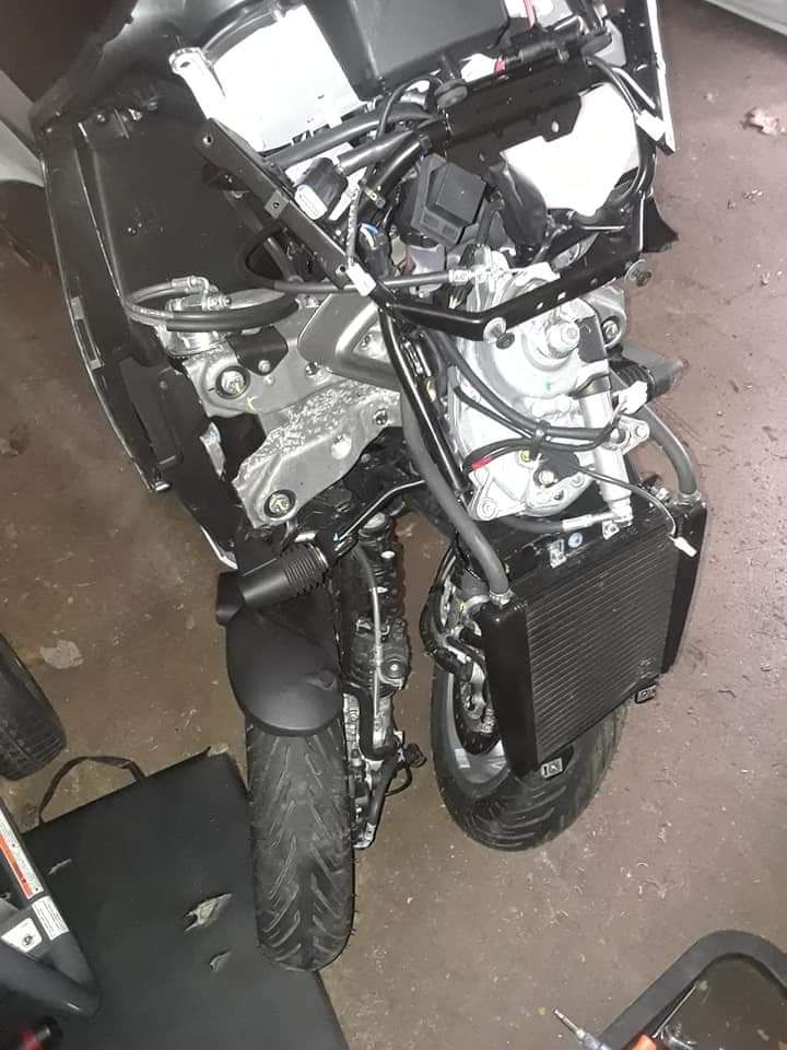

Here is before

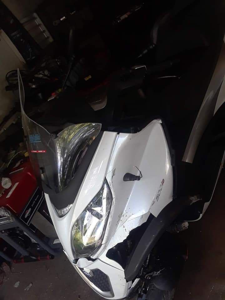

After

After again

most of it i've got in stock unpainted
only a left front leg i need to order
and don't throw things away just yet you need some parts to rebuild

relace also the radiator frame its bend

I see a bent left fork unless that is just the angle of the pic.

thats also bent
left frontleg
Radiator
radiator frame
all front covers
headlight unit go for this one 1D002748 it got 2 drl in it
