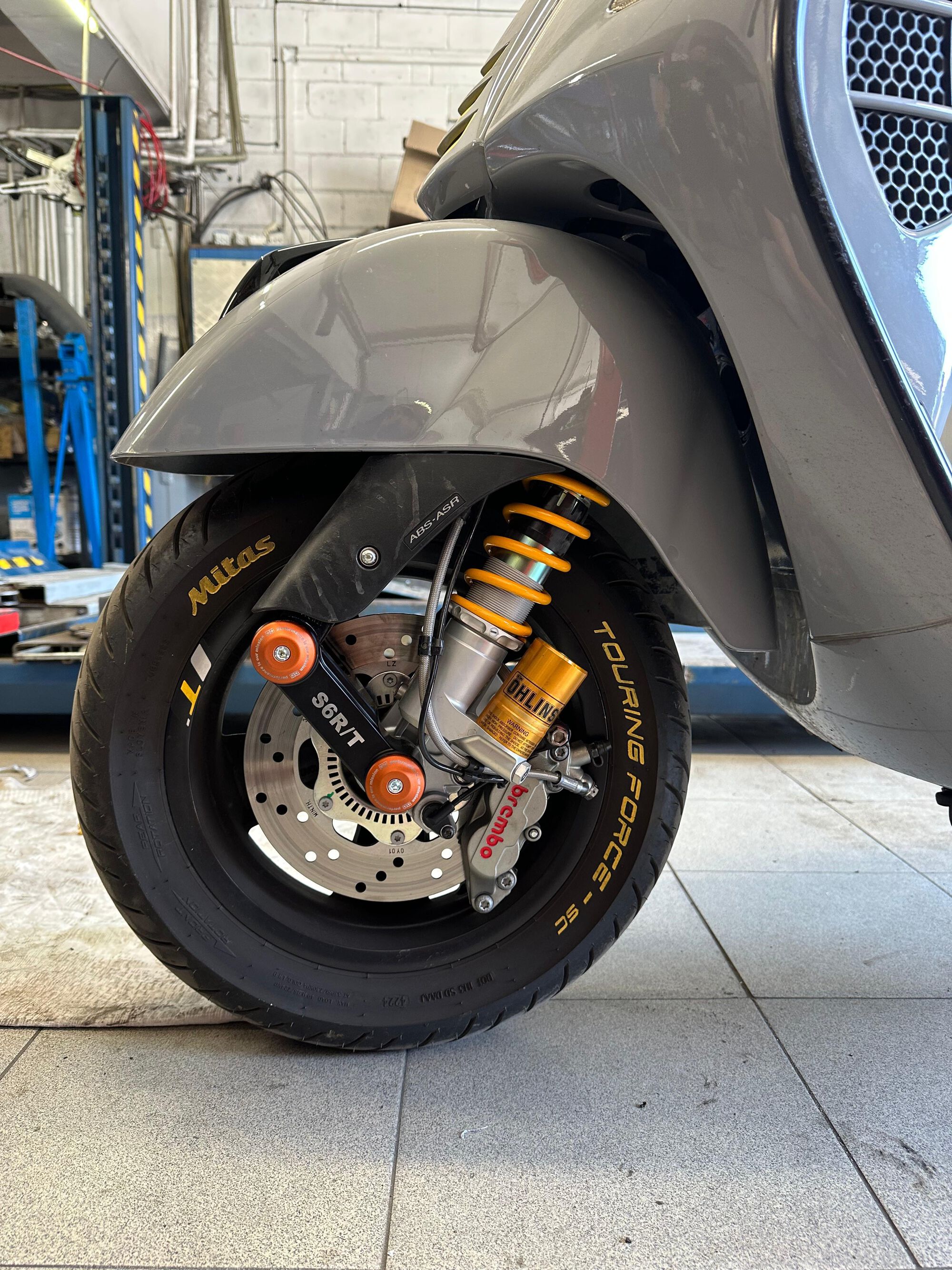

Do the brembo brakes fit into the 12" wheel?
@sashke avatar
GTS SuperTech
Posts: 9
Location: Kazakhstan
@sashke avatar
GTS SuperTech
Posts: 9
This Brembo fits R12.
