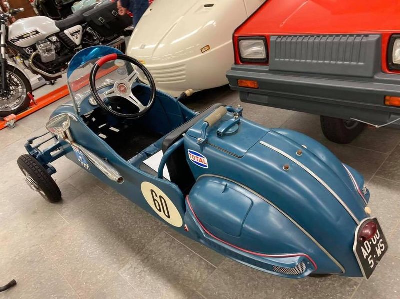

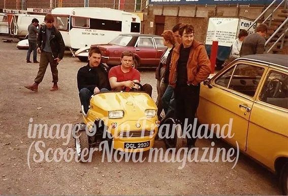

Yes it's a trike. Here is another picture of the thing (best resolution I could find). I have spent hours trying to find more pics in the web. I reached out to the Vespa club that it belongs to in France a while back but have not had a response. I want more details on the whole front end.

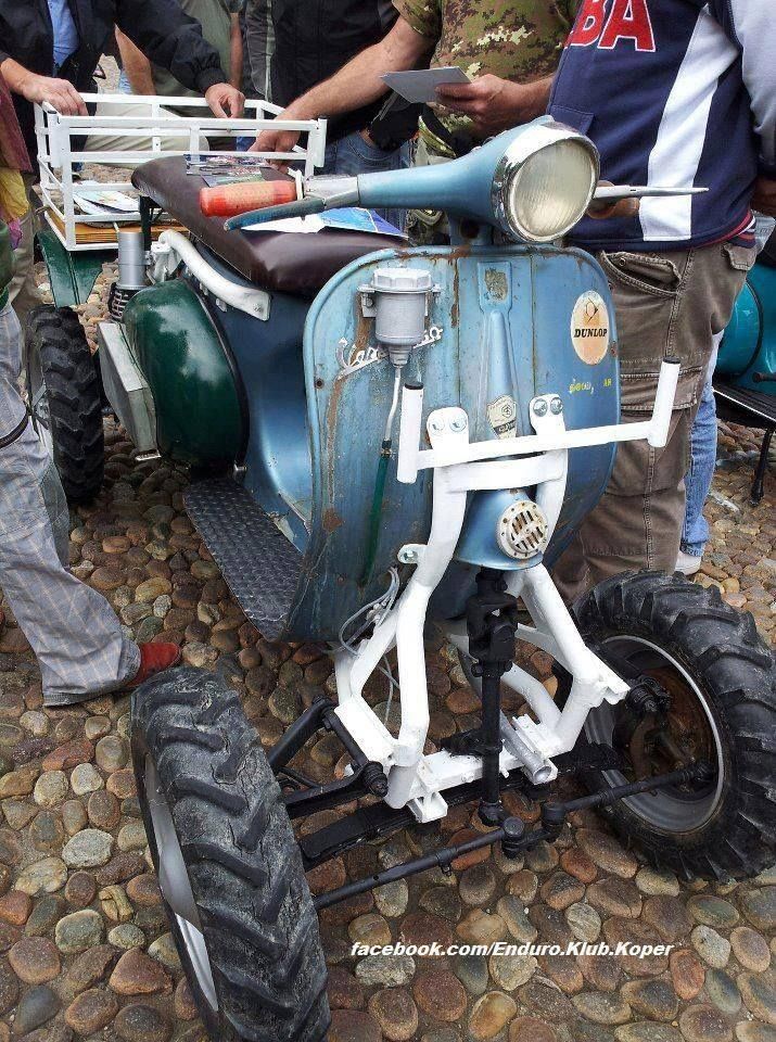

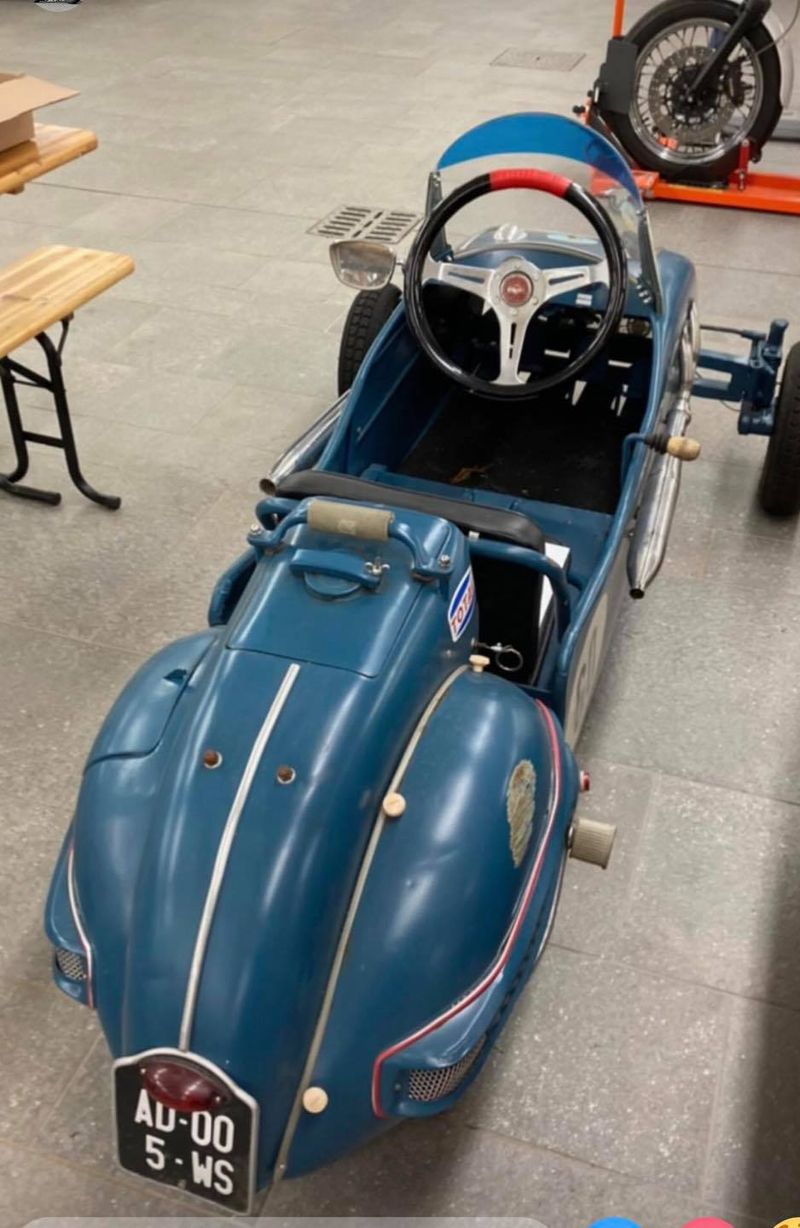

Fortunately one of the pictures is one you don't have. The front suspension does look pretty agricultural... The other ones are clearly quite different but may give you some ideas.
The transverse leaf spring on the blue one is kind of nice, low COG and low complexity but probably also harder to adjust.
Might be 4 wheels...

that suspension is straight up old school air cooled VW front end that's been cobbled with the forks. for that matter, the metal work is probably from a VW donor as well.
bring it into the future and put ATV stuff up front.

And found this one - just for interest.

Remember the old bumper cars at the carnival? I think that's the look and feel that is desired here. I just noticed that the original is actually a widebody, so better an AllState than a good widebody. But it IS a nice AllState, and it would be a shame to it whack up... does NOBODY have a crunched roundtail or other older frame close by to swap here?
External inline image provided by member with no explanatory text Looks like Elvis!

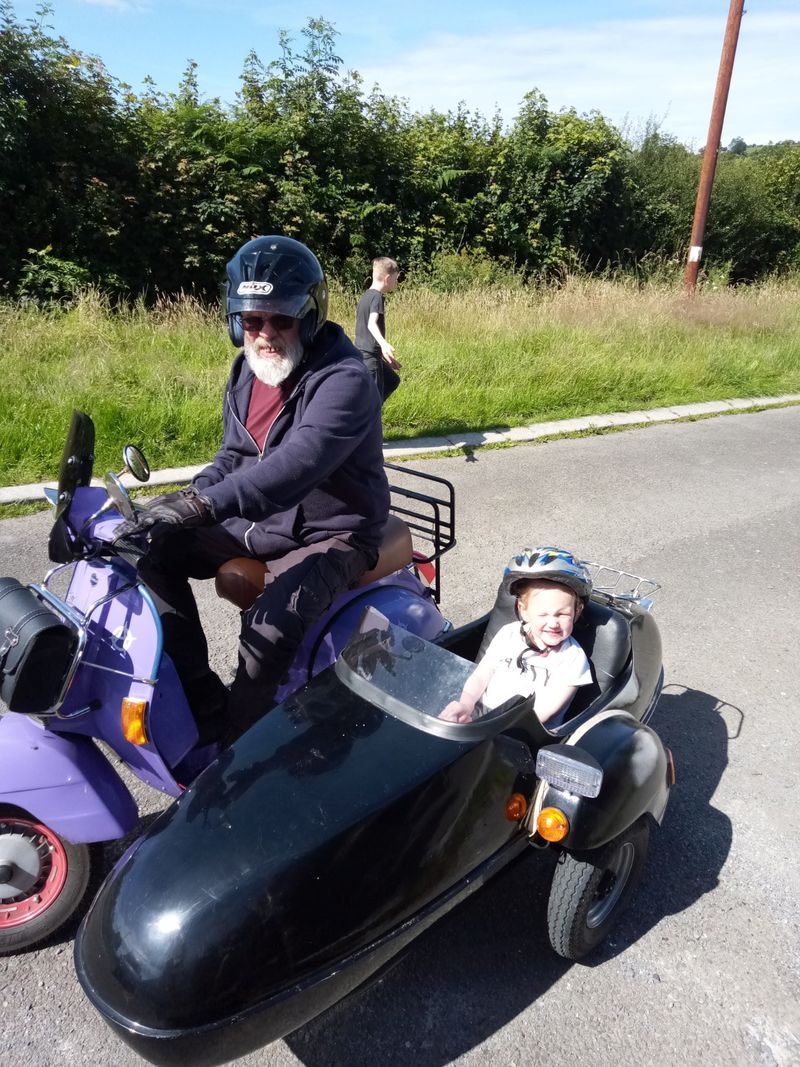

PureDrivenSnow wrote:
Anything is better than a side car project.
Nope sidecars are brill according to my 4 yr old granddaughter and her cousin Tiger Lilly who is 7 and I am not allowed to get rid of it

I found another widebody version today. It looks like they peeled the legshield down to make a floor out of it.
The Taffspeed brothers built a reverse trike out of a Dodgem carnival car way back when...
https://scooternova.com/2018/04/10/the-taffspeed-interview-only-in-scooternova-magazine/
All of the fun of the fair! They look like they're having the absolute time of their lives here!!!

Mattgyver wrote:
I would also consider a Stella or PX just for the engine at least. You could keep the electric start to make life a little easier.
This is brilliant improvisation. Even the center channel has been bent up to serve as a steering column support. 👏

nomadinsiam wrote:
and without that bench seat on it, a person could fab up some huge high-rise 5 gallon fuel tank that doubles as a head rest.

Found some pics from a different trike.

Oh man, that looks like a lot of fun!
