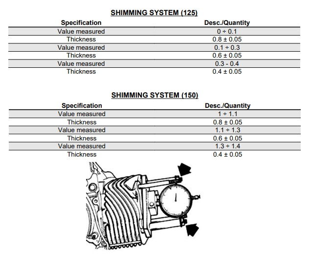

Ordering the rest of the parts, I found that it's compression is regulated by the cylinder base gasket - the head gasket is always the same. To choose the proper size, one need to measure without cylinder base gasket the difference between piston in TDC and cylinder top.
Now - when it comes to aircooled Vespa LEADER engines, there are only 125 and 150 cc. For 125 it should be 0-0,4mm and for 150 it should be 1,0-1,4mm.

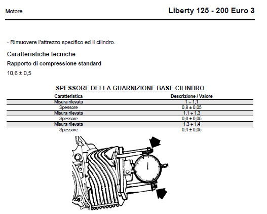

I grabbed the manual for Liberty 125 - 200 cc and this shows only one general 1,0 - 1,4mm.
When I install my 200cc for check, the difference is 0,2mm. All this makes me think that 150 has different cylinder design (the combustion chamber seems to be 1mm deeper?). Or the crankshaft used in Liberty 200 is different.
Liberty 200 LEADER has 8411965001 crankshaft, when 125 and 150 LEADER has 8412985001. As some of you wrote that 200cc cylinder is plug and play, can anyone confirm that the crankshaft/conrod kit is the same, or I will have much higher compression?
