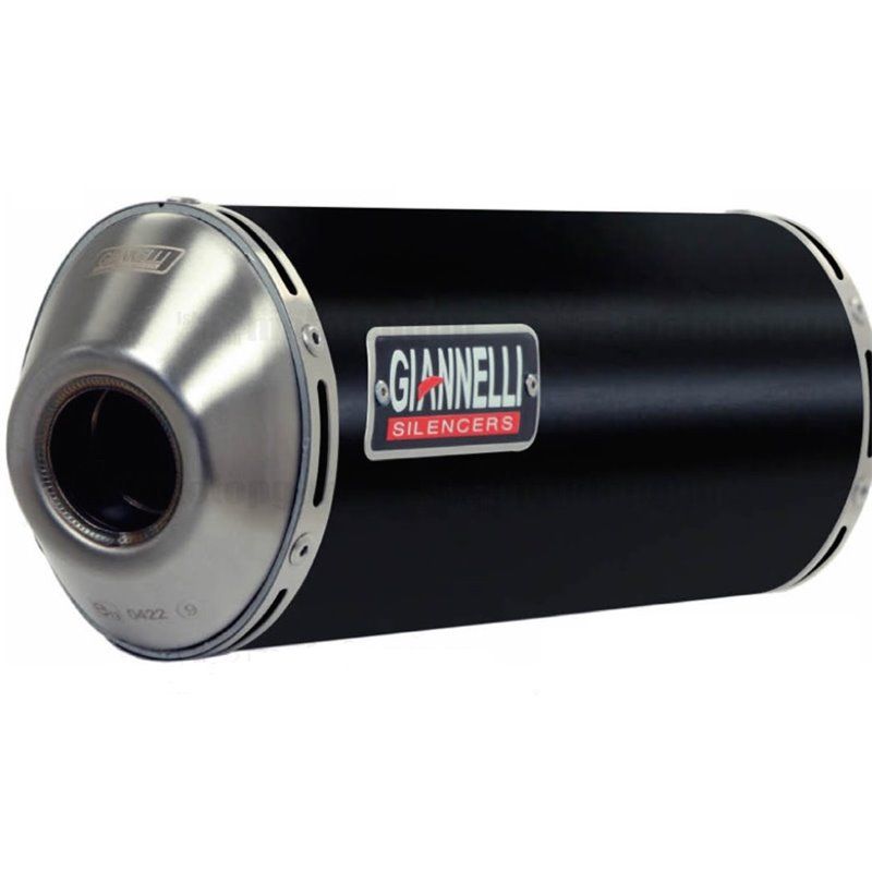

Giannelli (73672A2) aluminum slip-on 8.82Lb (4kg) - $275 (ebay, lists only up-to 400cc size)

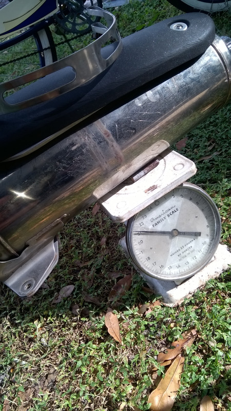

stock muffler weighs 21.2lbs.

Giannelli is price quality the best same maker as Leovince but 100 euro cheaper

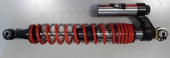

The only thing I added were the Piaggio branded Bitubo fully adjustable shocks. Those made a huge improvement.

Thanks so much for the insights - I have no fault with the shocks yet (mine has red ones, no idea if they are stock) but that is typically an area I look for in my other bikes. Mind you, with the amazingly planted front feel of the MP3, it'd have to be amazing.

You have got the factory KYB shocks, which are slightly better than the older style black shocks but are no match for the Bitubos with external oil reservoir which are infinitely adjustable.
The KYBs are only adjustable on the preload.
The shocks are the single best improvement you can do to the MP3, but just like the Akra the Bitubos are not cheap at over 600Euro retail. However, I found mine and other MP3 parts on Amazon Italy for around half price.
In short, the shocks are a much better upgrade followed by the gel comfort seat dollar for dollar than the exhaust.
TIP: Since you and your bike are new to the MP3 scene, it is crucial that you have the front bearings adjusted and lubed. I lube my bearings every 5K km/+-3K km with every engine oil+filter service. The front bearings are the single biggest Achilles heel and pain in the SS and wallet with the MP3.
That first 1K km service, which includes bearing adjustment and lube, is probably the most critical service the bike will ever get. If not done yet, do it now or pay the consequences.

Thx for awesome advice - the initial service was performed at a very reputable shop and I verified it.
Can't see these shocks anywhere yet but shall look some more!
Totally appreciate your input!

This place has them.
Easyparts.nl is a great site with great service and they ship worldwide.
https://www.easyparts.nl/Rear-Shock-Absorber-(pair)-BITUBO-MP3-p33537134
