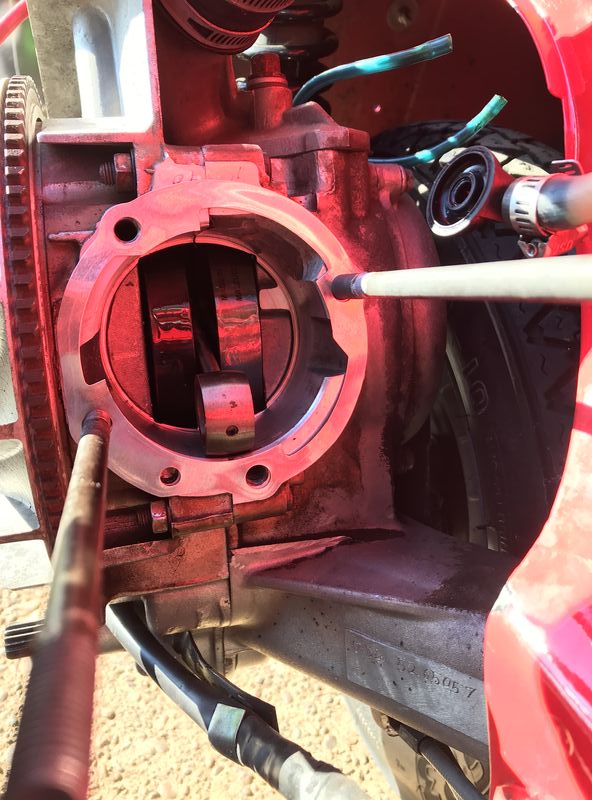

I'm building up my first p200 motor from NOS piaggio cases and all new internals. I had the engine built and buttoned up (but never run), but had to split the cases again to deal with a kickstart issue.
I've got a Malossi 210 top end, but I hadn't planned on matching the cases. Now that the cases are split again, I wonder if I should go ahead and grind away some of the material on the port on the flywheel side case. I can grind that out and protect the bearing from getting fouled.
I'm not interested in disassembling the crank side and don't want to try to match that case (too hard to keep swarf out of the bearings).
So I guess I'm wondering whether it would be desirable to match the one case but not touch the other, or if it's better to just leave the cases stock given that I'm not going to be matching the other.
[Not sure why the pic isn't showing...if you right-click on it you can download it, it just shows the case and how the port doesn't match well with the malossi cylinder; the black Sharpie was drawn using the cylinder, not the gasket]

Hmmm ?
Couldn't open it.
Maybe rename it and save it again on your end, and then upload in a reply.

Renamed attachment...

Here's a pic of what the 210 Sport base gasket looks like laid over the top of the engine cases. Nevermind about that 3rd port on the case that had already been open up. That happened in the past for a 215 cylinder kit that used to be on it. A significant amount of flow will be blocked if the cases aren't flowed to match. But it sounds like the consensus is that won't add much HP or torque. I'd figure I would post up a pic so there's at least something interesting to look at.
