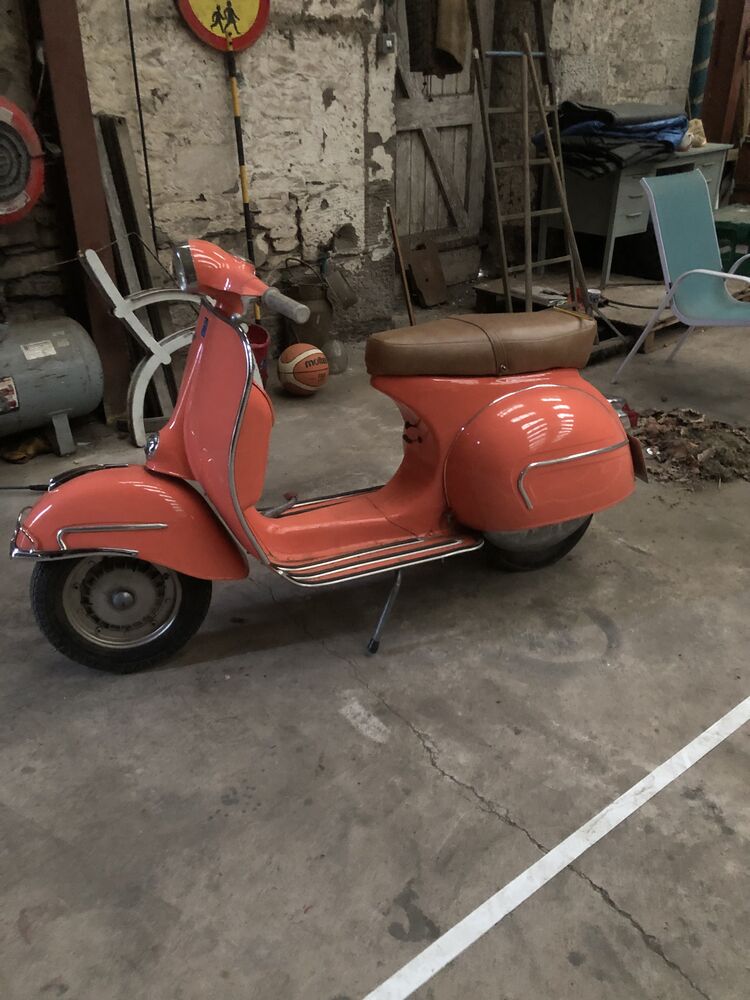

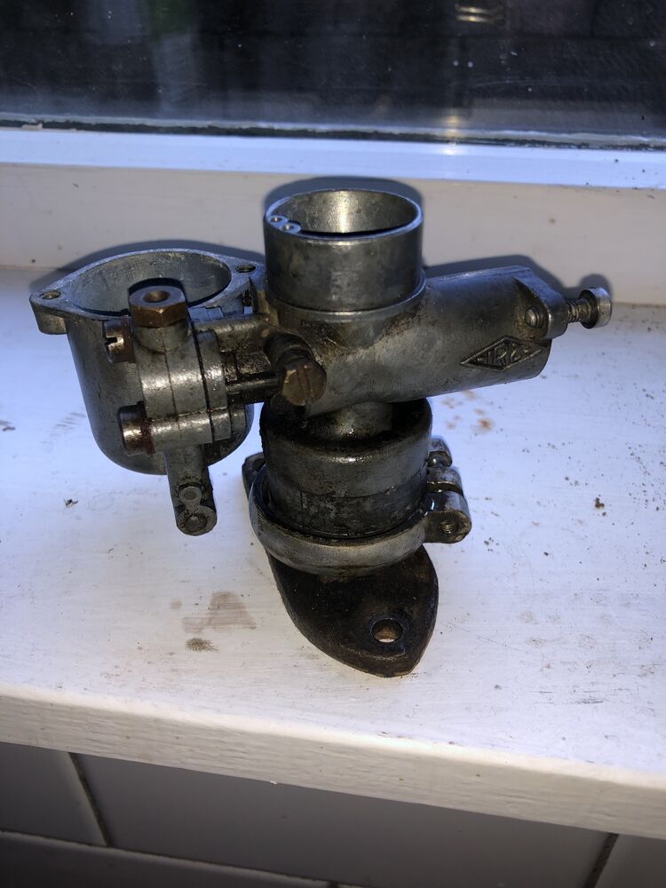

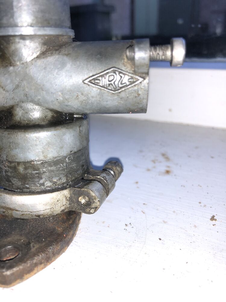

Hi all, I've finally taken the plunge into the Vespa world and got myself a 1964? Motovespa 150s. Does anyone know where I might find seals and Gaskets for the carb? Had it running but soon conked out so starting with the obvious. Have cleaned the carb out and want to replace all the gaskets while it's off. Is cutting my own gaskets an option?
Also does anyone know if this will fit
www.recambiosmotosclasicas.es/carburador/kit-carburador-vespa-150-y-160
and is it worth doing? Should I be looking to keep it all original?
All advice welcome.
P.S. the colour will change!

Even though it does'nt work , it is still a thing of beauty

Im no expert, but i believe the 150 Motovespa's are piston ported, so you will need some specific parts for your scoot. Cutting your own gaskets is always a good option, go for it.

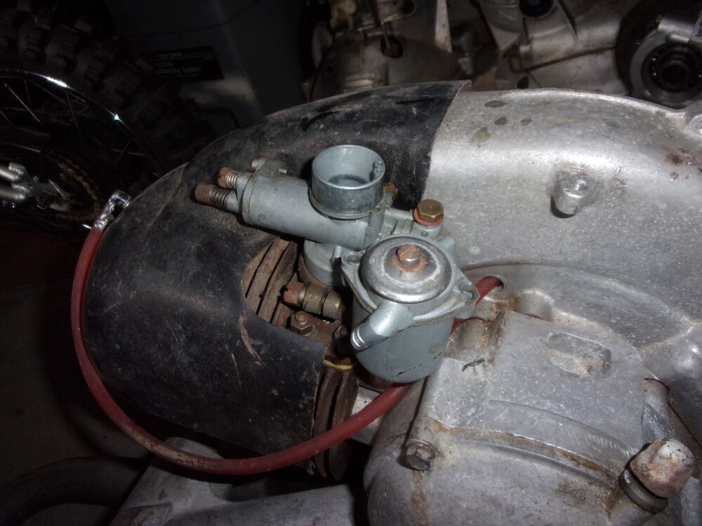

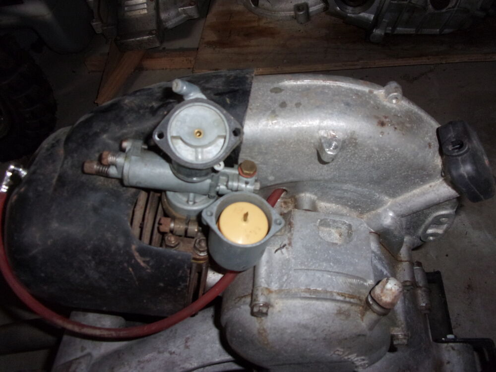

I also have a '64 150S. I was my first Vespa and I rebuilt the motor and rode it around. It died the first time out which turned out to be the breather hole in the gas cap. At 6.5 hp, according to the original manual ( in Spanish), it is a nice ride but way under-powered for the roads around here so I swapped in an LML/DR177. The original motor is moth-balled. I do not remember any specifics on doing the motor but the only real difference between piston and case ported is the location of the inlet. In fact, the cases are cast for a rotary inlet. And the 5% oil mix !!
That kit you linked is wrong for your motor. That Spanish IRZ carb is an odd rarity for sure and, if I recall... maybe 17mm. Gaskets are no big deal to make. The needle is incorporated into the top of float and the seat is fixed in the bowl cap so you can't just replace the needle and seat. IRZ made a lot of carbs for motorcycles but they were horizontal not vertical. I don't know if any parts are interchangeable.
I did find another junk carb and one point for the bowl cap but I haven't been able to find it.
The inlet's busted short and one eye is broken but it works, thankfully.
