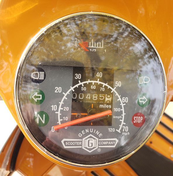

Fortunate to obtain a 2008 Orange Stella with 473 miles. Always garage kept so cosmetically in great condition. But hasn't been started in years and years.

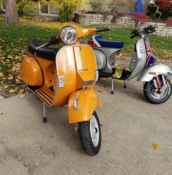

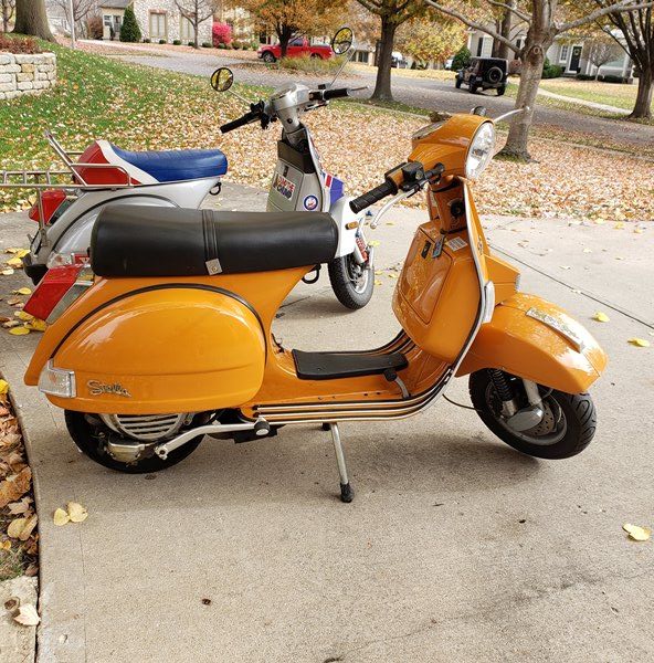

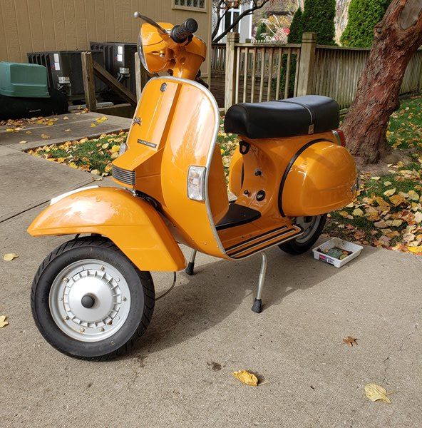

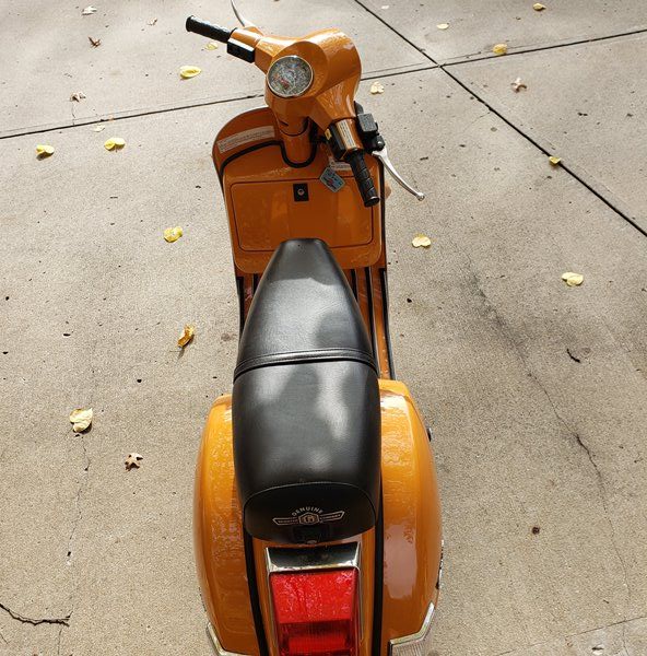

I rode it around the neighborhood for about 30 minutes and the smoke did get less and less, but it is still smoking a little. I guess it will take some time to clear.
Here are some pics of the scoot:
