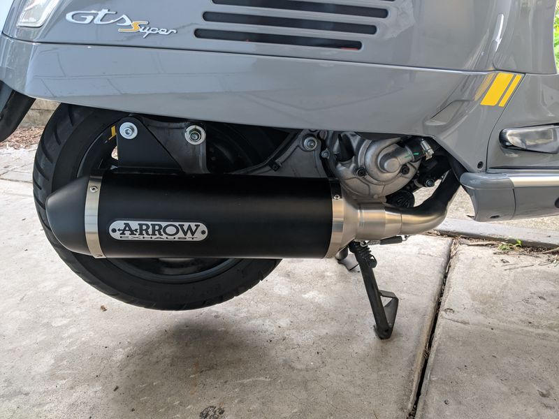

2019 GTS 300 HPE w Malossi
Posts: 9408
Posts: 9408
I have the Arrow exhaust on my Supertech. (I chose the black one - not in picture on their website)
Malossi rebrands this and is more expensive for simply a badge change
https://www.arrow.it/en/assembled/1652/Piaggio-VESPA-GTS-300-HPE-2019
