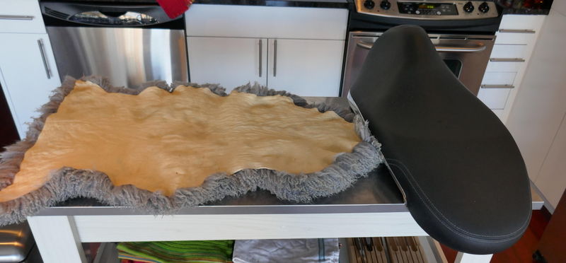

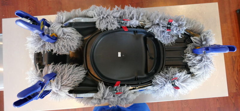

I hate sitting on a hot black seat
A cover is easier than a recover
Here's how I do it
Wet the skin
Stretch & clamp skin around seat, dry overnight

Shave wool where I sew on webbing or form a pocket for the cord

What's it look like when you're done?
[Edited for clarity]

I have a shoe patcher, I have done other covers with a regular home sewing machine, hand sewing minor repairs
I used the mounting point of the chrome trim to keep the cord down

the only modification to the seat is a couple of notches in the seatpan at the base of the hindge
On other scooters I have sandwiched the cover under the hinge where it bolts to the seat pan
same with the rubber bumpers on the other end

Seat open view
Finished closed view
The seat latch still works fine
The wool does touch body work, but not any of the webbing, skin or rope
Removing the seat
remove pet carrier, battery box doesn't need to be removed
Remove a small bit of body work [4 screws]
Remove e clip & pin
I'm very pleased with how comfortable it is
