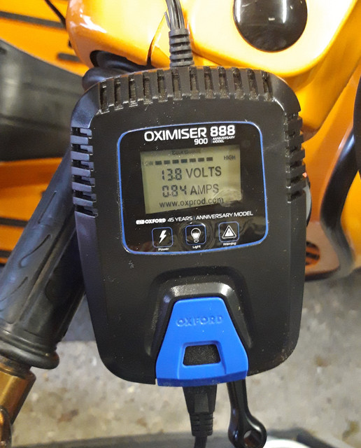

I had a few hours to kill today, so I decided to fit a battery tender in the kick panel next to my 12v charger. My trickle charger came with a extra connector that plugs into the cable, rather than using the crocodile clips, and that came in handy, fitting it to the kick panel!
The only tricky part was guiding the wires from the battery connector, up behind the glovebox, and into the kick panel. Apart from that, it was pretty straightforward!
the extra cable I fitted to the kick panel
upload in

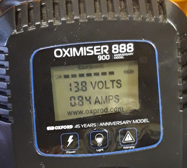

The trickle charger itself

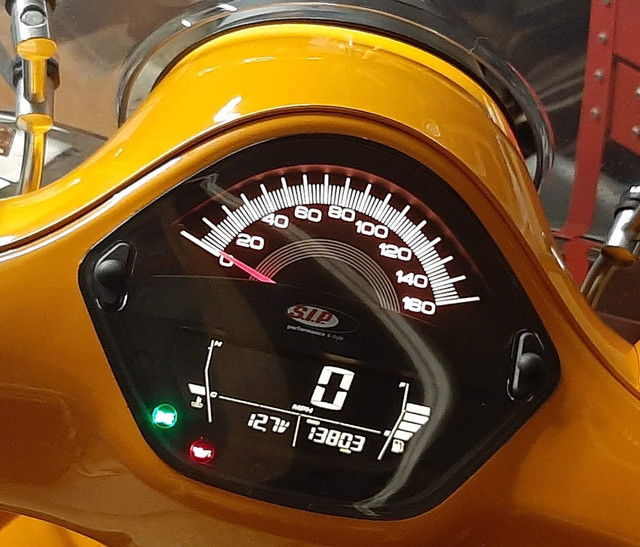

Yep, it's directly connected to the battery- I can get the battery status directly from my SIP speedo.
This is proving to be very handy when I store the scoot away for the winter, and I can check to see how much voltage is reaching the battery from the trickle charger itself!
Thinking ahead then. You will always know if your rectifier is bad.
