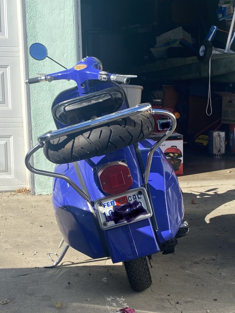

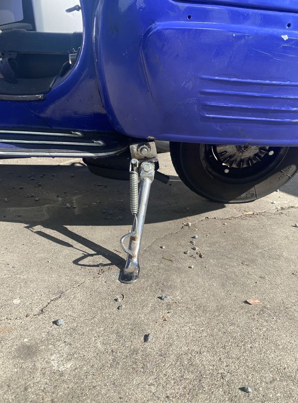

I've got one and use it all the time. It does interfere with the center stand. To use the center stand you've got to put out the side stand first.
I've got to be careful where I park with the side stand. Mine is on the left, but the scooter is weighted on the right, so it always wants to lean to the right. Just a little of thought ahead to keep it on the stand though. I pretty use it exclusively, unless I'm doing work on it.
Crappy pic, but you get the gist...

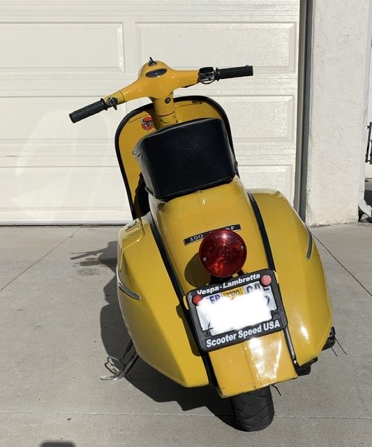

If you figure out how to reverse one to RH, keep in mind the parked bike needs to be nearly straight up vertical or will flood, ask me how I know. Then yes.
It will STILL be more stable than a stock LH. My experience anyway, here's the ONLY LH I tolerate.
cast aluminum on sturdy steel bracket
before removing & stripping off white paint
cast aluminum on sturdy steel bracket before removing & stripping off white paint
I like how it automatically retracts when unweighted
parked on slight grade with foot downhill
on the level, walk by too close, Hello big Yamaha

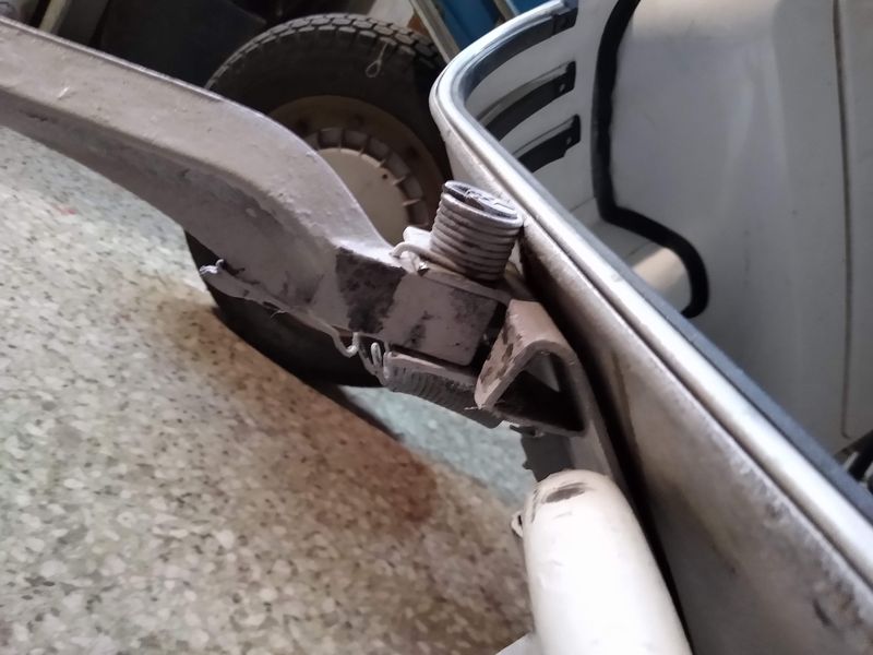

Voodoo, I have the same side stand on my 221. Works great. Independent of centre stand. Springs up on its own; a handy feature to avoid dying.
I have found a few mm of spacer between the side stand and frame, avoids damaging the floor.

Jack, a trick to keep that particular aluminum sidestand from whacking against the frame is to slide a kickstart rubber foot pad up over the sidestand leg. And they come in all sorts of colors, black, grey, blue, red, ect...

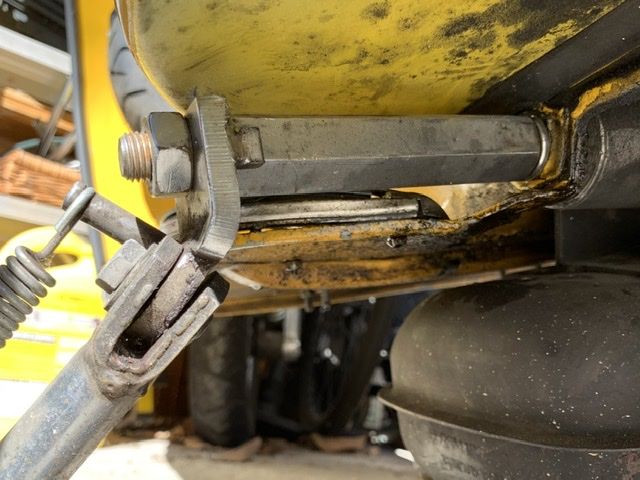

tipsy
Voods and Co. here is a mount pic. there is an adaptor/extender that screws onto the center bolt. Mine has been very stable and yes I sketch out parking on an incline but its worked great so far.

Yup, that's it. And modkuo gets full credit for turning me on to it (thx again bro).
Here's a picture showing how it mounts. Excuse all the grunge.

The stand off that it comes with replaces the nut that would normally be there?

Right. Same concept as the extender on the top of the rear shock.
The extender screws onto the end of the center bolt and effectively becomes the new nut.

The spacer between side stand and frame isn't to stop the whacking (which it does do without a rubber pad) but to stop the flex of the sidestand metal marking the floor. For us that don't do bodywork more prevention is necessary.
