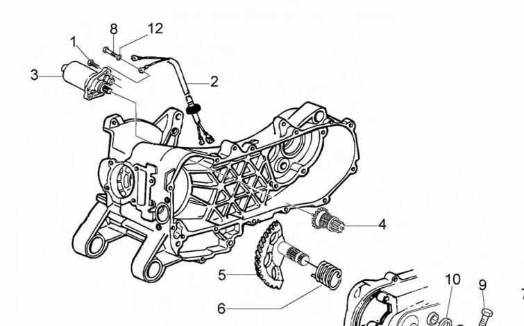

The starter motor spins #4 below, which upon spinning is supposed to expand axially, to mesh with the starter ring gear on the crankshaft. I'm thinking the bendix is dirty and does not expand to mesh....

You will have to remove the transmission cover, clutch, belt, and variator to get at it. If you have never done it, figure a couple hours. There are a couple specialized tools that are helpful to remove the clutch and variator but some people just use impact wrenches. Personally I use the specialized tools for assembly, but the impact does great to remove everything.
