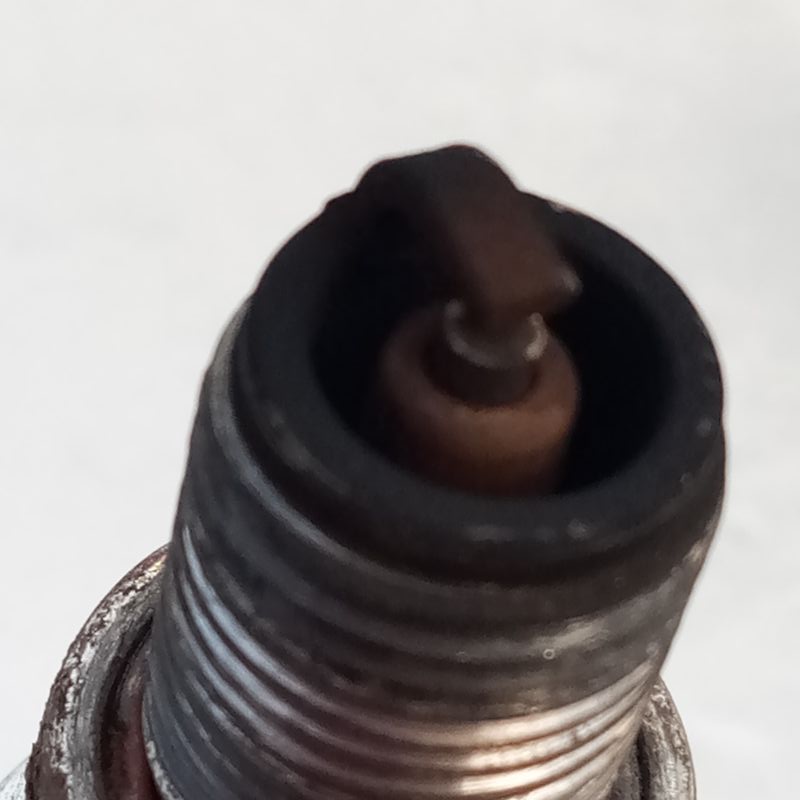

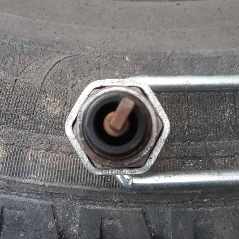

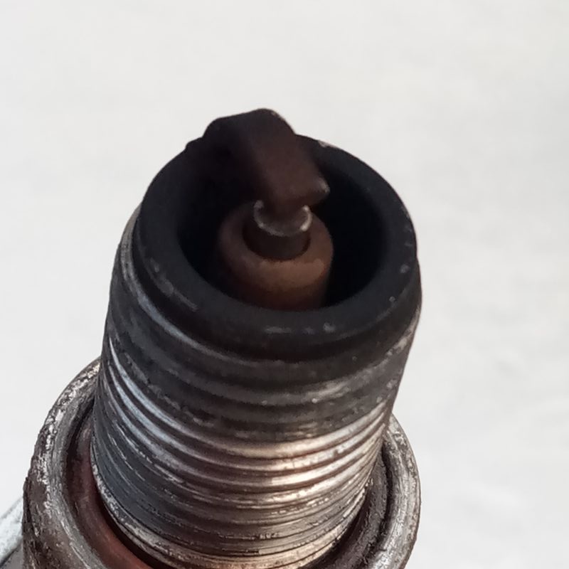

Well so far the only free time I have had been nil but did get plug out and it is very black and sooty.
@charlieman22 avatar
Nedminder
Posts: 4929
Location: california
Nedminder
Posts: 4929
Feel free to post a pic of the plug.
no flash.
Plug can be misleading - since you get an average - but it can be telling too.
One persons sooty black is another one's gray.
Gray = super lean - so go easy on any riding until you sort out the weird revving - and run that carb spray test to see what you get.

Thanks Charlieman22 I shall do the spray test later but for now couple pics of the plug.

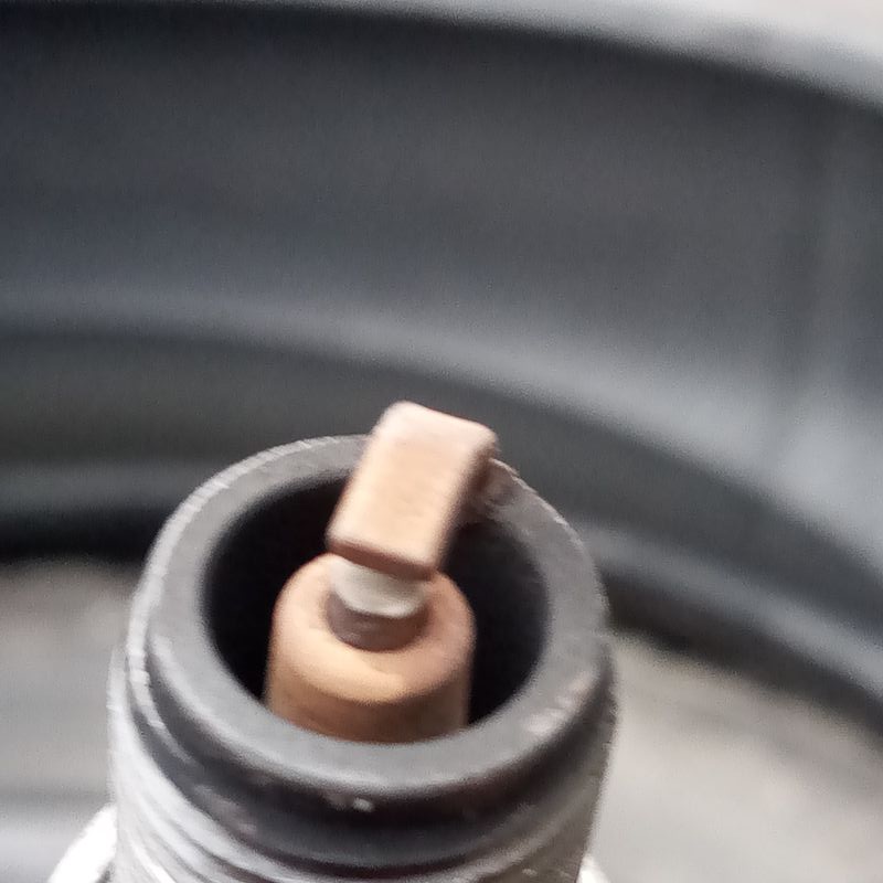

After taking a pic of the plug I did the leak test with carb cleaner, no increase in revs. I warmed up the engine around the yard left mixture screw alone took it for a spin hand hovering over clutch just incase. Gave it some hard riding no problems with revs being high at all in 4 miles. From just off idle maybe about quarter throttle through to just about or just under three quarters throttle a slight stutter ( 4 stroking ? ) and this is the plug now.
After putting plug back upped the throttle stop screw.Then the mixture appeared fine at one and a half turns out from fully in where it has been all the time. Tried screwing it in as a test and revs increased once just below one turn out all the wayonwards in. Am I right in thinking pilot jet maybe.
Mixture screw now at one and a half again.
