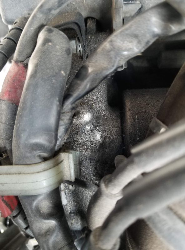

Rode to work today as it was nearly 60. Got home and decided to do a bit of routine checking...tire pressure, oil....unscrewed the dipstick to wipe it, and noticed several spots that looked like little clots of cream (well, mucous at first blush). The oil itself appeared normal. Repeated the process a couple of times to see (hopefully) if it would come out normal. Nope.
I'm thinking possible coolant in the oil? I don't know if I'm panicking, but thinking this could be ominous.
Thoughts?

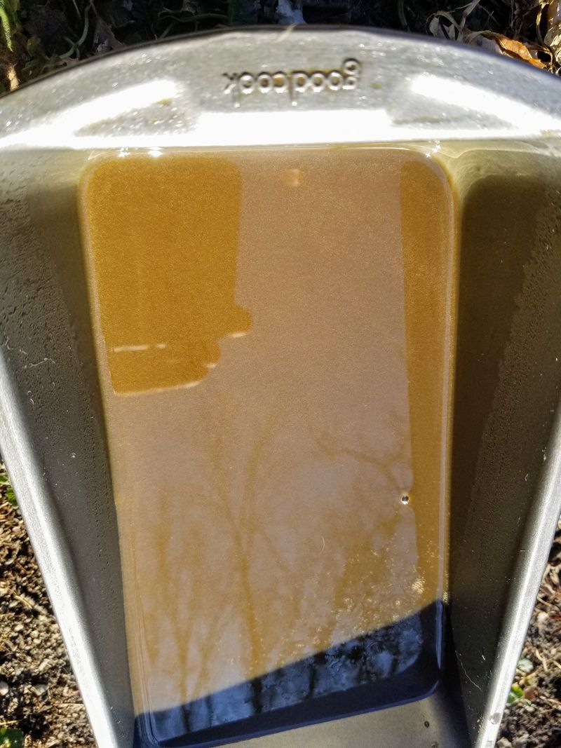

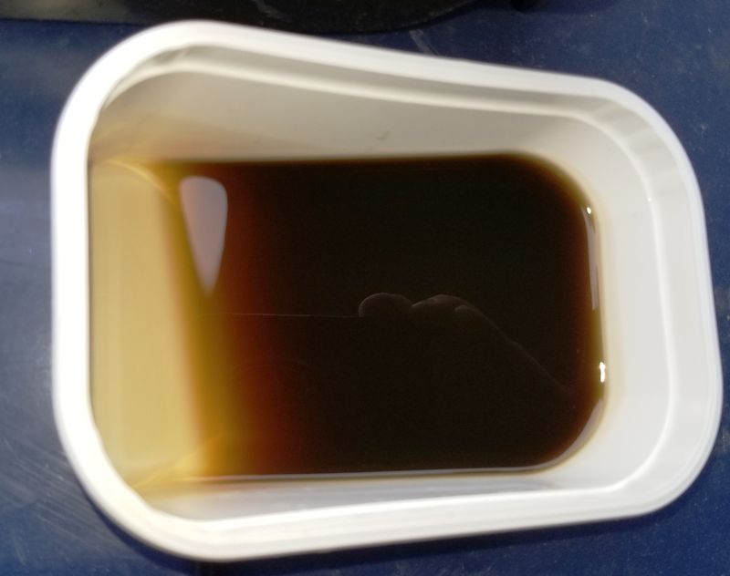

Okay, finally the check-in.
Well, of course it's 2020. Decided to put it on the lift to get the center stand out of the way....rolled really hard for some reason....once on the lift, it was clear I had a major rear flat. I'd just checked when I checked the dipstick, and just possibly the valvestem got jammed or something....it's held air well for a couple of hours now...
Anyway, back to the main issue....ran the engine a few minutes just to warm the oil a bit, drained the oil, expecting, well, hoping it would look normal. I don't think so. Definitely milky, cafe au lait kind of vibe.
I did look around the engine as much as I could and could see nothing abnormal.
So, thoughts?
Maybe doesn't look *quite* that pale in real life, but close enough

vespa cappuccino. Please keep us posted. This is sensationanal.

I mean the first picture was like, sorta OK it must be the lighting sort of thing.
That second picture though...
Ooooooo nooooo. Mama don't like that sort of milkshake.

So if you wait for half an hour or so, does it separate into two layers?

Most likely water pump or head gasket.
What's the underside of the head and cyl look like?
Everything else gets expensive with the quickness.
Good luck!

I'm not sure what I'm really looking at. I tried to look around the engine as well as I could and didn't see anything suspicious.
I did remove the pump cover to drain the coolant, but don't see a connection with pump failure...but this is a bit beyond my basic knowledge....
Any way to differentiate the two?

underneath where the exhaust connects, look for any dampness around the exhaust stub. also, base of cylinder (at the engine block), and between the head and cylinder. the head is alum. and silver, the barrel is painted black.
here you want to look for any weeping, oily junk, coolant, or anything damp.
if you have excessive white smoke on start up and while running.
those would indicate headgasket, possibly basegasket if at the bottom.
failed waterpump? that looks more like what you've got there. you can pressure test the system, but you'd have to devise a tool to do so. basically, when the internal seal fails, it dumps coolant into the engine (milkshake time). when the external seal fails it pukes out the weep hole. so, if it's not dribbling out of the weep hole and leaving a puddle, you can pretty much assume that it's an internal failure.
so, if you don't have anything freaky-leaky uptop then, you're gonna need a waterpump amigo.
your flushing of the coolant had no bearing or effect on this failure.
anyway, if i was a bettin' man i'd roll dice on a waterpump.
yes, then you skim the top off to fry with and use the bottom to slow braise.
j/k
nah, pretty much once it's emulsified it'll stay that way.

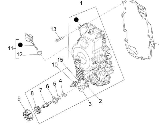

True, in fact the water pump has moving parts and immediately receives the hottest liquid, therefore more subjected to thermal stress. If I may say it has always been a critical point in Piaggio engines, I had an Aprilia Scarabeo 400 (reduced Beverly 500 engine) and I changed two of them. Very expensive to do so and therefore causes premature sale.

Dave - sounds like the collective consensus is a water pump. Seems like you have some Robot videos to watch, Haynes manual to consult, parts to procure, plan and execute!

I am having a hard time picturing how a leaking water pump seal would allow coolant into the engine oil. As I understand it, the impeller (9) is on a shaft (7), and on that shaft are two seals (8 ) and (6). One seals coolant in that system (8 ), the other seals oil into the engine (6). Between these two seals is a gap, and in that gap is the weep hole that allows visual queue when one of the seals leaks.
What I don't see is the path coolant would take into the engine this way, while at the same time *not* dripping out the weep hole. Are we to assume the weep hole is blocked?
I do hope the water pump is the cause, as that seems the easiest fix (Piaggio part 8787565 for that whole cover, with water pump parts installed; looks like ~$165 including shipping). Or perhaps a $40 Scooterwest rebuild?

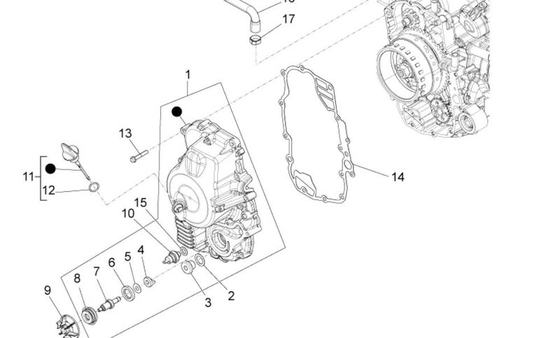

Though, if the gasket #14 leaked right at where the #14 is pointed (on the inboard side of that larger hole), that looks like a coolant duct coming off the water pump. I could see that being the problem.

Robert, is that a GTS diagram? A few things look off there, though I admit I don't spend a lot of time looking at drawings..... good questions though...discussing this at breakfast and realize how little I know about water pumps... head gaskets, well, a bit more.
Seeing it's cold, and i'm old (good time to admit it), time to put it back up on the lift to look around. Nerd emoticon
I can't speak from experience here but those snips are from the BV350 parts manual online.
Posts: 12954
Posts: 12954
fledermaus wrote:
Greasy, thanks for your input! At least I have something to do today....and it's not ass-freezing cold in the garage (no, Barry, not heated. ).
Aha. Just to be clear, it's my GTS that's in the infirmary. That's the downside of having multiple scooters (ask my wife for a more comprehensive list ).

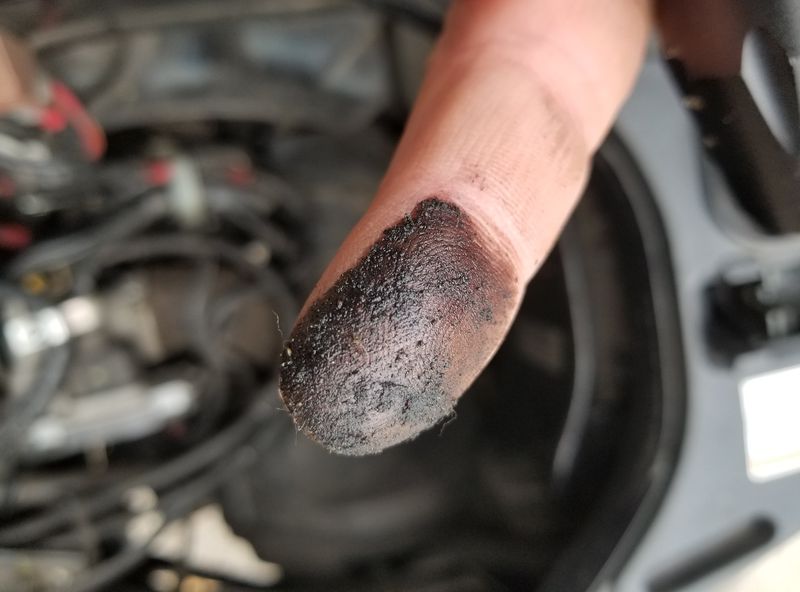

Okay, reporting in. First good news, whatever flattened my rear tire, it's holding air again...and a LOT easier to push around.
I checked the engine from every possible angle, no drips anywhere. Was a bit dirty on top and smeary to the touch, but then I think it may have gotten a bit messy with bleeding the coolant a couple of weeks back.
Started the engine to see if there was anything from the exhaust, but nothing visible at all.
So not sure where that leaves me.... though I guess pushes me towards water pump....
