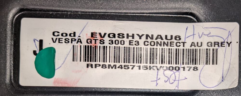

I have a Supertech that I purchased Oct / 2019 in Australia. It's VIN is RP8M45715 with an M45MM engine and CM291706 (32M4G1.F06) ecu. I am confused that nowhere on the internet can I find this engine listed, all the HPE engines are listed as MA36M. What is the difference between the M45MM and the MA36M - why the different number?
edit: my model is EVGSHYNAU6

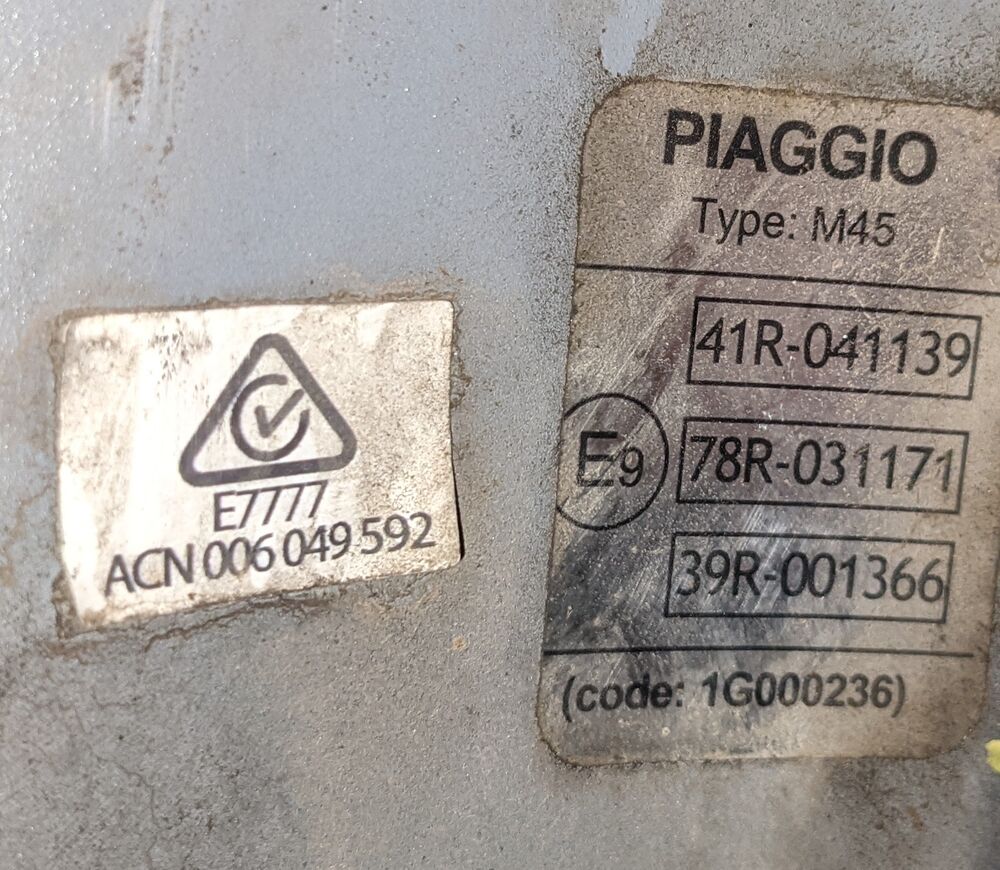

edit: decoding the ECE e-mark sticker on my scoot (photo below)
E9 spain lol
41R-041139 noise
78R-031171 brakes
39R-001366 speedometer and odometer

I entered my VIN into http://static.piaggio.com/recall/form-piaggio_en.html
It said my bike is a VESPA GTS 300 E3 CONNECT AU GREY ' 19
'CONNECT': sounds like an alternative name for Supertech
'AU GREY '19': correct
'GTS 300 E3': sounds like a Euro 3 ... but I have an HPE which is people say is a Euro 4 (or 5)!
Edit: checked my exhaust and it says SM49 VESM450278 which is apparently a Euro 3 exhaust according to German forums? see https://translate.google.com/translate?hl=en&sl=de&u=https://vespaforum.de/viewtopic.php%3Ff%3D16%26t%3D25969%26start%3D15&prev=search&pto=aue

Under the seat attached to the right side bodywork silver (quite shiny) plate that is self adhesive with engine number, paint code and other information about country where it's been built. Just prior to the engine number there was an e6 followed by the engine number. Probably not relevant to the conversation but my 2016 Italian built bike has e3 before the engine number. My bike is actually a euro3 bike though. But thinking this 'e' business might not denote the emissions classification as there is not an e6 or e8 euro classification for bikes yet. I've also seen a 2018 euro4 bike with the 'e3' designation prior to the engine number. Interesting!
first photo attached:
that's not what I was talking about when I said in 2c that there was an E3 under the seat. I'm betting babola was also talking about that silver sticker. mine is E9 on that sticker
second photo attached:
the E3 I was talking about is on a sticker on the underside of the seat itself. it has almost the same text on it as I get when I entered my vin into piaggios website.
EVGSHYNAU6
I think this is what you are talking about
this is what I was talking about
