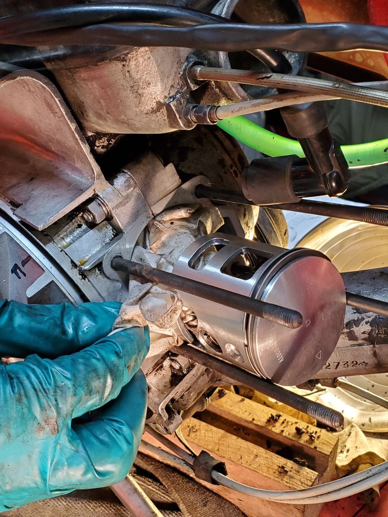

Hey everyone,
Chris and I put a Pinasco 177c two port kit on his 1964 Allstate (Rocket).
All went swimmingly until after about 5 minutes of running it started to make a pinging sound and stopped running. No Bueno....
So we took the cylinder off and the piston was super tight in the conrod. It's like the wristpin froze up.
We ordered a wrist pin removal tool because it was that tight - the piston wouldn't wobble back and forth on the rod.
Upon pulling the pin out there is scoring inside the brass bushing, on the wrist pin, AND also on the outside of the connection to the piston! WTF???
So now we're sitting here scratching our heads....How did this happen? How to rectify the situation? What the hell?
It literally doesn't have 5 minutes on it, and it sounded great when it was running, until it tightened up....
Does anybody have any ideas? How it happened, and where to go from here?
Thank you!

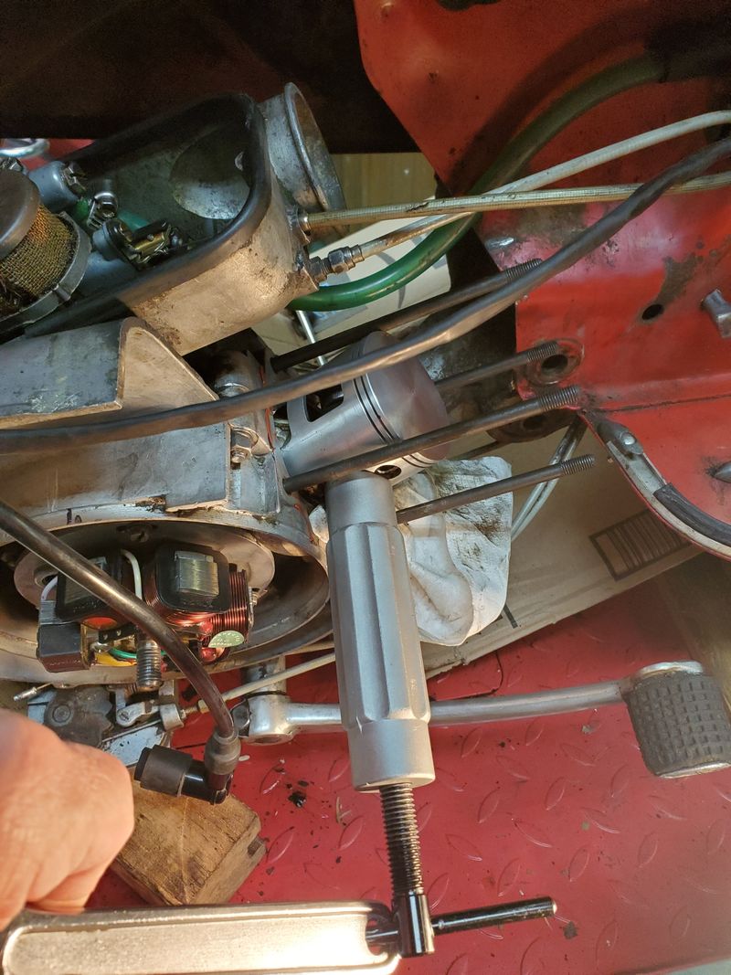

Using the fancy tool on the wrist pin to get it out of there without destroying everything.

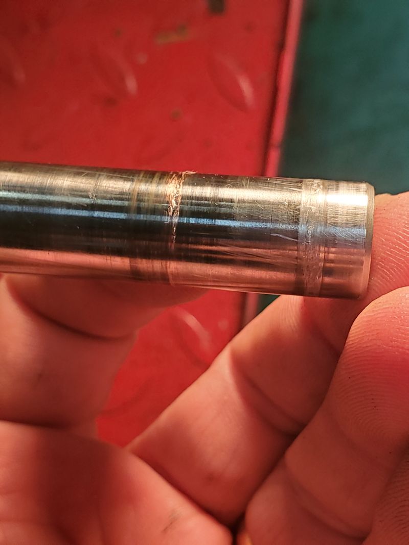

Wrist Pin scoring. The outer scoring is from the outer side of the piston

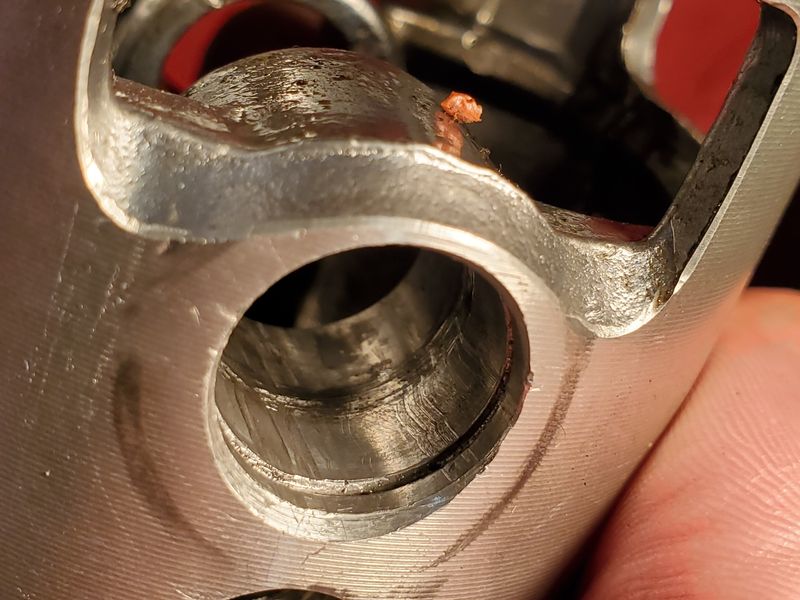

The outer edge of the piston scoring. I've never seen this before. What could cause this and does this mean a new piston and crank?

does that engine/crank/rod use a bronze bushing at the small end or a needle bearing?
Yes
EDIT - A bushing....
⚠️ Last edited by qascooter on UTC; edited 1 time
Posts: 10134
Posts: 10134
Bronze bushing, which would normally be OK, but not this one any more.

How did it happen? lack of lubrication. There is a reason why they went away from the bushing to a needle bearing. Now time to go out and purchase and decent crankshaft.
We squirted 2t oil in the bushing and on the wrist pin. Maybe I needed to put grease? I cannot recall what I lubed up B-62 when installing the kit a few months back. Hmmmm.

Amazing how quick that happened. Properly disappointing. Good news is the 2 port kit has 3 ports.
Pin was just tight. If the bushing was more worn it would have been ok.
That bronze is hard all the way through and not just on the surface. Would it not be worth a try to ream out the bushing to take a needle bearing? What you got to lose? Measure a P crank to get the size. Re-use the damaged piston. It might not last forever but would go more than a while. Would give you time to maybe sort P electrics and big taper too.

How bad is the scoring on the bushing in the crank? could it be sanded down with a bit of emery paper and then re-use the old wrist pin in the new piston, albeit with a bit of side-to-side play between the circlips? (Note: this may be a Bad Idea, but I still had it)
Can you get detailed (.01 mm) measurements of the comparative sizes of the two pins? They should be the same, as I ran that same Pinasco 177 with a bushing in my VBB for some years without issue on the stock crank.

Would the connecting rod be hardened to be able to use a bearing? With a bushing the rod end isn't a wear surface with a bearing it is a wear surface.
Could that mess be cleaned up with some 800 or 1200 grit sand paper and reassembled? Guessing cleaning up that bushing will increase the tolerance a bit to help with the tight fit. Might take a little off the pin also.

the pin can be cleaned up, no problem. but there is really no reason to keep that old crankshaft with the brass bushing. again, there is a reason why they went away from it. for not a lot of money, a state-of-the-art crankshaft with a proper needle bearing can be had.
