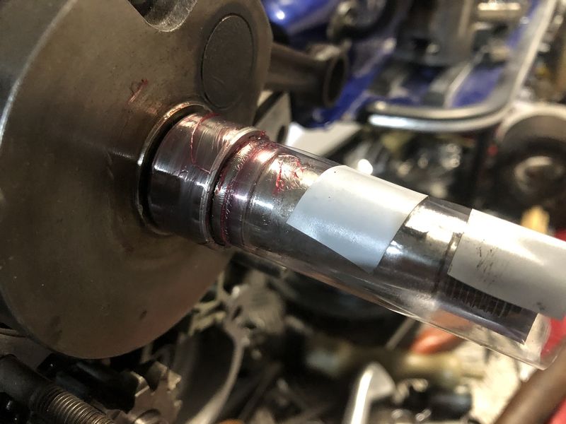

Any tricks other than tape on the crank lip....feckn two seals in a row folded over.....feckn scooters
There is an original tool for flyside seal that you screw onto the taper; Not being reproduced and rare.
Most people will not have this tool. What I recommend is to take a small screwdriver and push the seal a little to get over the berm of the seal surface of the crankshaft.
Same goes for the clutchside. Begin to pull the crankshaft into the case. Back the puller off and make sure the seal is over the berm; use a small screwdriver to push the lip of the seal.

..to clarify
you mean push on the seal (fly side in this case)with screwdriver from inside of the case just before it closes??? hmmmm interesting
No. From the outside. Next engine I build on that platform I will do a video for you.

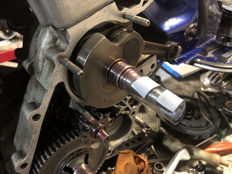

I use transparency film as a guide over the crank's lip. Cheap and easy...

sweetbix
hell yeah thats me..transparancy film..genuius
