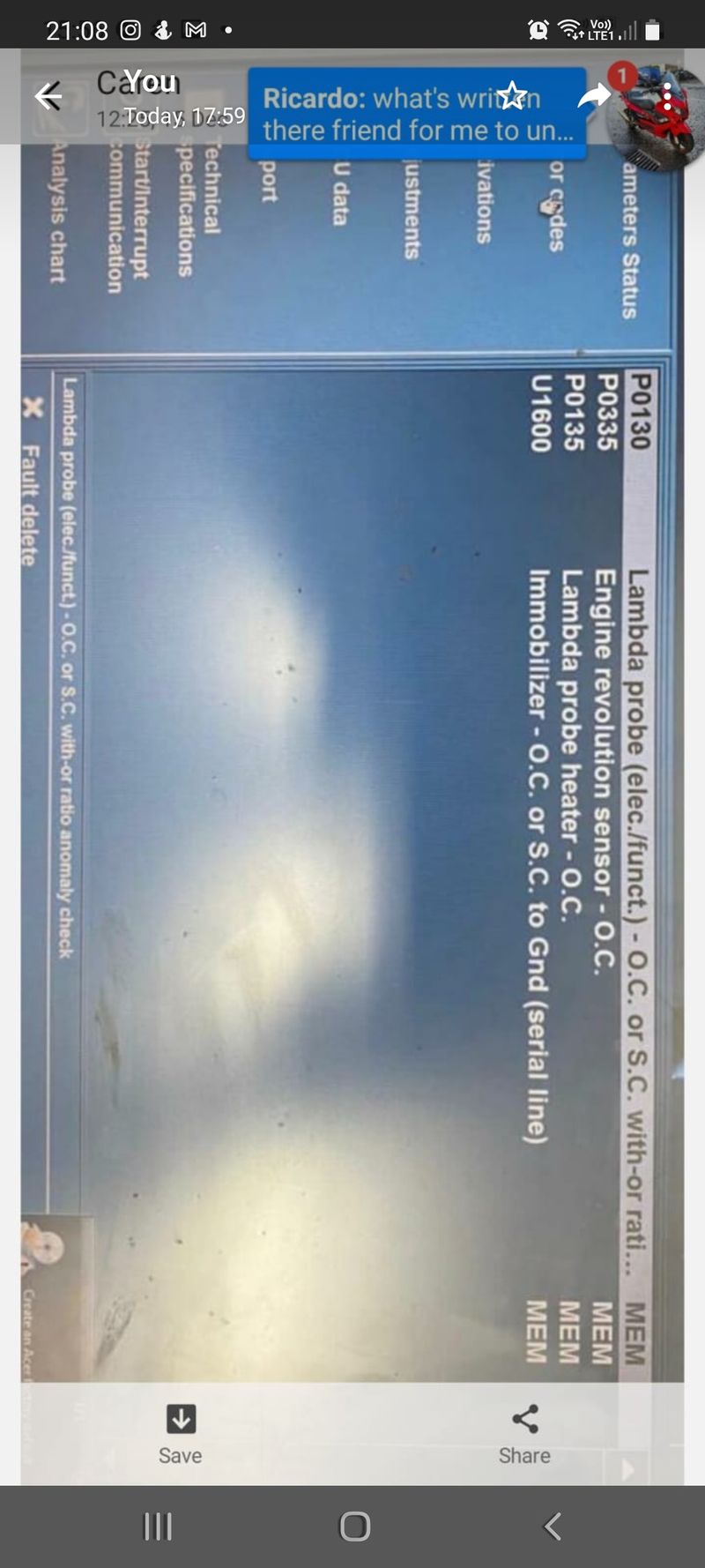

Sorry for the late reply. So I took it to a scooter shop and this is what the diagnostics showed. The shop told me that it could either be the lambda sensor or the throttle body. I found I guy braking a nexus 250ie so I bought the throttle body with both keys and the ignition setup. The problem is the same. I have a lambda sensor coming tomorrow if it doesn't work I don't know what to do next.
PO130
P0335
P0135
U1600
