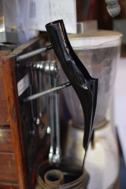

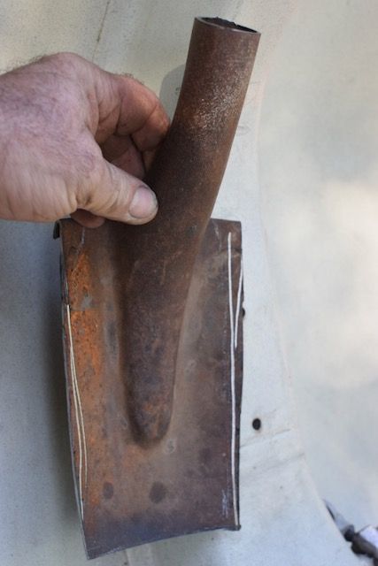

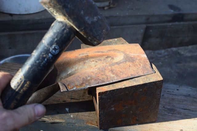

I just made a spare tire holder for my gs 150 , using an old shovel head. Check it out:

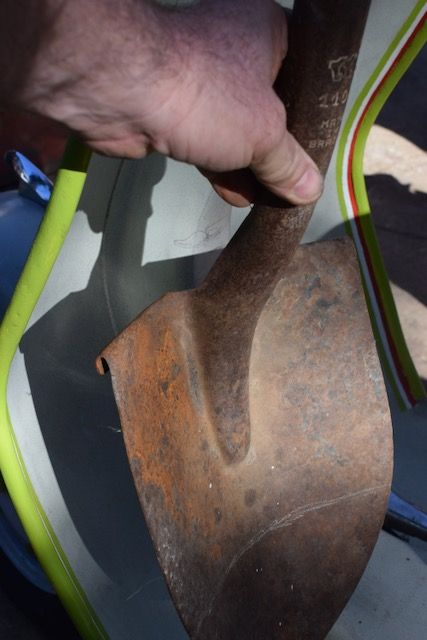

This was an accidental discovery I made while attempting to design a bracket to weld together from scrap materials. The angle of a shovel head I had sitting around awaiting a new handle, was just about perfect for making a spare holder, after a series of judicious hammer whacks to straighten it out a bit.
rusty shovel next to frame.

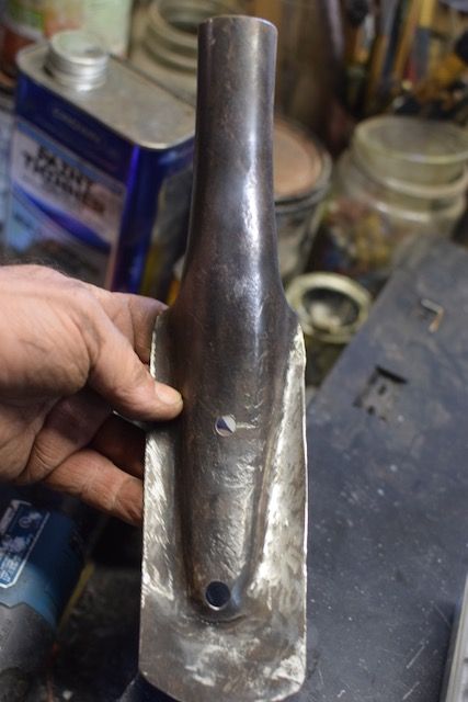

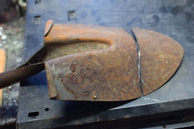

chop off end.
chop off end.
chop off edges, shorten handle, and check for fit.

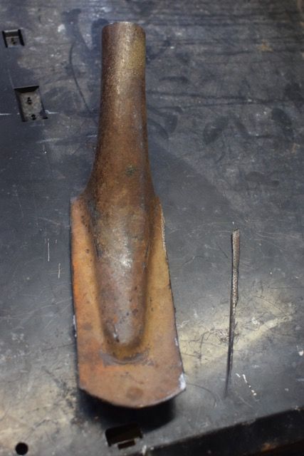

cut some more off for a good fit.

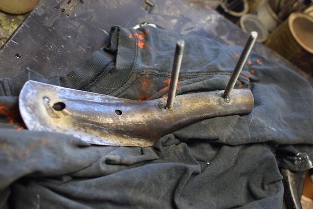

drill holes, wire brush off rust.

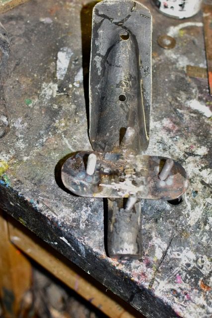

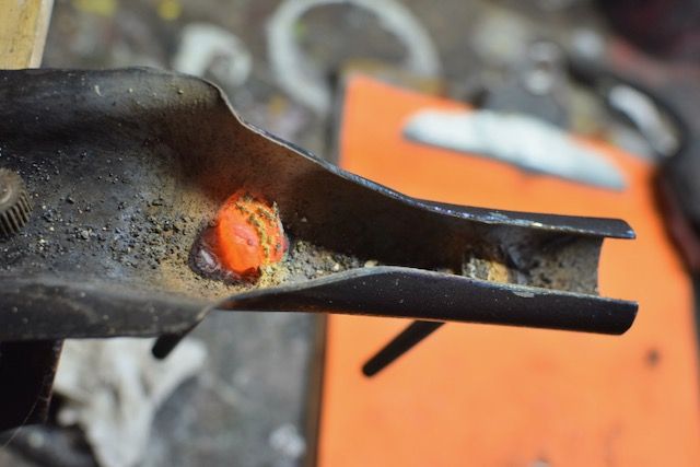

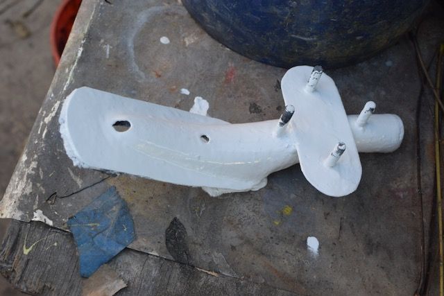

weld on studs (and repair old stress crack)
paint with Krylon rust proof flat black.

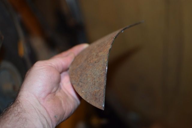

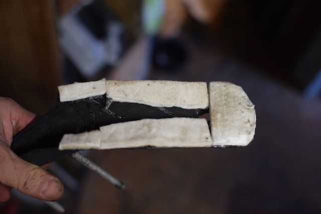

add some recycled felt to the back, to protect bike's paint job.  rubber would probably be better though.

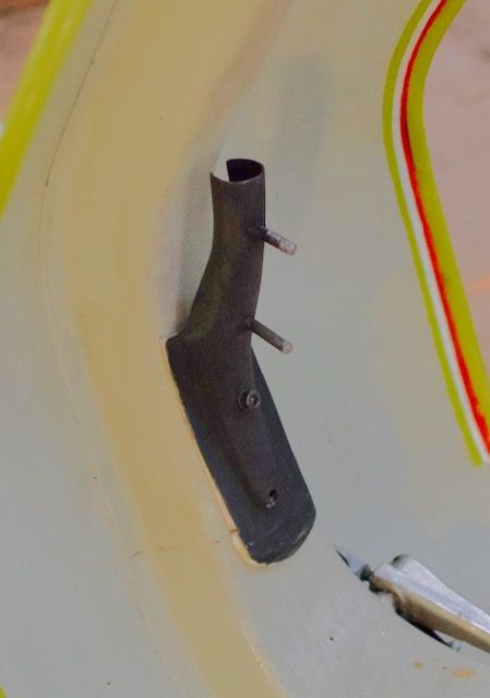

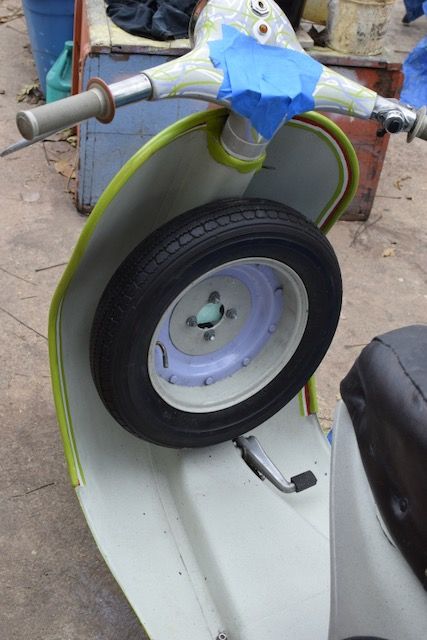

attach to bike, install spare and Voila!

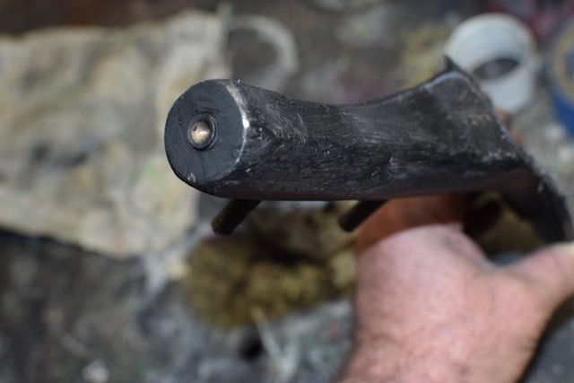

I cut out the back handle area, drilled holes for studs, and welded bolt heads down.
I used allen head bolts to attach it.  The bottom one should be flatter so it doesn't dig into tire later. Unfortunately I cut the studs too tight, which made installing the tire a bit of a pain.

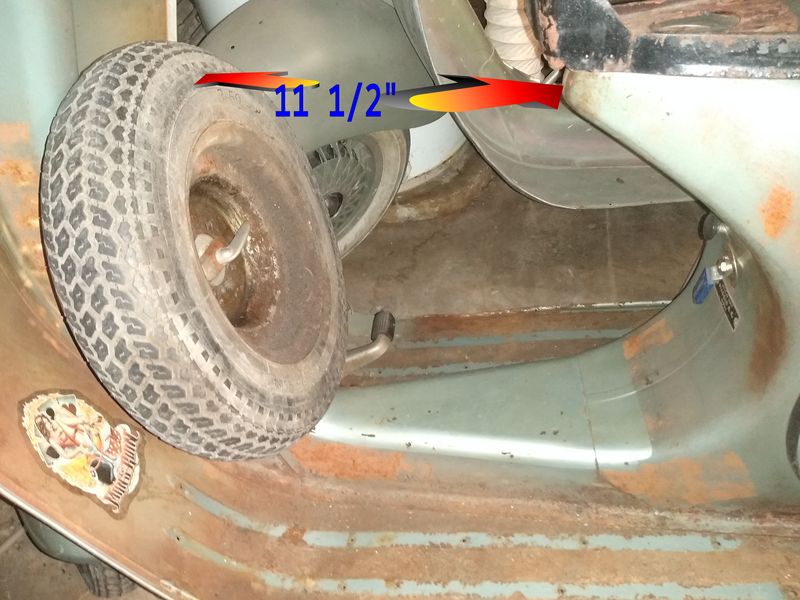

Clap emoticon I LOVE it, this is my kinda jam! Very clever use what you got solution.

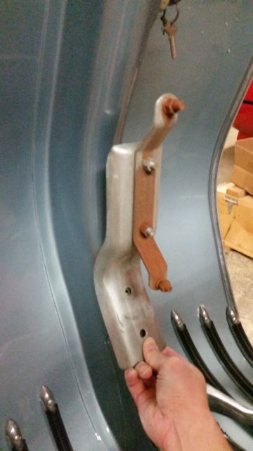

One question tho, how is clearance to your knees? Could you could use some tube standoffs and turn your wheel around facing the other way to get it closer to the legshield if needed?
This old spare bracket was made for 8" wheels. It holds the wheel w/ tire fairly tight to frame.
if you have long legs, and the gap here is a lot less than 11 1/2 inches, you may be able to move it in some.

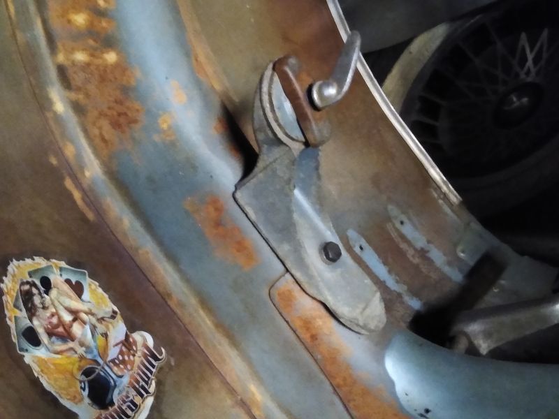

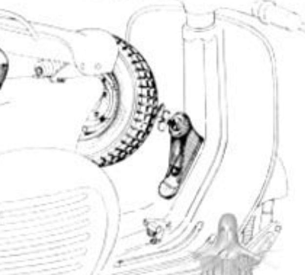

I had been wanting a front mounted spare but have not found the right mount for my VBA. According to the owner's manual, it's a center mount like Voodoo's holder. I'm not sure where I got it, but I had this other one in my parts bin and I just don't like the size of it so I'm not going to use it.

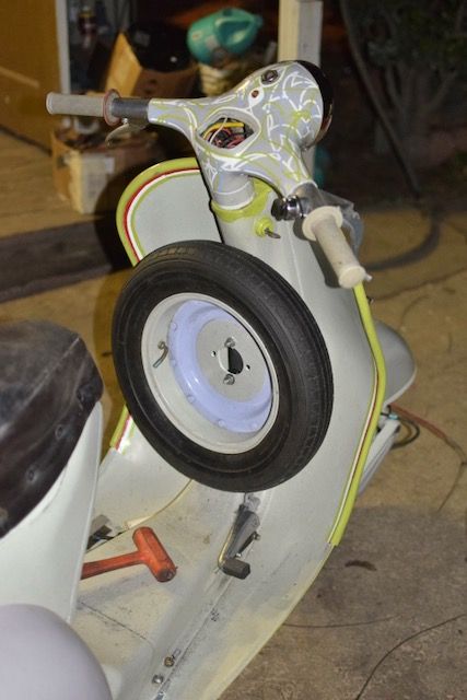

Thanks for the replies. The tire tightens up quite well and provides enough leg room I think. It actually tightens the rubber to the frame, which I don't see as any problem to the tire wall, which acts as a bumper of sorts and doesn't harm the paint job. I just finished closing in the handle area by welding on a piece of extra metal, as well as on top, so no water gets in there, and I also added a cross brace, to bolt the tire on more solidly.
I don't know if it was necessary but what the heck.
maybe a bit of over engineering:
closed off leak areas.
I used some leftover body paint here, without spraying.

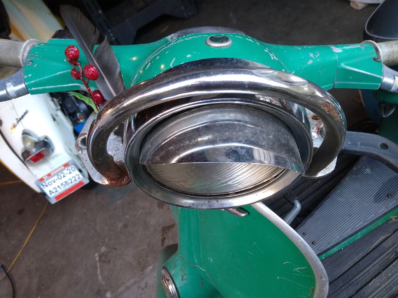

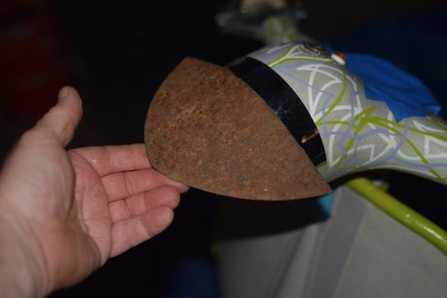

The tip of that shovel is a great shape for a headlight visor, but it's too big for the vespa I think. It would work great on a motorcycle.
Maybe I could find a smaller shovel for this. Or not.
Posts: 10137
Posts: 10137
Well that's about perfect then! No annoying vibrations to deal with then either, if you got it snugged down good.
And just snip off about half of that huge shovel tip, find a log or something about the size of your headlite, bust out your torch then heat good and form on that log, so go ahead - have at your visor plan. WCGW?
cut it down about this size maybe, makes lite a little brighter and adds maybe a mile or two top end as well as a lot of class ;)

okay here it is now:
nice and solid.
