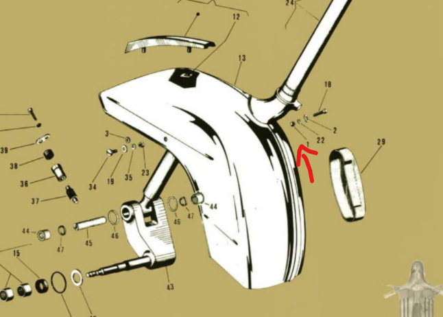

I need to replace the nut that secures the front fender to the fork on my P200 - does anyone know the metric size for this thing? Ace hardware doesn't have anything that fits the screw that shows on the outside of the fender. I just need the nut...my bodgey use of a license plate screw and nut looks like shit.

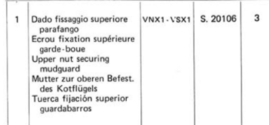

Believe it is part# S.20106.. which I think is this part:
https://www.sip-scootershop.com/en/product/nut-m6-mm-brake-arm-front_20106000?q=20106
and is an M6 nut.

It's an M5. It's actually n.23 in the diagram...
