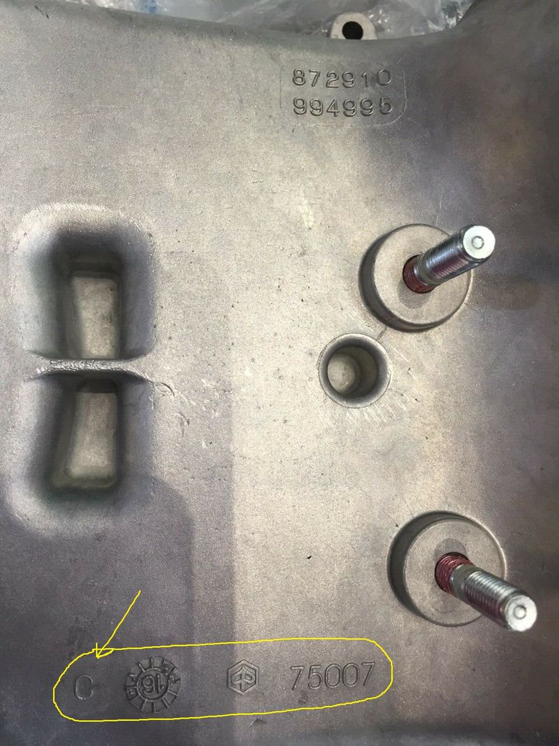

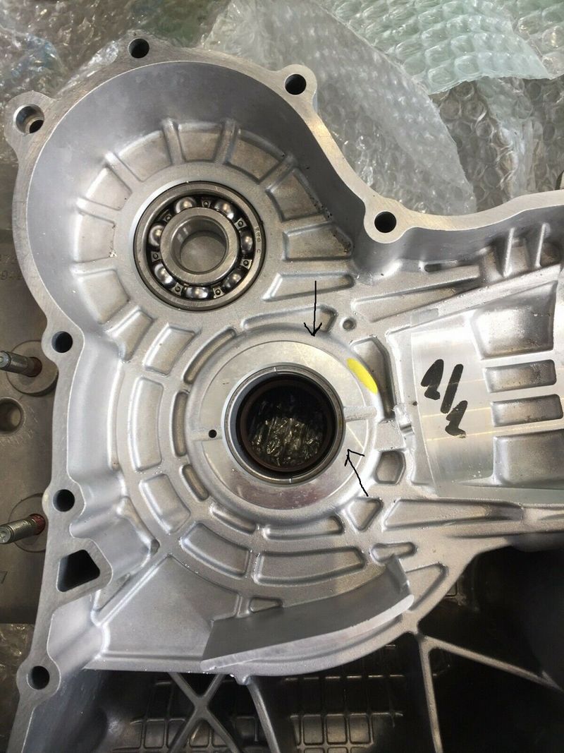

Hello everyone, I bought a new engine and I can't figure out which crankshaft category I need to use. Motor marking C and yellow inserts

There should be yellow markings on each half A or B. Also the OEM code will tell you the type...
