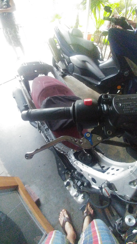

since this topic is still going ...
I bought the 'long silver' levers from this aliexpress listing https://www.aliexpress.com/item/32961692737.html?spm=a2g0o.productlist.0.0.6fa25accQvxSKY&algo_pvid=7b0fa0d4-9086-43d0-a036-ebccb66aa983&algo_expid=7b0fa0d4-9086-43d0-a036-ebccb66aa983-3&btsid=d3fc84d0-e7c8-4eec-a165-d4d5663511fd&ws_ab_test=searchweb0_0,searchweb201602_3,searchweb201603_52 and they are perfect. I had them installed on my 2009 gts300 and then transfered them to my 2019 supertech. had them for aroun d 18months so far
note: some of the photos on that page are showing the wrong levers (for different bikes)
I am fairly certain those are the same levers everyone else is selling that look like that.
I sent off my last set of short levers for trial, in a GTS, so hopefully I will know within a week or so if they work. I do have some black levers for one of the Aprilia models that are shorter but I didn't think to compare them to the Vespa ones. I still have a short brake lever for a cable brake, like on an LX.
