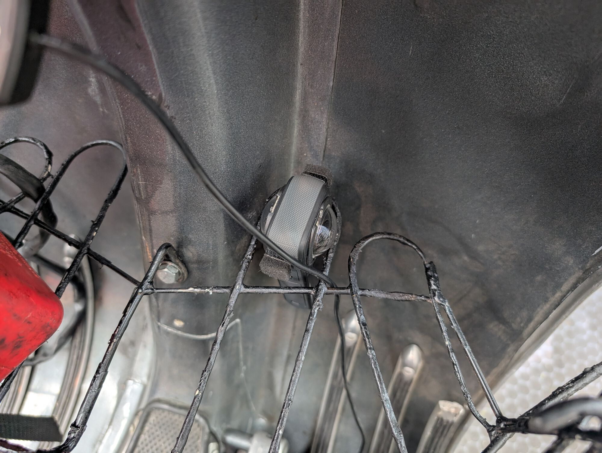

Sadly, the 360 camera decided to misbehave and only record intermittently and out the rear lens, so no video tonight, but I will say this thing is killer.

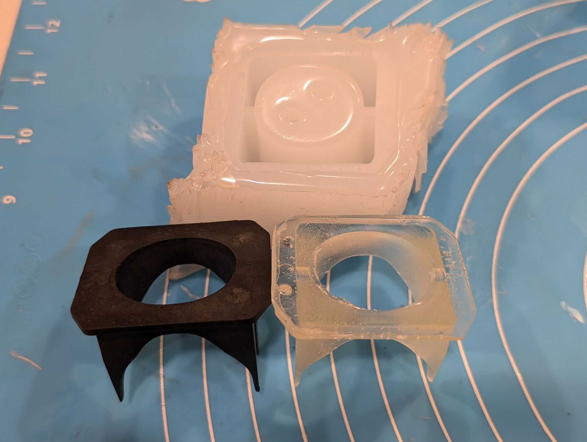

Among other still-pending enhancements, I decided that I wanted to make a 34mm stuffer while still keeping the OG 30mm that came with the reed for some reason.
So made a latex mold from the original, then cast a copy in resin, which I can now open up to 34mm.

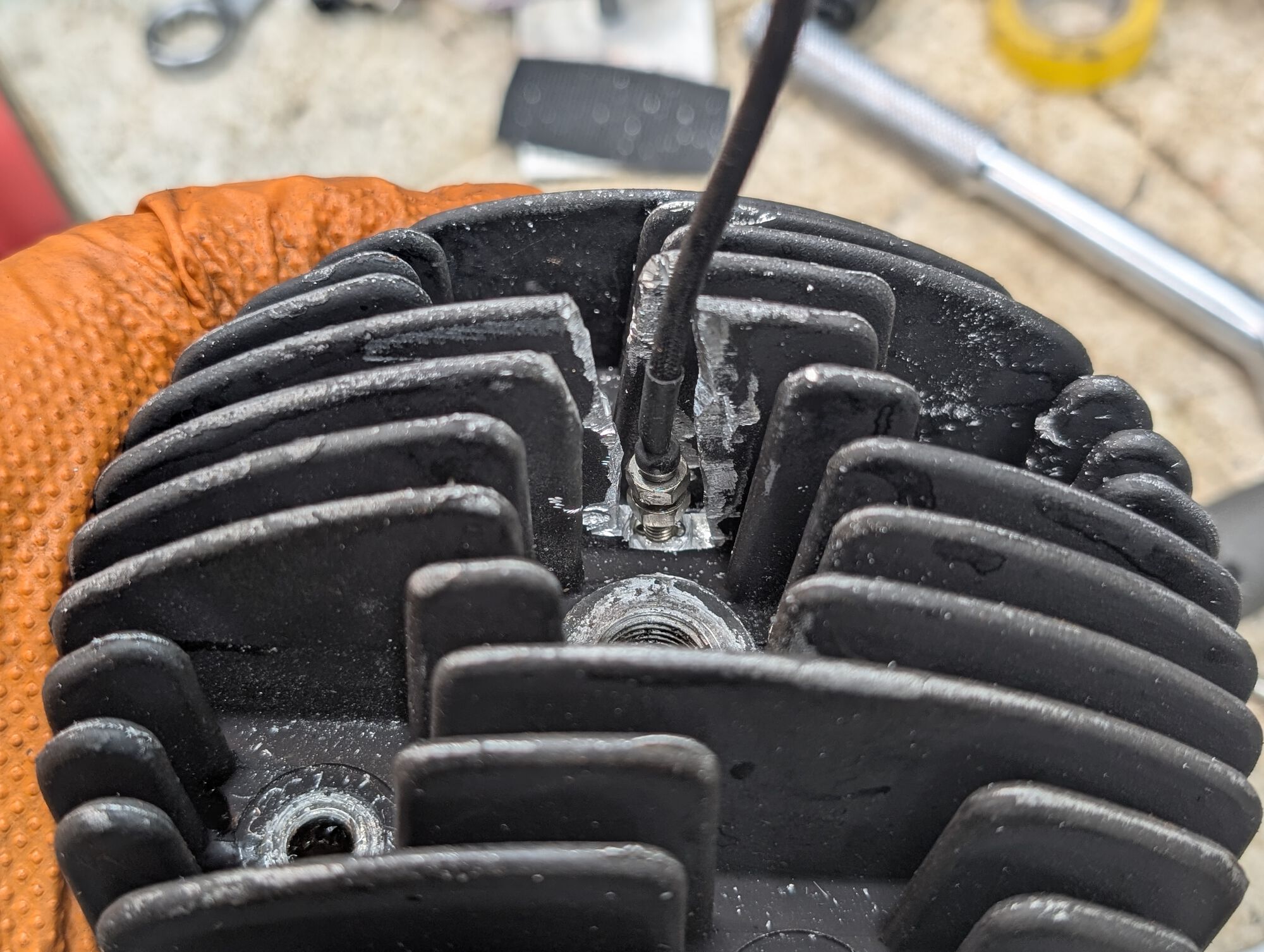

I got the CHT, AFR and EGT installed last night. Despite careful measuring, I still managed to kind've screw up bung placement on the AFR and EGT installs. Facepalm emoticon
There's a tiny bit of interference between the AFR and the center stand, and the EGT and floorboard.
The CHT required cutting a slice out of one of the fins on the head to fit the under-plug sensor, but that actually went pretty smoothly once I accepted the inevitable. Still a lot of work, but whatev's. It's in there.
As to the AFR, it has a tiny bit of interference with the centerstand, but I think I can bend my way around that, along with the fact it's temporary. The EGT, I think I'm going to have to cut and relocate. Doh.
Since it's supposed to be pouring rain starting this afternoon, I might have nothing but time for that later.

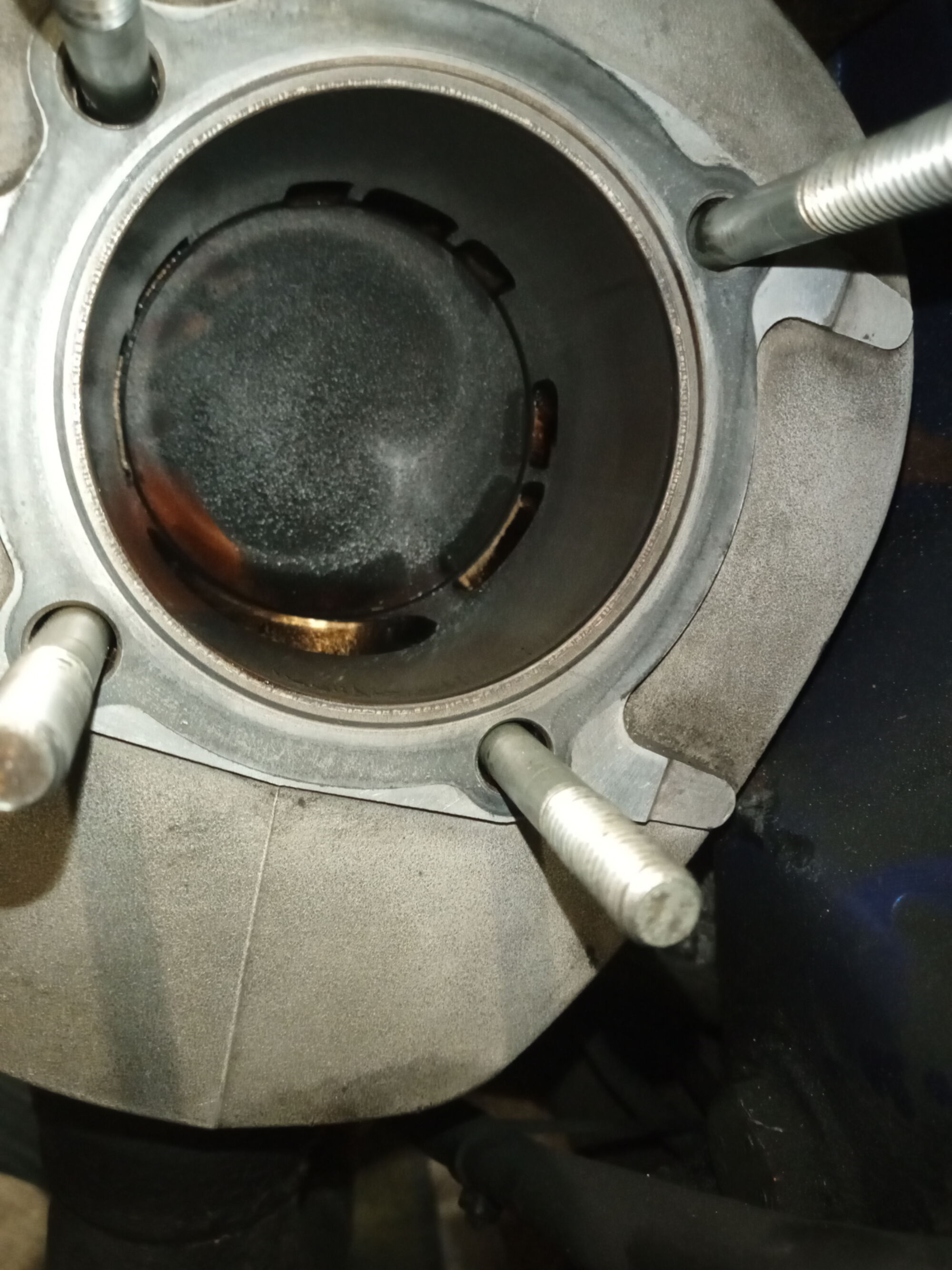

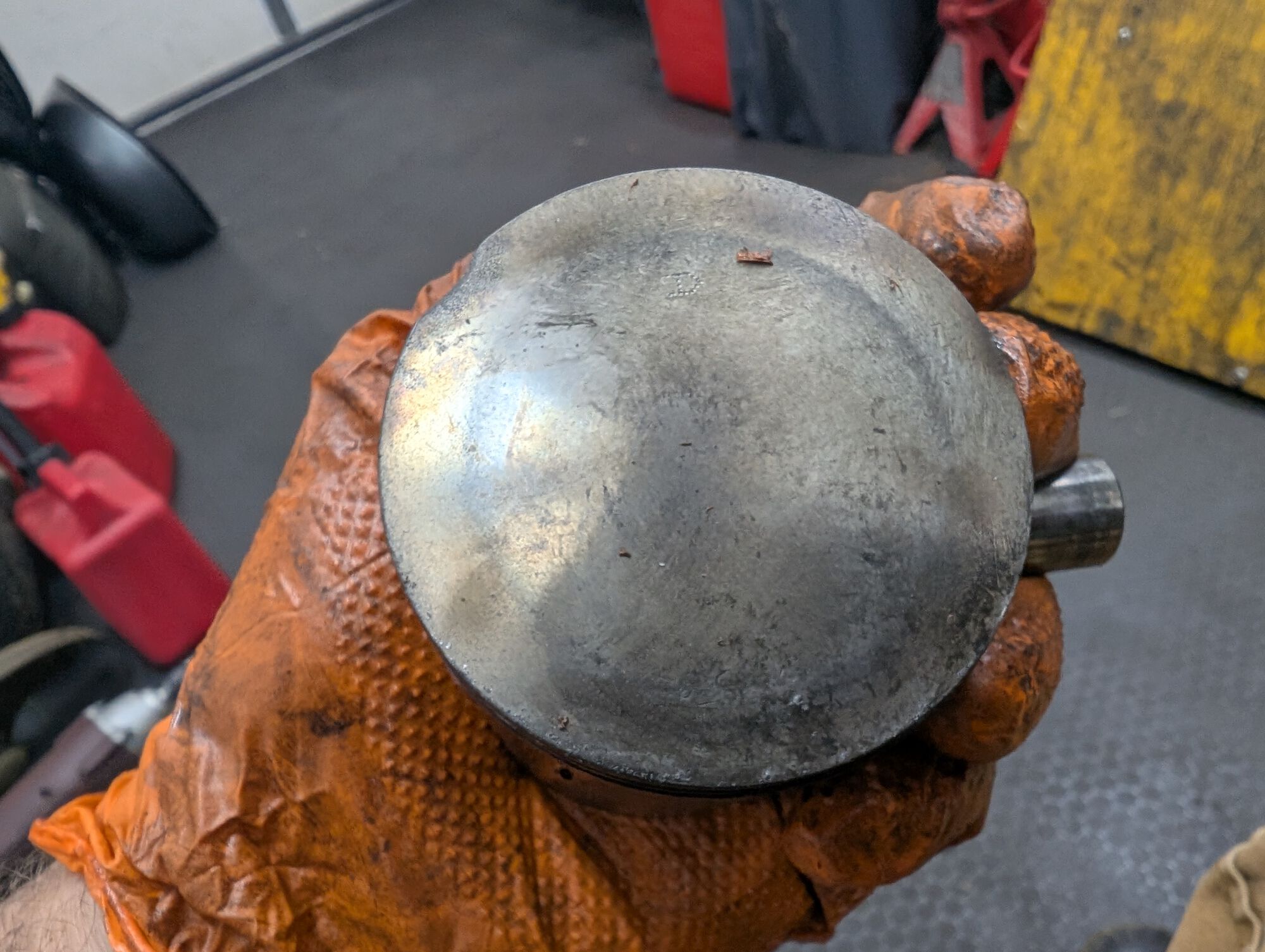

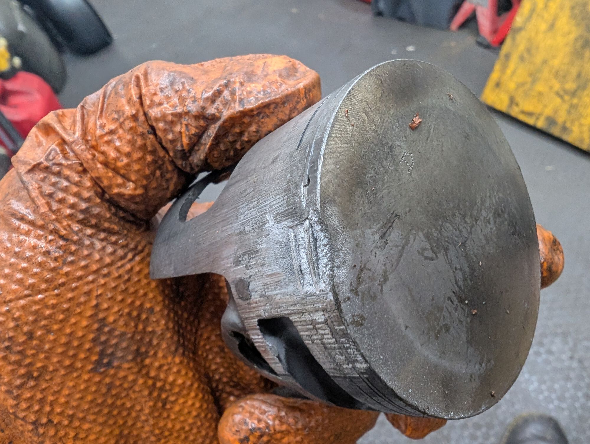

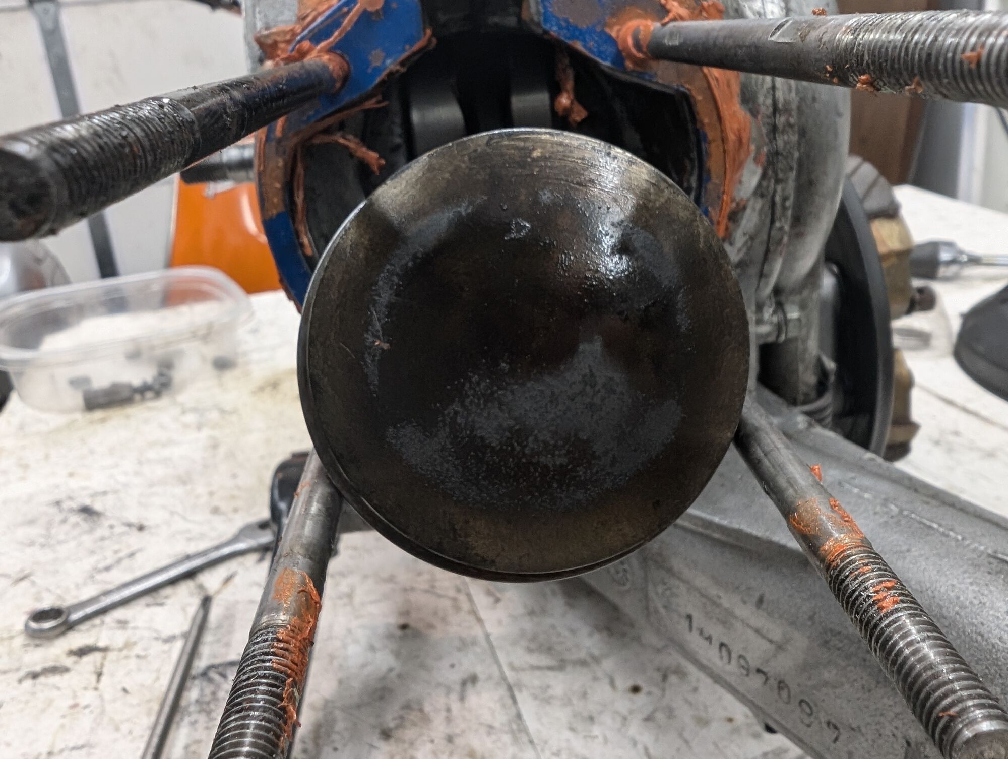

So something is not right with the new motor, but the good news (I guess) is that I don't think it's the top end. The first thing that happened was that the reed block mounting bolts started coming loose, which caused it to basically be air-leaky.
At the same time, I went to start it and it squeaked when I kicked it over, like maybe a seal was rubbing on something.
So I fixed that, but now it wants to die at idle and seems like something is dragging the motor to a stop. This happens in neutral as well as coasting with the clutch in while moving, so it's not in the gearbox. It also pushes without issue when the motor is not running.
I pulled the flywheel and looked at the fly side seal and it looks fine, which takes me to the clutch side seal. I forgot to test if the clutch breather is pulsing when the motor is running, so I'll do that next, but as it currently stands, I'm probably going to have to open it up to figure out what's going on.
At this point, I'm thinking it might be time to bite the bullet and pull the trigger on some new cases. I can get LML cases from SIP for under $500. I just don't know that I can justify a thousand bucks for the Malossi cases. I'm sure they're nice, but the LML cases will work just fine, especially since I'm not going to be porting them for this build.
I've got the cart loaded up at SIP, just working through the Seven Stages of SIP before I pull the trigger.
Anyways, that's what's up. Meh.

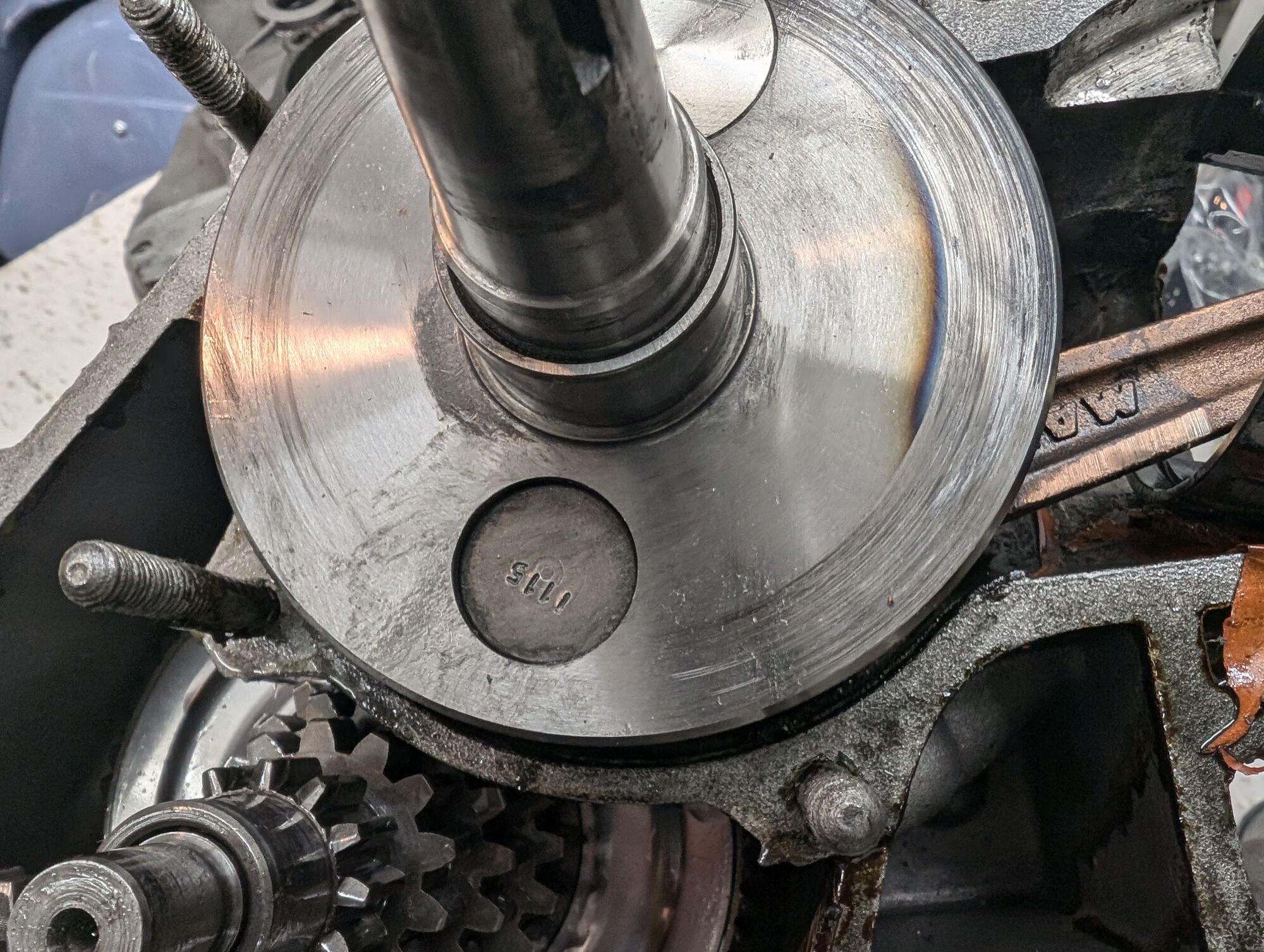

And here's the mystery squeak.
Crank rubbing on a seal?

Just poking around this build and wanted to respond to orwell84's question regarding crank rebuilding. A 20T press is more than enough. All cranks I rebuilt required about 5T force (as observed on the press dial gauge).
Vespa crank webs, at the pin hole, are narrow (say half of that you'd see on comparable Jap two stroke cranks) so there is very little force required. The narrow webs also are problematic because it's very easy for the pin to go in slightly crooked. The press assembly has to be straight for this reason and cheap assemblies are anything but. So the hardest part of the rebuild is truing the webs after the assembly. Part of the challenge is because you are limited where you can hit the webs. I have found, also, that vespa cranks are very soft so lead hammers are best. Even copper can dent these crank webs. The second part of the challenge is that these thin crank webs move around too easily and will go back to out of true overnight! I'm going to make an assembly jig that will align webs during pressing to make truing simpler endeavour. But since vespa cranks have two different diameter webs even this seemingly simple job is complicated!

Sorry to hear You are having issues with your new build. That squeak is definitely odd… almost like a whistle, as if its sucking air through a tiny hole.
For cases I understand the dilemma. Those Malossi cases are fantasmic! But yeah…double the cost of the LML. Worth it IMHO, but if the juice cant be squeezed, then the cost effective option will be okilydokily.

PMF, thanks for the insights on crank rebuilds. Definitely validates my decision not to mess around with one
I hadn't thought about a whistle. Maybe it was whistling at the reed base where it was loose, because it's no longer doing it. That doesn't explain why the motor seems to be dragging.
I guess I need to get off my ass and go take a look at it.

I tore down the GL motor tonight and it wasn't good. I'm glad new cases are on the way.
The top end was just fine. It had a head leak, which surprised me a little since it's an inset head, but zero issues with the cylinder, head, or piston.
The crank, though, had started to work loose at the webs and was running the cheek of the case. It's a good thing I quit when I did with it, though. Now I need to find a shop than can press it the couple millimeters back into place for me. Shouldn't be too hard, just annoying.
New cases arrive tomorrow, so I'll have to play hookie from work at some point if I can get the crank pressed somewhere quick tomorrow during the day.
