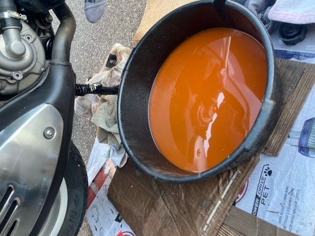

Progress and two questions:
Oil/filter, hub oil, brake fluid all changed. Coolant drained. Removed old gas and replaced with fresh, new gas. Questions:
1. I flushed the old gas from the lines by removing the gas line at the injector and purging with the new gas in the tank. Now that "clean" gas is running through the lines, do I need to do something with the injector itself?
2. The coolant in the engine was a nasty orange (rusty?) mess - see photo. The stuff that came out after the engine coolant (from the reservoir and the lines) was a lovely pink. Given that the bike has been sitting, it makes sense that the engine coolant was terrible, and the rest okay. So, should I just refill with new coolant at this point? Or is there further need to flush with distilled water before refilling?
Thanks again!

If you lived in NYC I would say just use tap water, that not being the case, get a few gallons of distilled water, run it through the engine & flush it out. That should be enough and then put the new coolant. You will have to remove the air bubbles and run the engine to get it to temp & get the fan to go, then you shall be good will generally take about 20 mins but it is not summer time so may take a bit longer to get the engine temps up.
There are a couple of videos on youtube, MicBergsma has one and RObot at Scooterwest has one, both will give you excellent steps to follow and complete the task at hand.
Posts: 3766
Location: East Anglia, UK
Posts: 3766
As baba says, just do a quick flush. You won't need to do much, just use some distilled water (2 litres). Put the water pump cover back on with the screws tightened very very lightly. Fill with distilled water using the bleed screw on the thermostat housing to bleed out most of the air. You don't need to spend much time doing that as you only want the water to be circulating in the engine for 30 to 40 seconds or so with the motor running at fast idle. So if there is a small air bubble or two it won't matter. Just don't let the engine get hot. Then let the system drain out again. It should be fairly clean, if not just do the flush one more time and repeat the engine running and bleeding operation before letting it drain again. You won't need to do anymore than that. Before you refill I'd make sure to tip the scooter carefully on the main stand, towards you (standing on the water pump side of the bike) so that when you have the water pump cover still off the engine, any remaining water in the engine comes out of the hoses connected to the water pump cover. Then just put everything back with the new water pump cover gasket and refill with new coolant.
It does just go to show how rusty the engine coolant goes after just 3 years of standing. The old coolant has been working all the time to fight corrosion and used up all it's chemicals fighting that corrosion and has now become very acidic. You've caught it all just in time before any damage is done so that's great. Looks to me like you are doing a great job Schuman and it's a great lesson for everyone, letting them see just how important regular coolant changes are.

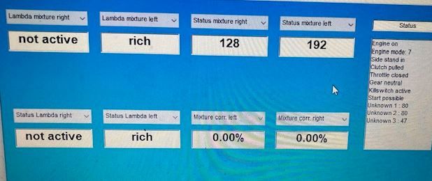

Coolant was was flushed and refilled properly; brought it up to temp and the fan came on. The Vespa starts and runs well - I more than quadrupled the mileage today. It has 14 miles on the odometer now! Two issues:
1. Clutch chatter (maybe)... Is that typical for a brand new Vespa? I didn't go into the transmission at all.
2. The Check Engine light is ON which is making me crazy. I hope it's related to the evap canister or something. Other thoughts?
Thanks again!

Hi schuman, ok so that's great so far. Did the engine check light suddenly just come on while riding or has it always been on?
You should not need to do anything to the injector. If the bike is running ok without misfiring just leave the inject alone.
The engine check light is most likely just an anomaly due to some corrosion on the Lambda tip. This may just be from debris inside the engine and/or in the exhaust downpipe which has stuck on the sensor. Remember the engine has been sitting a long time and the cylinder bore will have had some light surface corrosion on it which has to go somewhere. Some of it goes in the oil but some goes out the exhaust and it can cause issues with lambdas. It will clear. However, I'd check the wiring is intact to the lambda and look for any obvious issues such as air leaks. Make sure the air filter and it's housing is sealed ok and the throttle body boot is not split and is fitted ok. It's strange what happens to bikes that are left standing for over 3 years. Once you have done that it may be worth disconnecting the battery for at least 31mins to allow the ecu to reset, then hook it back up and see what happens.

I decided to connect my homemade PADS system and check the error codes with IAWdiag. The stored codes were:
P0130: to low
P1607: invalid signal
There were no new codes - just those two stored ones.
Decided to check Lambba functions - see picture. Does this indicate a possible issue with the right Lambda sensor? Or is it perfectly normal, at idle, for the right Lambda to be reading "Not Active" while the left Lambda reads "Rich"?

Schuman have you tried swapping the Lambda probe out of your 2015 GTS to see if the O2 probe is the cause of the EML coming on?

No - but that's a great idea! Unfortunately, from what I've read, Piaggio changed the lambda from 2015 to 2018. I believe in 2018 the lambda went to a 4-prong (from a 2-prong in 2015). Also, there are multiple lambdas, correct? One in the exhaust and another in the engine? Which one is the "right" one that appears to be "not active"?
I'm guessing that the IAWdiag app is made for dual exhausts with a lambda sensor in each pipe, and a scooter has only one.

[quote="JKJ-FZ6"]
I didn't realize there was but one Lambda/O2 sensor on the GTS 300. I figured perhaps there were two sensors, like on my cars. In any event, clearing the codes in IAWdiag and disconnecting the battery overnight had no impact on the Engine Management Light - the light remains on full-time. I'm going to go for another slowish, stop-and-go "break-in" ride today. I have many of those planned until the 600 mile service (at a dealer). I'll report back if a lower fuel level results in the light turning off. Thanks again everyone.
