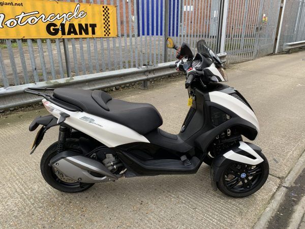

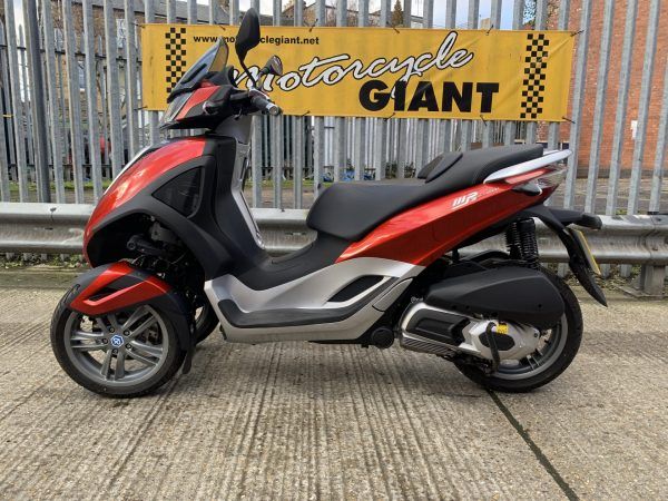

Just to be clear -- see attached pics my bike's tail looks like the red one
Unlike the white one, it doesnt have that tubular frame at the back[/img]

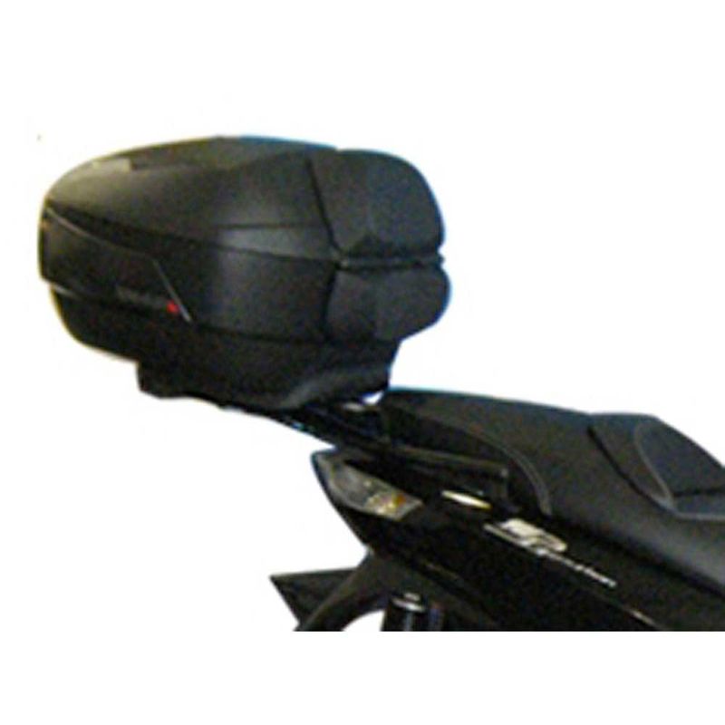

Here is the SHAD fitment kit from SHAD for their cases (fits Yourban 125/300 a.k.a. MP3 300 HPE only)
https://www.amazon.com/Trunk-supports-anchors-settings-Master/dp/B00G5PDPMY
