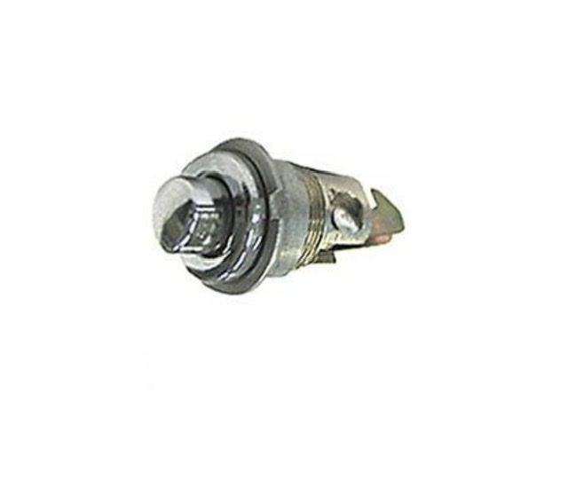

Yeah, latch can be an option. Better yet, keep the original latch - it'll mean more door sales.

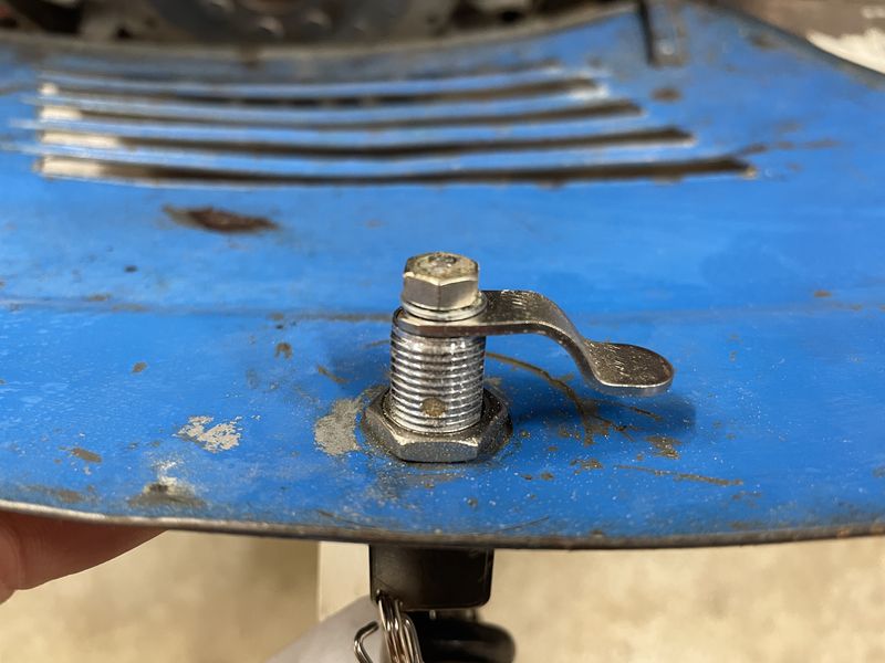

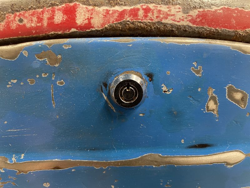

I recommend a locking latch, like this one I got from McMastercarr-
Slightly larger than the original latch. Mounting hole must be enlarged.  Available with a regular key, or this security key. This lock is smaller than the ones sold by the scooter shops.
I bent the latch so that it would engage the original detent in the frame. It was a little tricky to get it just right, thankfully the lock came with a spare latch plate ;)
