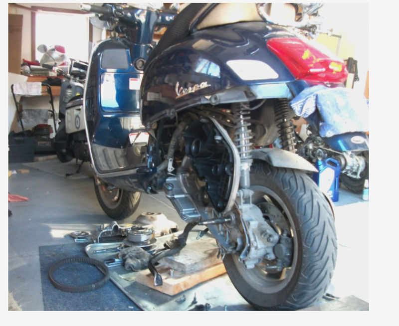

I second the vote on Caltric fuel pumps. Excellent product, with great customer service. Double up scrap 2X12s under your center stand. Use another scrap 2x6 under the rear wheel. Undo the top shock nuts, and use the 2x6 under the rear tire to drop the whole assembly. Be careful of your coil wire why you are doing this. You should undo the plug wire first. You don't need a jack.

Abner - - - I don't think I understand the purpose of the 2x6 under the rear wheel. Do I place this directly under the rear wheel to lift the wheel up? Is this for balance? Won't this reduce how far the engine drops? Or, are you saying that reducing how far the engine drops facilitates removal and installation of the fuel tank? I ask because I didn't see this mentioned by Robot or CheekyThomas.

Use the board under the rear wheel as a fulcrum to raise the rear end. Spin the wheel as you feed the board under it. Lift at the end of the board to raise the rear end back into place. You don't really need it there to drop the engine, but it will stop if from falling suddenly.

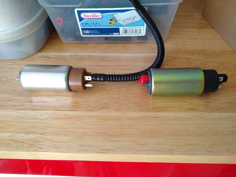

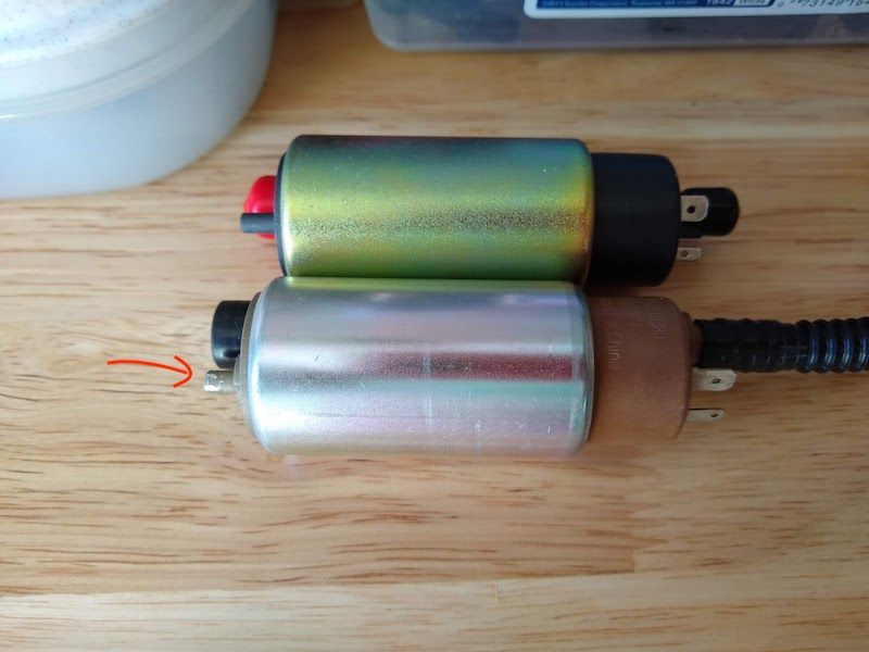

Two machine screws and a retaining washer. You'll have a harder time removing the fuel tube than you will with anything else. I got fed up, gave up, and used a short length of fuel hose and a pair of hose clamps.
OEM with the hose, Caltric without. Arrow points to post for star washer.
