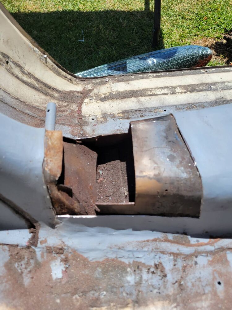

Some updates- Welder gave me marching orders, should be welding next weekend. Here are some pics- I am debating leaving the bottom of the tunnel sides and just shaping them instead of removing... Otherwise should be straightforward. Greasy has a tunnel for me so I *think* we are looking good for a June bodywork finish. (including assembly/fit and finish, then unassemble and paint)
Let me know if I need to pay attention to anything re the tunnel as I prep it for welding. would it be worth it to cut out the bottom and clean/grind the welds afterwards, or should I just leave them? I plan on pouring rust prevention in the tunnel afterwards to prevent future rust potential as well. I plan on keeping this until my kids inherit it and sell it for a hovering craft. OH- I DID wash it, before the welding I'll hit it again to clear out any dirt/grime left. |

ALL READY FOR WELDING!
Going to the welder tomorrow- I think I did an OK job on the cutting/fitting for my first time out, there are more gaps than I would have liked, but it will help with rigidity I suppose. The horncast (located in New Zealand NOS) should arrive in the next couple days, was released from Shipping jail today. Once the tunnel is in, I can start working on the body work in earnest, the tail bottom is really giving me heartburn. Whats the best way to replace the trashed bottom? I figure by mid- June I will be ready to paint her. Once it is painter, I wil just nee a few bits and bobs and I'll be able to ride, but I am still seeking a motor.... SOMEONE is holding and willing to part with one, where are youuuuuuuuuu? Pics for update. |

Mr Snyder ROCKIN-OUT on this SS! Great work so far! Patch panel looks good. Pro-welder guy can fill in the gaps. Its truly inspiring to see the passion and work you're putting in already. Keep it up!!

Oh wow , didn't see the tunnel going down this path. If you were in my city I would weld that up for you lickety split, you did all the work getting the hump to fit for the welding. You know now that the hump is open it might now be a bad idea to fish something through from the steering top down through and out the back of the tunnel for later fishing.

Once it's all welded, fishing wires through ain't no big deal.
That lower horn cast has a nice distinct pressing, nothing like the reproduction sh#t offered from various big box scooter houses. The upper looks a bit suspect but acceptable, I guess. |

Looking GOOD so far, now just a talented welder w/ good equipment! You've done your part with the best pieces you could patiently find and going deep to do it right.
In this pic, the word 'seam' means to weld it flush? Then the lower piece spot welded or tacked on top? And what about these? I've never used them, but would try them if I was trying to do what you are. I HAVE seen them used on a TV car show and was impressed! |

I am pretty, pretty, pretty happy.
There will need to be some slight tweaking to make it perfect-ish, but overall it came out very well I think. BEFORE

looks like a whole new frame! practically Nice work. Impressed for sure. Little buff, little grind and It'll be good to go

Yep, this is just the scoot I needed.
Here are some updates after a few hours of grinding, sanding and a touch of primer. Next is the fine tuning part. |
