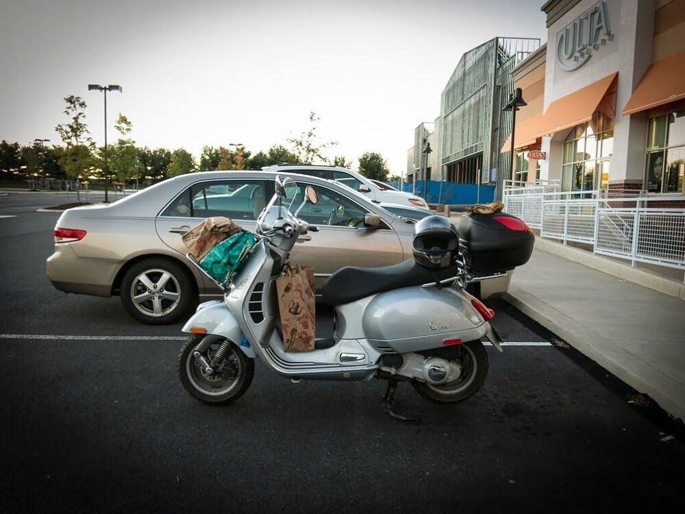

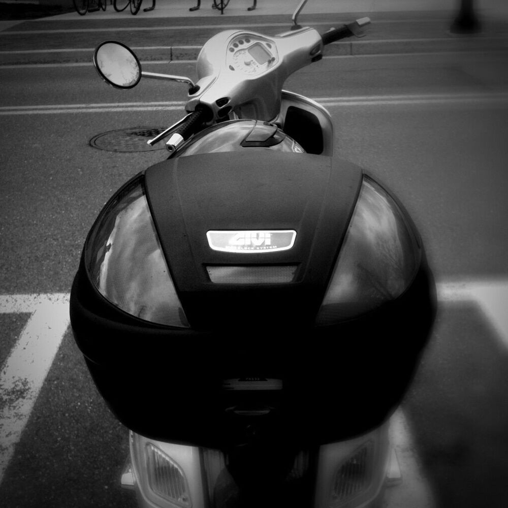

I have a GIVI E370 mounted on my GTS250. The rear Vespa rack is folded down and the GIVI plate attached to that. The topcase clips on and off easily.
It has a holding capacity of 39 liters big enough for my fullface helmet, raingear, digital SLR, gloves, and a jacket. Carefully packed mind you. The thing locks and will keep the contents nice and dry. There is a quick release button that allows me to remove the case from the mount if I decide I want to haul something unusual.
Here's a link to the GIVI E370.
The case is functional, durable -- I've had mine for 11 years -- and a size that's not too small or too large. Here are a couple pictures of the case.
At Trader Joe's. Topcase holds two bags of groceries.
