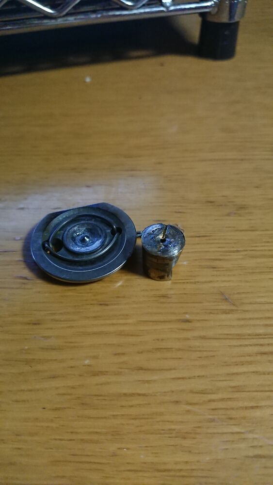

So I have gone ahead with this build including bitubos, which have been a pain!! The M9 bolt sip recommended is too short. Tired of dealing with them, so I ordered a longer bolt from Vespa Motorsport. I hope it's the right one...it cost 30 bucks!!!
Anyway I have a question. Rebuilding my carb. I was going to replace the gasket for the oil pump cover just because I have a new set, but the cover doesn't want to come off. It is only the three screws right? Is there a trick to getting it off? It felt like I was going to bend the metal feeder tube, so I stopped. Should I even replace the gasket?

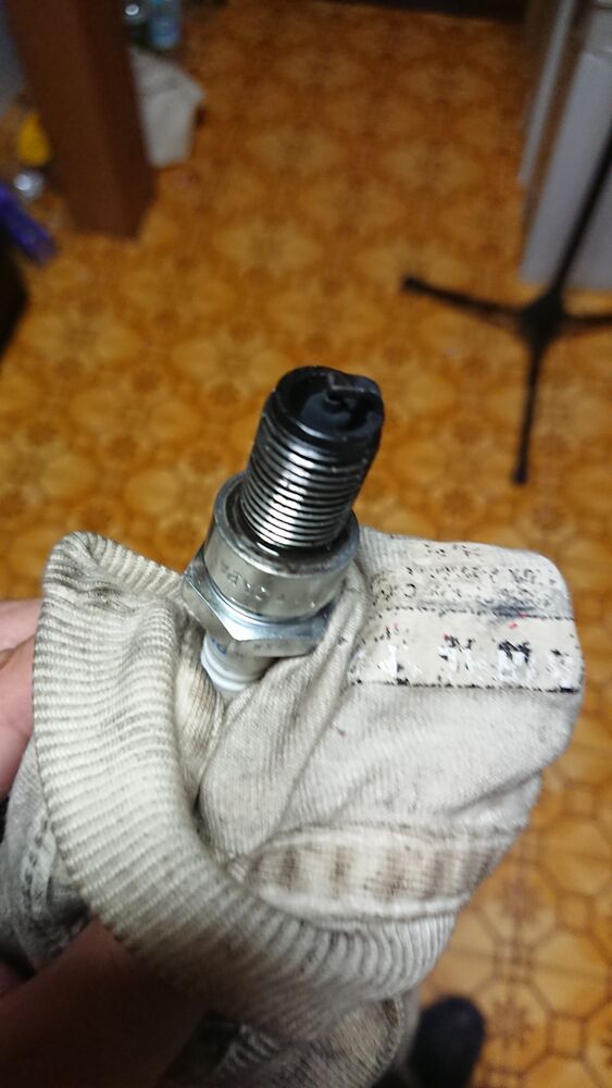

So the build went well. Have it up and running. Time to tune the carb.
The carb is stock except for the main, so 160/BE3/128. I also have the carb main to float chamber drilled out to 2.5mm. The idle jet is stock 55/160 I believe. I also have a 52/140 recommended by mistafreak moped, but haven't tried it yet as my idle sounds fine.
My mechanic had it running a .128 main jet during the break in. First thing I noticed was that it was four stroking, or so I think it was. Especially in first and second gear.
I wanted to try the supplied .127 main the was supposed to be included in the malossi kit, but when looking at the two I received, one is a .130 and the other is a .120! I have a BGM main jet kit, but the next step down from a .128 is a .125. Tried looking for a .127 and.126 locally in Japan, but with no luck.
I was a little nervous sticking a .125 thinking that it would be a big drop and it would be to lean, but looking at the plug, it still looks like it's a little rich. Average speed of 60km/37mph had my CHT at about 250°F -260°F and rose up to 290°F going up inclines for short periods.
Temps seem normal? I'm using a BR8ES recommended by Malossi. I know most of the world uses B7ES for stock bikes, but people here use B6ES maybe because of the slow speed limits, so I'm wondering if I should drop down to a BR7ES.
I'm still getting a little four stroking/flat spot around 4000rpm. I feel the .125MJ is still running a little rich since my plug is black. I have no idea where to start when rejetting. I don't know if a .125 is to small of a main jet and I would like to fix that flatspot.
interesting...i have that exact same jetting (and plug) on my stock PX200 (with a Sito+).
yeah I had a sito on it before and I was running a .122 and I thought it was a little lean. My plugs were never as dark as it is now. I know drilling out the carb drops your main jet, but it doesn't seem to line up with what others have been using with there malossis.

And just to be clear, i currently have a 128 main in my 200. I do have the heart drilled into the air filter, flowed the carb and carb box to the case, and matched the cylinder transfers to the case as well, but the engine is still bone stock.
Doesn't the Malossi 210 kit come with a 130 and or a 135 main jet included?
