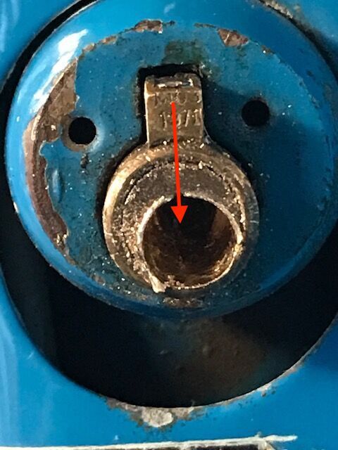

I'm drilling out the old steering column lock on my 1980 P200 but I don't know how deep I have to drill or how big a hole I have to drill. I've watched this video but it doesn't answer those questions.
Any thoughts?

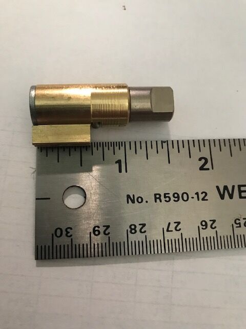

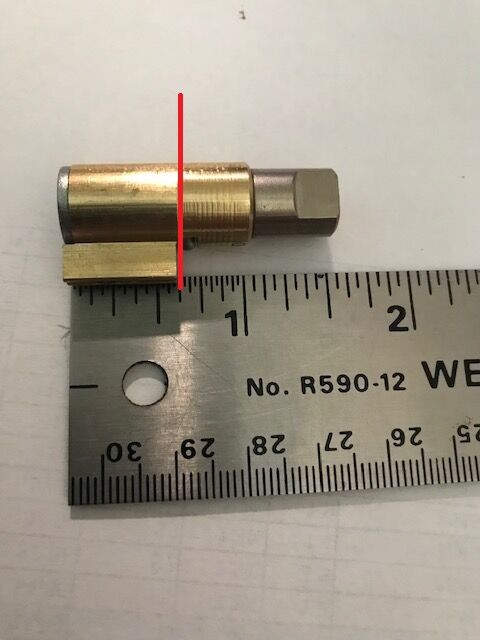

Pins stop at the red line but you'll feel it too. When you'll hit the hardened part of the lock the drill will "stop". Just drill at the center for the pins to fall out. Next, take a flat head screwdriver, wedge it in and turn anti-clockwise...

I think it's 4 pins. you reach them and the springs get caught in the drill. after #4 you can turn it with a flathead screwdriver.

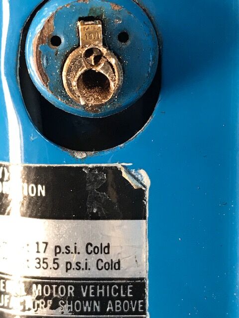

How screwed am I. I see now that I got off center when I started drilling. What should I do now?

You used a bit bigger drill bit than needed, but should be fine.
Did the tumblers fall out from the top?
Now just turn it with a screwdriver the way the key turns it and that's it!

The pins are in the square part at the top.
they're held in with springs, so they should all just fall out as the drill reaches them. They prevent the cylinder from turning, so once they're gone, it should be able to turn.
Hard to tell, but it looks like you probably got them.
If not, try a smaller drill bit in the area toward the top to get this area. (second photo here).

Yep. The drill just destroys the channels where the pins are, and it will grind them up. Since they're held in with springs, you can tell when you get them, bc the springs get caught up in the drill bit.
probably just need to do a second drill (smaller gauge) a bit higher. that will make it easier to turn, too.

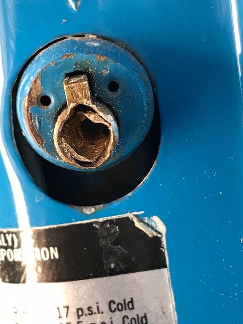

I started drilling a second hole and got this far and the bit snapped off inside. I don't know if I'll be able to get it out with an EZ-out so I'm going to go at it from below with a dremmel and hopefully reach the pins that way. Damn!

Grind up from the bottom that bit will eventually fall out.

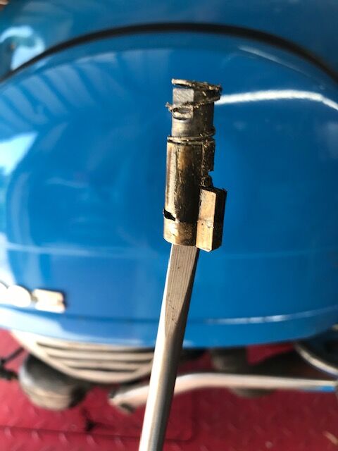

I used the Dremel from below and was able to dislodge the broken drill bit and then I continued removing material until I could get a screwdriver in and twist the barrel. I got it about half way and then with a final push, got it the rest of the way and out it popped! Damn, that was a lot more work than it should have been.

If you pry out the two rivets and remove the cap, you can use the key to turn the lock counterclockwise and the whole thing should pop out.
