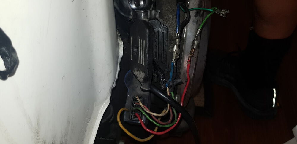

CDI Looks like this.
Alll good with the CDI?

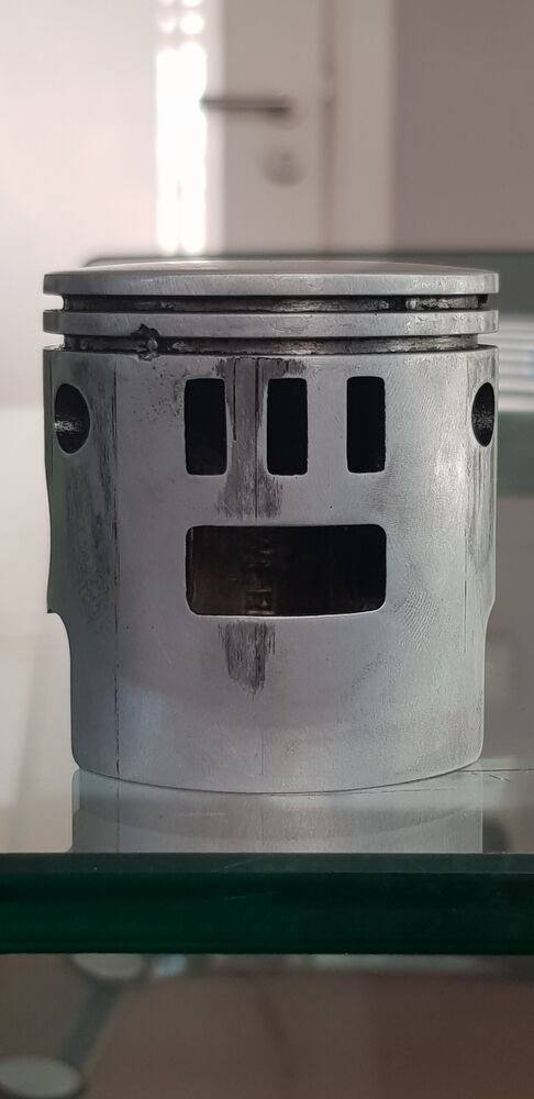

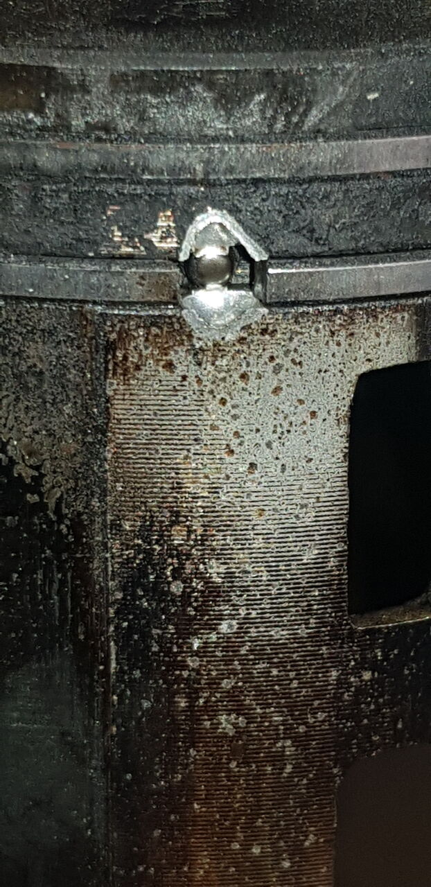

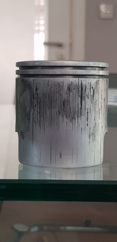

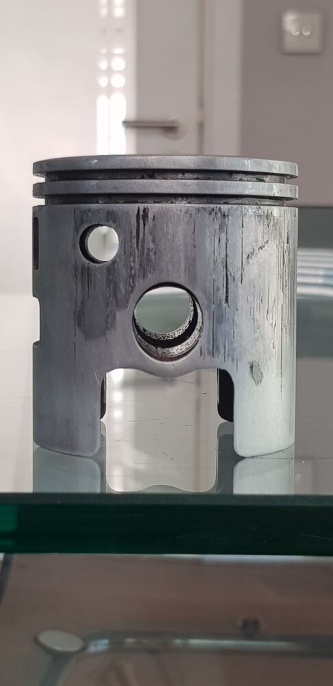

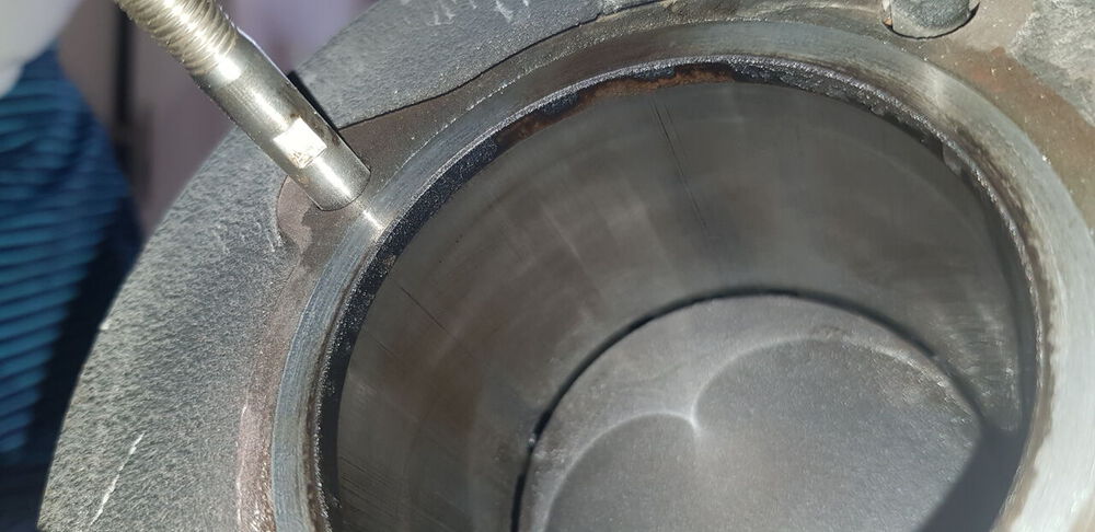

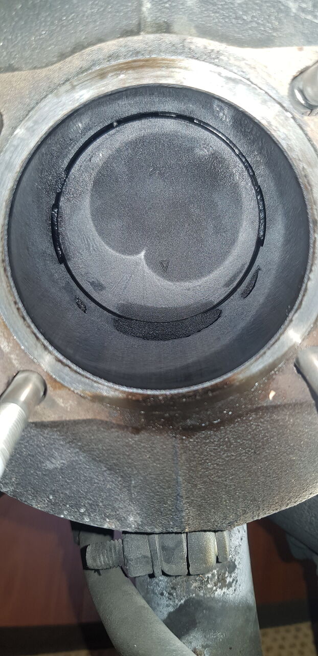

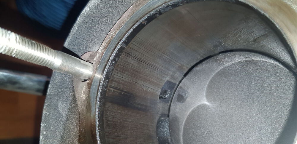

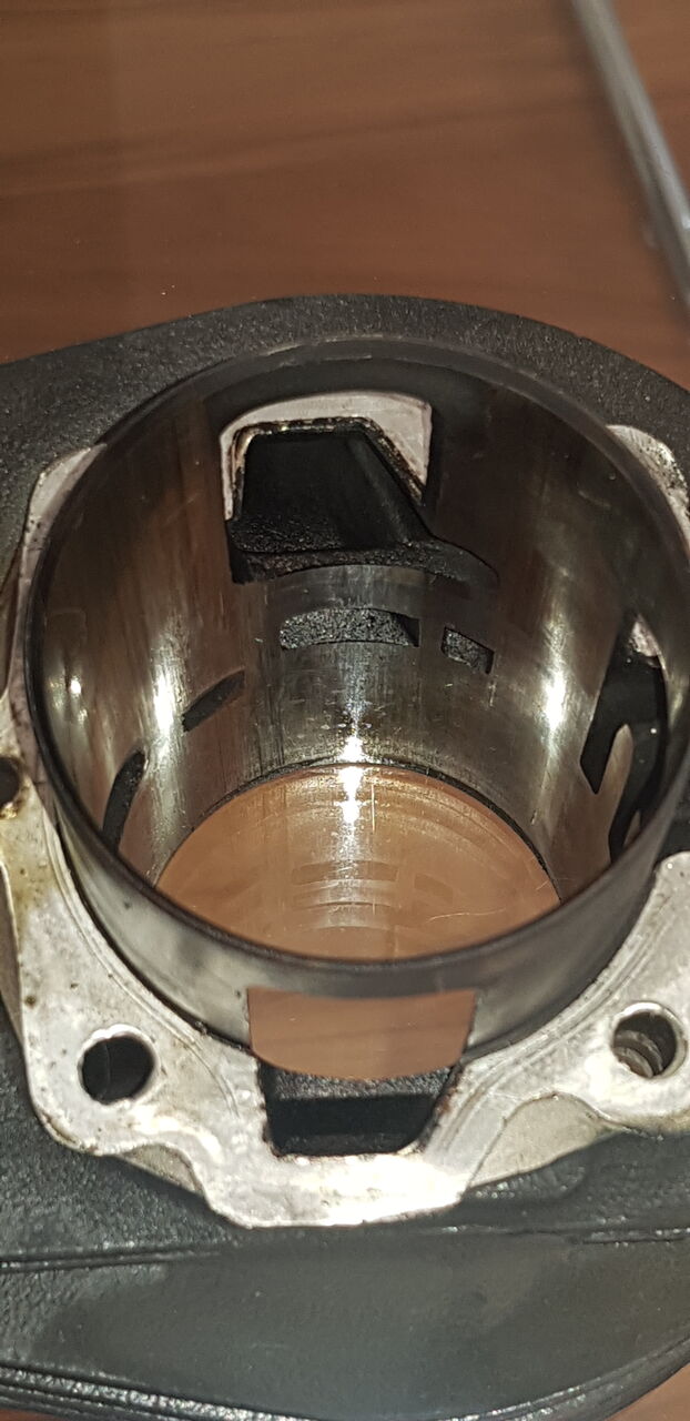

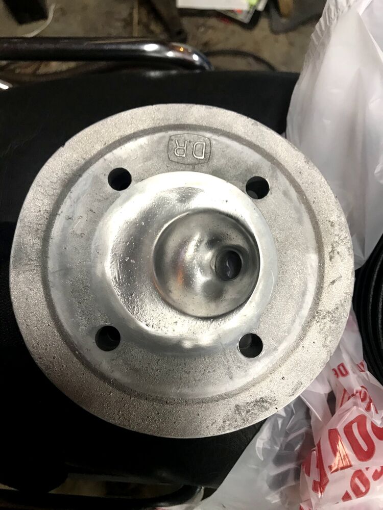

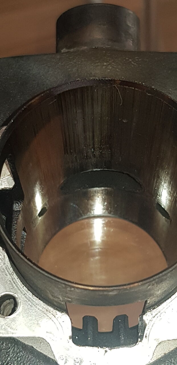

Head off
Apart from a little bit of a leak on the cylinder head (I assume lapping and tightening a bit tighter). How does the head look and the inside of the cylinder? Looks OK to me but obvioulsy not an expert.
Why is compression low?
Is this usual?
Is this the problem?
How do I fix it?

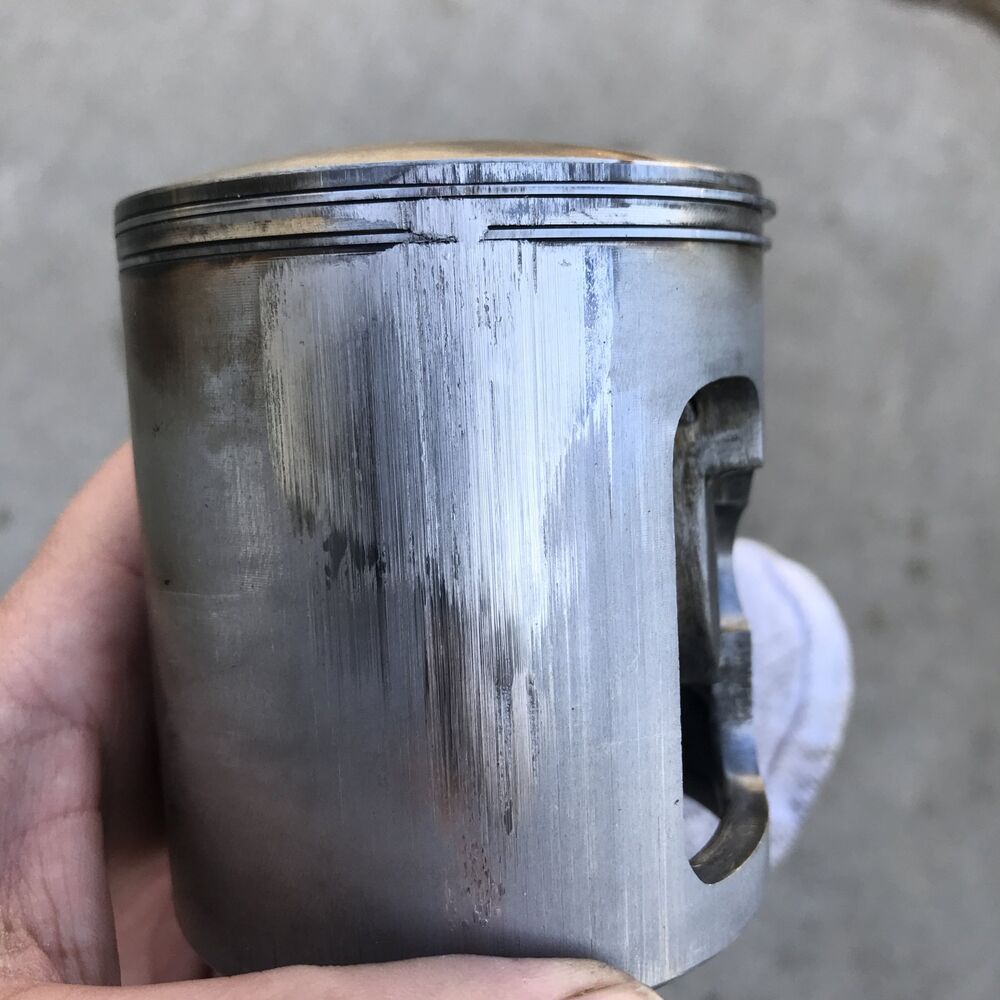

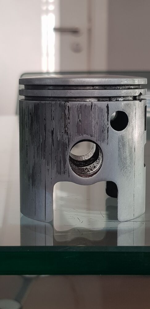

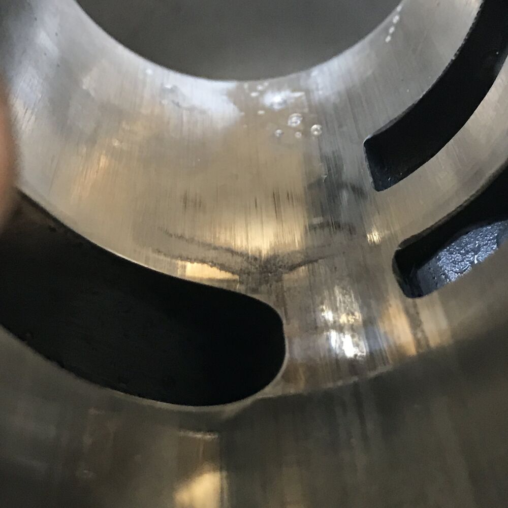

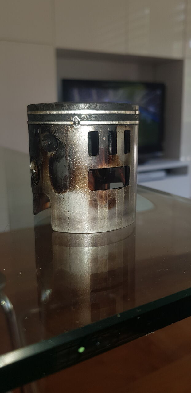

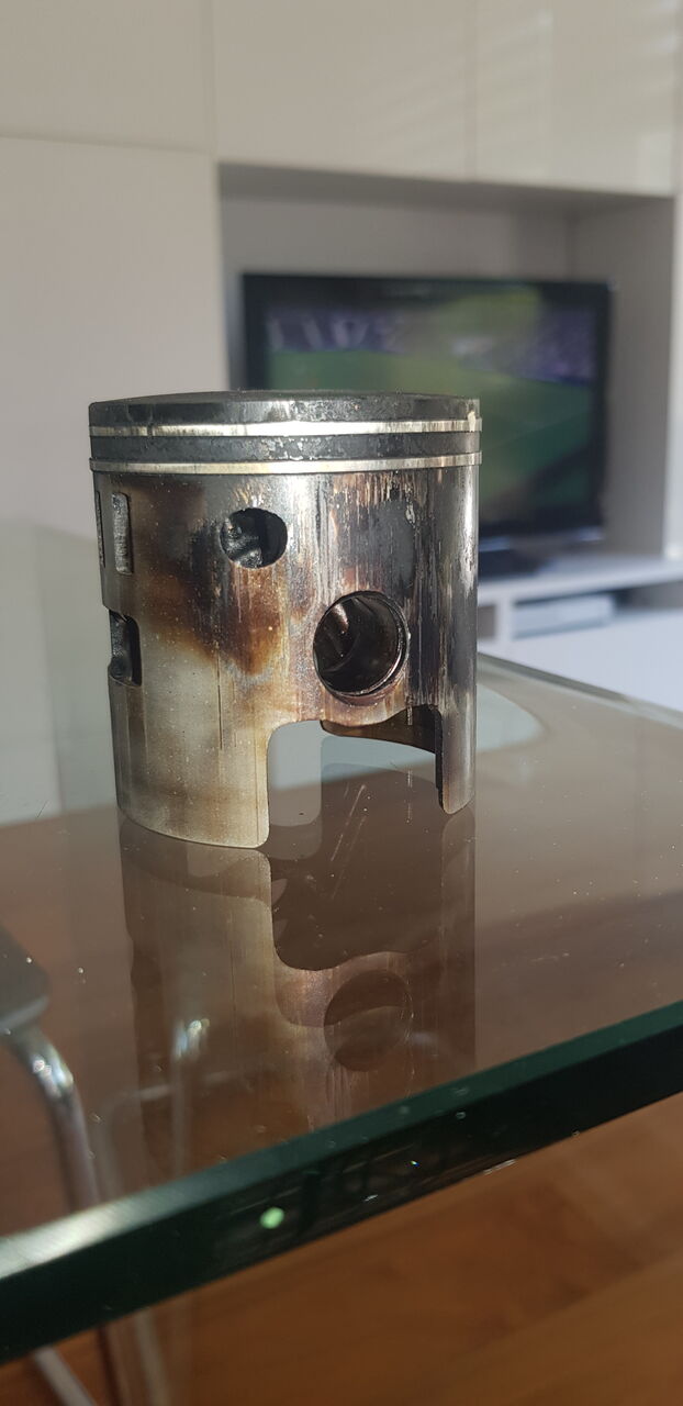

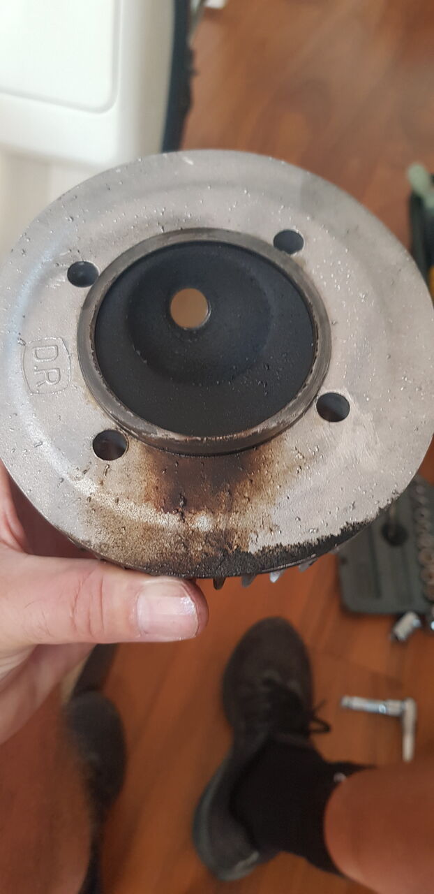

I'm going to guess you don't have enough compression for the motor to start and run at this point.
Sadly, you have all kinds of detonation based on those photos of you piston crown and cylinder. The leaky head (the natural state of a DR, btw ) probablyl caused enough damage that you eventually killed it.
Funny thing about killing pistons is that a lot of the time, you don't realize it (I don't, anyway...) until it won't start again, because it had juuuust enough compression to keep running with everything hot, but once it stops, it's dead until you sort things out.
If you can pull the cylinder off entirely, you'll most likely find that the piston has heat damage over the exhaust port area and is preventing the rings from seating properly. Depending on how extensive the damage, you might be able to fix it.
First, free the rings and remove them, then sand/file the piston back into something resembling proper shape.
for the rings and cylinder, they most likely have aluminum smeared on them. Get your hands on some muriatic acid and that will burn the aluminum off, but won't effect the cast iron. Wash it all off good, re-assemble, then fix your jetting before you get back out on the road.
As others have noted, your current jetting is way too lean.

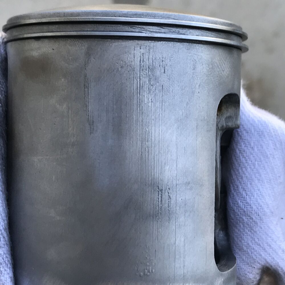

Something like this, those long streaks are most likely grooves down the cylinder wall or deposited aluminum. In picture #2 those specks of metal around 12:00 o'clock on your piston are most likely where you were to lean, overheating and detonating and melting aluminum.
While it's apart and your cleaning it up check the squish between the cylinder head and piston. It usually pretty large on these over 2.5mm and you can clean that head up and take some of that squish ring off and it will run better. Something closer to 1mm is good.

ferriswolf wrote:
Not so great news for poster Chandlerman, is there anyway of preventing leaky heads on a DR or is this a question of just checking once in a while that the cylinder head bolts are correctly torqued? I would have assume you would visually see a leaky head?
My solution was to scrap the DR head. I used a CNC milled VMC head with zero squish, so that I could lift the cylinder with a 1.5mm base packer, thus achieving much better port timings, a tight head/cylinder seal, and a respectable squish. Alternatively, just machine the sealing surfaces or sand them on a piece of fine sandpaper on a sheet of glass, using a figure of eight motion.
This is what I used to do. I'd lap both the head and the deck of the cylinder, then use Permatex 80967 when I assembled it.
When you lap them, color the surface with a sharpie so you can track your progress and you'll be amazed at how uneven it is when you first start.
To really get serious, I've done similarly to swa45, only I used a BGM 177 head, which actually sits into the bore, so I had that additional sealing surface, plus it makes it super-easy to get the squish to exactly what you want since it's just a matter of using the correct thickness head packer.

When you have a leak at the head - it lets air in - and it creates super lean mixture /detonation.
There are lots of ways to address it - as the guys noted above.
I would recommend, start by pulling the cylinder. You are this far, sliding the cylinder off isn't that much more.
If you feel comfortable doing it - take the piston off - and you can examine it nicely on the bench. A sharp razor blade, a small piece of sand paper folded, etc. to reshape the ring grooves if they are melted and holding trapping the rings from expanding - like on Christopoher's picture - will get them back in order.
Often, you can clean up the piston, put new rings on, make sure they float freely and don't bind in their slot, clean up the cylinder walls with the muriatic acid - and get back on the road for not much money.
Of course, you would need to lap the head as the others suggested - to get it nice and flat before you reassemble. If you decide to slide the cylinder off - shoot some pics of the piston and see how it looks. As noted - pay close attention to the area near the exhaust port. It is a common place for them to get trapped.

After, cleaned up fairly well, while your cleaning up the head, polish the bowl up and get rid of the casting crap (technical term).
Here is a head that has been cleaned up some, and the squish band removed to almost "0" to get a respectable squish and compression ratio. That's not done being cleaned up but it's what I could find, been a few years. Couldn't do much about the porous casting and air bubbles but did get anything sticking up cleaned off.
Great advice. Thanks.

Piston and cylinder off
Can this piston be cleaned up? Note what looks like a little hole where the rings are seated.
If I get new rings, any particular type?
If I need a new piston do I replace with a DR. Replace needle bearing as well and circlips?
Fri May 21, 2021 11:45 pm
Jet Eye Master
PX221 MHR, O tuned PX200, PX125 and some motorbikes
Joined: 14 Jun 2017
Posts: 3050
Location: London UK
Jet Eye Master
Joined: 14 Jun 2017
Posts: 3050
Location: London UK
Fri May 21, 2021 11:45 pm linkquote
Not the worst but certainly your starting issue. It would run again but it's tired and not worth spending money on. Either new rings only or a whole new kit (VMC).

Re: Piston and cylinder off
It's tired as Jack noted, rings look to be full of carbon from blow by. A new VMC kit sitting on the side would be a good idea. The close up spot looks more like one of the locator pins used to keep the rings from rotating. Don't want the ends to be in a port opening.
With all the above being said, clean it up for the experience. Looks like one ring is stuck in the ring groove. I find the more hands on time I get the more I learn. It would be a good setup to do a little porting on. Check squish clean up the cylinder head etc. If the rings are stuck it will most likely run again after being cleaned up. If your feeling particularly curious and want to learn a bit about honing a cylinder and checking ring end gap. Get new rings.
You can get a replacement set of rings, SIP even has a 1st over piston in stock.
https://www.sip-scootershop.com/en/product/piston-dr-177-cc-1o-s_12190100
https://www.sip-scootershop.com/en/product/piston-ring-set-dr-177-cc_20201000
DR177 Alternative Piston.

Almost looks like the protruding ends of the ring broke off and wore away that part of the piston above and below the locating pin.
I once had some 2-stroke Saab pistons that came with weak pin clips that came loose and hammered up and down and wore big ovals in the piston.

Thanks for all the input gents. I will look into the VMC. There are a few other things I may have a go at over the summer such as 60mm crank so may split the cases and go fo it.
I do like the idea of cleaning it up and seeing what happens though!
The rings snapped so need new ones.
With regards to honing the cylinder, it doesnt look too bad to my untrained eye. On the photos are there any particular areas where you can advise on what the issue is and why it potentially happened and how to fix it? Just to build my own knowledge.

Running lean
To summarise and for my own understanding.
1. It appears there has been some sort of soft seize with the rings getting stuck in the piston and then losing compression?
2. The soft seize is down to an air leak at the cylinder head which is shown by the oil stains?
3. Because of the air leak, this caused the cylinder to run lean and therefore increase the temperature?
4. The cylinder and piston could be reused with some cleaning and new rings. But a VMC would be better?
5. Becasue of the air leak and running lean the performance probably wouldn't have been great. And hence why I have been faffing around with main jets etc?
My way initial way forward:
1. Clean up piston and cylinder and get new rings. Lap faces. Potentially machine the head to the desired squish and put everything back together and tune the carb.
In your view, what would be the likely outcome be with this initial way forward? Worthwhile or not.

If you like to tinker I would do option A, not out much money, mostly time tinkering and getting to know your engine.
From what I have been told the VMC is a better performing setup, I have no comparison to know that.
You are thinking correctly about being lean causing a motor to overheat.
Get a cylinder head temperature gauge, like the one linked below. That will let you know if your running hot.
https://www.trailtech.net/en-us/shop/accessories/digital-gauges/tto-mini-gauge/tto-temperature/surface-tto-temperature-black-cylinder-head-sensor-14mm/?pfm=Browse

Cylinder
What's the best plan of action for the cylinder?
Muriatic acid was mentioned. Does it need to be rebooted or honed or will a light sanding do it?
Going to get started today so it's either upsizing the piston and rings or stick to the original size. I'll make call on that after I've cleaned up the piston.

Piston, what do you think?
Gents, cleaned up the piston as best I could. Plenty of lines down the exhaust port side and a few evidences of smears in other areas. This is the best I can do. What do think? What effect will these lines have on the engine and how to make sure it doesnt happen again?
New piston or just rings?

Sat May 29, 2021 5:19 am linkquote
so long as you get the aluminum off the inside of the cylinder (that's what the muriatic acid is for...it'll dissolve the aluminum but not affect cast iron on Nicasil) and maybe some new rings, that piston has some life left in it.

Got that Chandlerman. Cylinder has cleaned up well. But no expert obviously. I used industrial toilet cleaner. Best I could get!
