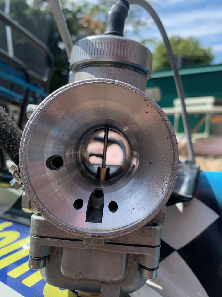

All sounds nearly good to get started. Did you reset and strobe the timing? Where is it set?
Where is your carb mounted? If in the tunnel and it was me, I would leave it open with no filter. The ram air filters are ok, as long as they are not squashed up.
You have tippex marks on your throttle grip? Need to know zero to WOT and each 1/4 position.

Ok, let's start at the beginning before you blow it up.
Have you reset the ignition timing yet? If you leave it high it's like working without a safety net.
The K21 would be the needle to try first. Clip 2. Biggest atomiser you have DP268. Smallest pilot jet 30. Inner pilot B42. No main jet.
Get all this in and adjust the airscrew at fast tickover. Aiming for as weak as possible. Under 2.5 turns would be great.
Edit: Expecting it to be too rich everywhere, all speeds, all positions, which is the best place to start.

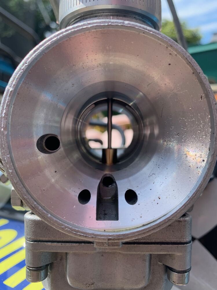

Ok Jack
Done what you said.
DP268
42 inner pilot
30 pilot
K21 2nd clip
no main jet
Air screw 2 1/4 turns out - idles at 1100 -1200 rpm
The bike is rich at 1/4 throttle (stutters)
1/2 throttle it seems rich around 5-6000 rpm and then it comes on pipe and really goes
Same for 3/4 throttle rich as it comes on pipe then clears and goes.
Full throttle obviously mega rich and won't go.
What next?
Olly
