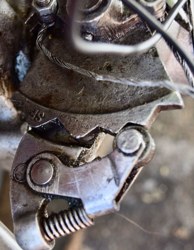

What I meant about the gears is, when I change them using the handle, the selector goes into each notch fine, but the back wheel spins free on all of them, so I assume it's not actually going into those gears, which makes each gear seem like a neutral.
If it went into gear with each turn to a new notch, I would think the back wheel would not spin free for 4 out of 5 notches.

You most likely have an issue with the selector and selector Rod. I will not begin to walk you through checking this as itís way more complicated then a largeframe-the removal and installation. Where are you located as I recommend a widebody specialist in your area.

Three things could be happening that you could test easily.
1. Clutch is engaged so it feels like the rear wheel is in perpetual 'Neutral'. release the cable and see if there is any difference. If not, take the clutch cover off as the geometry of the plunger might be keeping the clutch open.
This is unlikely as you would feel the difference in the kick start, but you stated you have no idea what the kickstart should feel like or what compression feels like.
2. The shifting cables are so tight that they are overriding the indexing mechanism of the shift box. Loosen the cable and see if you can shift by manually moving the indexing wheel.
3. The most likely scenario is that the arm of the shifting index arm is not in the groove of the shifting cross extension. On assembly it takes quite the effort to get this in the right position. put the shifting mech all the way into first gear (and beyond if it will) and tip the bike over toward the engine side. If the cross (and extension) are not engaged properly it will slip into random gears.

It does sound like the shifting arm problem is what's happening. I probably did not re-assemble that properly.

I have owned over 30 GS 150's and 160's. The GS160 is by far the easier to work on and more reliable machine, but as you have a VS4 (great choice by the way/super classic lines) I will stick to your machine. For around town you will want an NGK B7ES but once you get it running really well (yes, this is possible) and want to take it on the freeway (done this many times when I still lived in San Francisco/ great city) you will most certainly want a B8ES. The HS plugs are for VBB's and the like. They may fit, but that is not the right plug.
Here is the tricky part. NGK stopped making these plugs in a non resistor type (you don't want a resistor plug for your Vespa) so either you try to sourcing these plugs from someone like me (not selling/ just saying) or use a comparable plug made by another manufacturer.
The gear oil replacement is easy (SAE 30). Every auto parts store carries this stuff, and it's cheap.
The gear selector set up does take some finesse. it was the first major service problem I had on my first Vespa (a Cushman model VS5). You have received some great advice on this already. I must say, you will need to have everything hooked up (all your cables and adjusters) to get this done properly. Once all your cables (clutch included) are hooked up, first begin by setting the gear selector box in neutral. Kick the kickstart lever while trying to move the gears if this is difficult. Sometimes rocking the scooter (while you are sitting on it) back and forth can help as well. When you are in neutral, take a look at the gear indicator notches on the left side of your headset. You probably are not line up well. Don't worry.
Next loosen your gear cables on the gear selector box. Make sure your gear indicator on the headset is still lined up on the neutral slot and then tighten both gear cables. Do your best to get each cable as tight as possible without moving the position of your gear selector on the headset. Additionally, you will need to make sure the adjuster nuts at the front of the gear selector box, where the cables attach, are screwed all the way in (flush with the gear selector box). You will unscrew these nuts to tighten the gear selection from here so that slight movement of your gear selector lever on the headset is possible, without being so tight that you have a hard time moving the gears at all. Part of the problem you are most likely noticing is that the GS150 gears are very hard to move through while the motor is not running and the scooter is not in motion. Just moving from neutral to first, and back, can be a real chore. Your GS is not broken. It just needs to be understood.
Practice makes perfect, and the more you play with this stuff, the more what I am stating will make sense, and then, of course, the more you will enjoy your GS.

I just took apart the gear selector a bit and noticed I had forgotten to put in the taper pin (!). So I managed to get that in back together after some struggle, and also tightened the wires a bit. Now it appears I'm stuck in a gear again. I'll get back to it tomorrow after work. It's getting dark now.

Well I set up the gear selector today. I had the wires in backwards after figuring out which second notch was neutral and corresponding to the handle twist direction. It was easy enough to get it into neutral, and I took out the tapered pin again to see if I could align it differently to get it to work as I originally thought was right. But no. It had to be the other way, with neutral towards the outside, and not near the imprinted "SF"...
I can shift to every gear now but 4th. I'm not sure if that is a problem.
