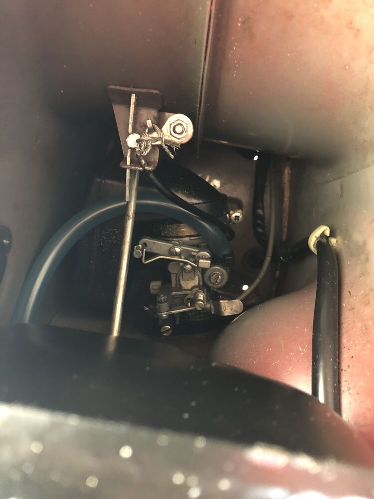

Mon May 24, 2021 4:50 am linkquote
Most likely the fuel line inside frame is routed in such a way (incorrectly) that when the suspension compresses, the fuel line pulls on the choke cable which then floods the engine. You just need to route fuel line so that it doesnít interfere with the choke cable.

Thanks for the idea!
I pulled the tool box out and tried flexing the rear suspension while looking in there. Didnít see anything moving around, but the fuel line and choke cable are right next to each other. Do I need to shorten this fuel line a bit to remove some excess?

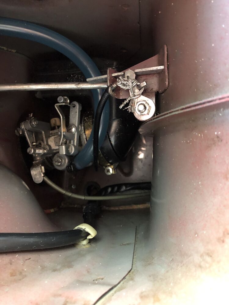

Mon May 24, 2021 9:22 am linkquote
Another pic

Tue May 25, 2021 10:08 am linkquote
You might want to check the operation of that 'choke' cable. What it actually does is pull a plunger up in the carb and allow more gas to enter the idle circuit. The outer sheath is not anchored at the lever and maybe it has pulled out of the fitting on the carb which can put a strain on the inner wire and delivering too much gas to the mix. A proper cable is cheap.
That said, all of this is inside the frame and should not be affected by the up and down movement of the rear end.

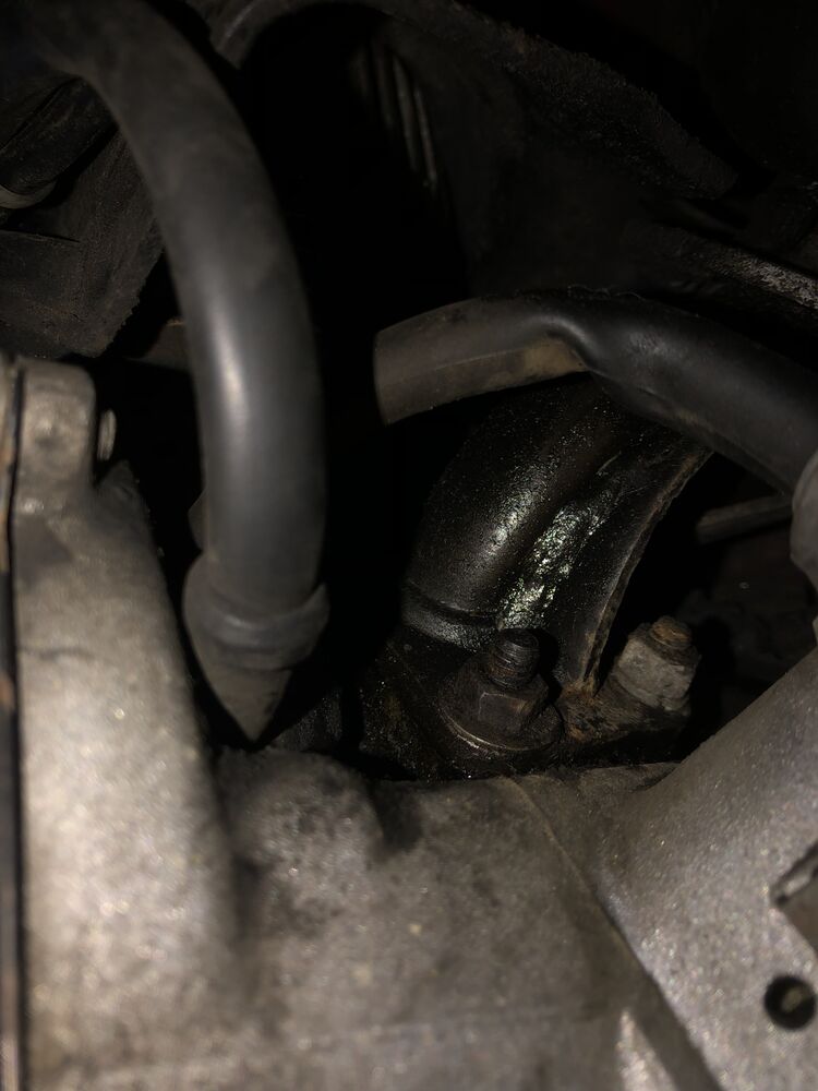

I went out investigating a bit more tonight. Checked that the spark plug is getting a spark - no problem there.
When I looked inside at the manifold, it appears to be ďwetĒ. Would it be possible that the connection between the carb and manifold is not sealed?
To check this, would I remove the fuel tank and then the carb?

Tue May 25, 2021 11:22 am linkquote
Since youíve been kicking forever, pull the spark plug out of the cylinder and let it air out for a while. Might have flooded the cylinder. Doesnít hurt if thats not the case.
As far as the wet area where the manifold bolts to the cases, its a common dirty spot on small frames. Itís the lowest part of the cases so gravity brings oils/ gas down to that area. Wipe it down and check on it in a few days. See if its leaking, or if something is dribbling down to that area. Thereís 3 nuts that hold that onto the case. 2 are easy to get to, 1ís a pain. You can check that those are all tight while youre down there.
If you havent already, go ahead and pull the fuel tank out. Youre not going to hurt anything doing that. A little tip, if you have a wooden bench or rail, insert a screw into it vertically. You can hang your tank via the bolt holes onto that screw.
While the tanks out, check that that carb is secure in its collar and if youre up for it, pull the carb out and remove the banjo bolt on the right side of the carb and check the fuel filter for grit. If thereís plenty, consider a carb clean.
