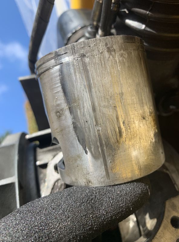

~ 1000 miles on brand effing new Pinasco aluminum 177.
This is getting tiresome and expensive ...

Wow what happened?

That'll buff right out...
Seriously, though, that looks really effing bad. Did it seize coming off a high speed run? The ol' "Let off the throttle and it just...dies...?"
I feel like that's how I usually manage to make pistons look like that.

Pretty much.
That's three cooked 3 pistons in <2000 miles.
What in the bloody hell?

what's your ignition timing set to? probably a couple degrees too advanced. That's all it took for me to kill a couple pistons.

Couple of questions why is the piston so clean see no carbon or anything on it did you clean it off already? Also the piston looks so smooth don't see those horizontal machine lines is it my bad eyes?
CM - what was the failure mode on the ones you killed?
Pinging disintegration around the top perimeter of piston?
Hole in the center under plug?
Seize on sides?
Is there a type of failure that occurs with timing related meltdowns in your experience?

Normally from detonation I would say hole in the top.

I forgot to ask earlier...s it just the piston, or is the Nicasil on the cylinder trashed, too?
And you probably already know, but you can clean any smeared aluminum off the cylinder with muriatic acid (thanks to Ginch for that tip).

Chandler: Timing is 18°, as specified by Pinasco. This is the formerly trusty yellow Super... 20/20 carb, bell mouth, 55/160, 160/BE3/128, BGM BB Touring, autolube.
Was maybe 70 miles into a long ride. Pulling a long, gentle uphill prob between 3/4 - WOT, 60+ mph. Engine just fizzled, like it was outta gas.
At first thought it was the clutch ... removed the cover and the nut was loose, clutch was just spinning on crank. Tightened it up, went to kick it ... piston wouldn't budge. Then found this.
hibbert: Piston is indeed clean, and weird burn pattern. Cylinder is clean too. Head is pristine, literally looks unused (see pics).
Have no idea what's going on.
poidog: No, not the GL, thankfully. But hesitant to even run it now. Totally second guessing my skills and feeling a bit cursed.

Unfortunate. Too weak by the looks of it. Piston crown should be fully black to the edge when jetted correctly. Timing more than likely not exactly measured at 18 degrees but lower. Low timing gives low CHT but high EGT (where the seize marks are).
Cylinder will clean up. It will live again. Chuck more money at it.

Christopher: A 55/160 is quite a bit richer than a 45/160. The A/F ratio is almost 20% lower.
I believe the jets are BGM, but don't remember for sure. I can check.
The engine temp never got above 304°F (see pic of gauge above).
And at the time we were somewhere between 3000-3500 feet elevation and going up, which means the whole set up would've been running richer than normal.
TromboneBob: I'm fairly certain the autolube is working, but not ruling anything out. I've done every test I know how to do on the auto lube. Oil moves through it. Piston had a coating of oil when I pulled it. There was oil in the small end bearing and on the crank. I have not tried running premix in this scoot.
Chandler & Jack: So which is it? Timing too advanced or not advanced enough? Doesn't look to me like there's any detonation. I'm willing to admit it may not be exactly 18°. It could be 18.5 or 17.5. Is that 1 degree really going to make the piston melt?
Also how do you explain the plug color? It looks damn near perfect to me. Plug was brand new when I left the driveway two hours earlier.
Does the burn pattern on the piston definitely indicate a lean condition?

Why was the clutch spinning on crank? Key ok?

hibbert: I don't know why the clutch nut was loose. Yes, the key was sheared. The clutch was spinning on the crank because the nut was loose and the key was sheared. Why is a mystery.
It's possible the key sheared and the clutch nut came loose when it seized (thus saving me from an ugly high speed lockup).
It's also possible the clutch nut came loose, causing the autolube spacer/cog to disengage, causing the engine to seize from lack of oil.
Thoughts?
Yes. I've said this a few times but I'll try to make it clearer. When you turn the timing down to reduce the CHT the heat doesn't disappear, it moves, to the exhaust, the EGT. The head is designed to dissipate heat, the exhaust port is not. Your jetting is too weak at high rpm. Timing is too low, measure it exactly.
And yes. Lean where it seized. Rich at low rpm and lean at the top.
Change the AC to 120 and timing precisely at 18 (I would set at 19) and it will all work out fine. Probably go faster too.

128 with a bell mouth is super lean. I'd lean 125 without it. Probably 140 with the bell mouth.
Started with a 140 main when I got the bellmouth. It barely ran past 1/2 throttle. Worked progressively down through the 130's. 128 is about as fat as can be. It wasn't just a random choice. Good thinking though.
Rooney wrote:
Have all the seizes been with the 20/20 carb?
No, just last two. Seized before that with a 24/24 + 118MJ (no bellmouth).
For reference, a Polini 177 bolted on to my other Soop (identical 3-port Veloce engine) 20/20 carb, no bell ... and a 112 main. It's been up and down the California coast, thousands and thousands of miles, not quite as fast but solid as a rock.
IDK. I think maybe I'm gonna ditch the bell mouth altogether.
Jack: That burn pattern is just wrong. I like your theory. I can see it being the result of timing being too far retarded. To paraphrase Forrest Gump, I may not be a smart man but I know how to time an engine. In fact I checked it just before the trip. I'm willing to bet it's dead on 18°. I'll reset it to 19°.
What I don't understand is how anyone would possibly know NOT to follow Pinasco's express instructions about setting the timing to 18°. That is the one thing they are absolutely clear about.

I place a vote (not that I have a vote, or if I did have a vote, that it would count) for trying the Jack Stack with the 120AC/BE3/___ and bell mouth. If you can jet in the bottom - you're all set as the top, as it doesn't wanna lean out at WOT as much - at least in my experience.
Seems like with 160AC you otherwise get in to this loop:

Just a thought. I know 4 people here that seized their P/PXs (a 150, a 177 and two 200s) with BGM boxes. All properly jetted...

If you showed me that piston crown a week ago I would have said it will seize on a long journey. It's too weak. Must be black to the edge or it's going to blow.
Wouldn't read too much into the BB . The better an exhaust is the better your jetting needs to be.

I like your confidence, Jack. We're gonna find out. New piston, rings and clips have been ordered and are on their way.
The way I see it, the burn pattern shows that LOTS of fuel is washing in over the piston from each of the three ports.
It's definitely not detonating. There aren't any signs of early ignition.
The plug is exactly what I'd want it to look like.
I suppose too retarded ignition could account for the sparkly clean head.
Would also account for the exhaust port is getting red hot and dragging the rings. And the relatively cool head temp when it seized.
Makes sense that advancing the ignition a degree would cause combustion to occur earlier and up closer to the head.
I'm willing to give it go.
