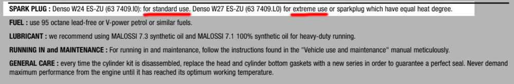

Malossi instructions also suggest the same based on usage type. Hotter plug standard use, cooler plug extreme use.
300KM high rpm would suggest to me more extreme use than 10 KM city driving.

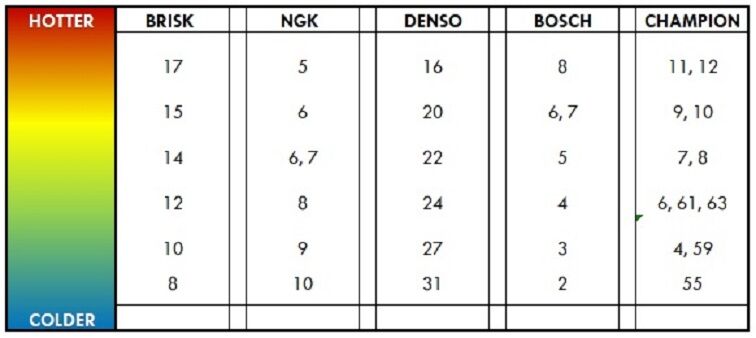

I know that most of us don't use Champions, and prefer NGK. But if you do, be aware that Champions heat rating is HIGHER with the higher number, unlike all the other brands.
That said, my 1985 bone-stock PX150E has never had any issues, whether using NGK -6, -7, or -8, Denso -20, or Champion N9.
