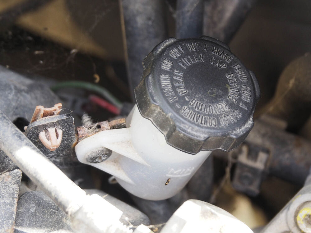

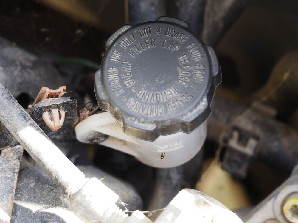

I got to the reservoir, thanks to some images I found on the forum.
Right away I noticed that it was tipped on its single attachment lug.
I straightened it up, turned on the bike and revved the motor to about 4000rpm for about 15 seconds and then tried the tllt-lock switch.
Result: the lock worked perfectly, the warning light went out and the beep disappeared.
I have no idea why this worked, but am so relieved it did. I'm a long way from a service depot.

Uhmm, okay, that is weird.
The reservoir is just a bottle on the end of a hose. Adjusting the angle wouldn't make any difference.
Maybe moving the machine had some effect?
Keep an eye on it and let us know if the problem re-occurs.

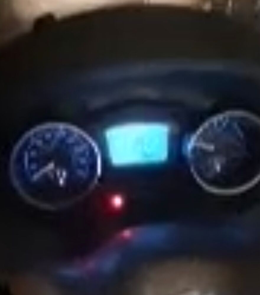

I had the read warning lamp light with a beep every second and the tilt was not possible to activate or deactivate.
After tested all found solutions without any success I gave up and contacted our local Piaggio shop.
They connected their test tool and found out that the part on the picture needed to be replaced.
I have ordered a new and installed it and now everything working just fine.
Thank you for sharing the story and part photo, thats good information to help solve the mystery that others might be having.
Do you have the part number or what was the part called on the order invoice? It sorta looks like the lower indicator display panel from the dashboard.
Having the part number would come in handy if my 2016 500ie (which is getting up in miles) ever has a similar problem.
