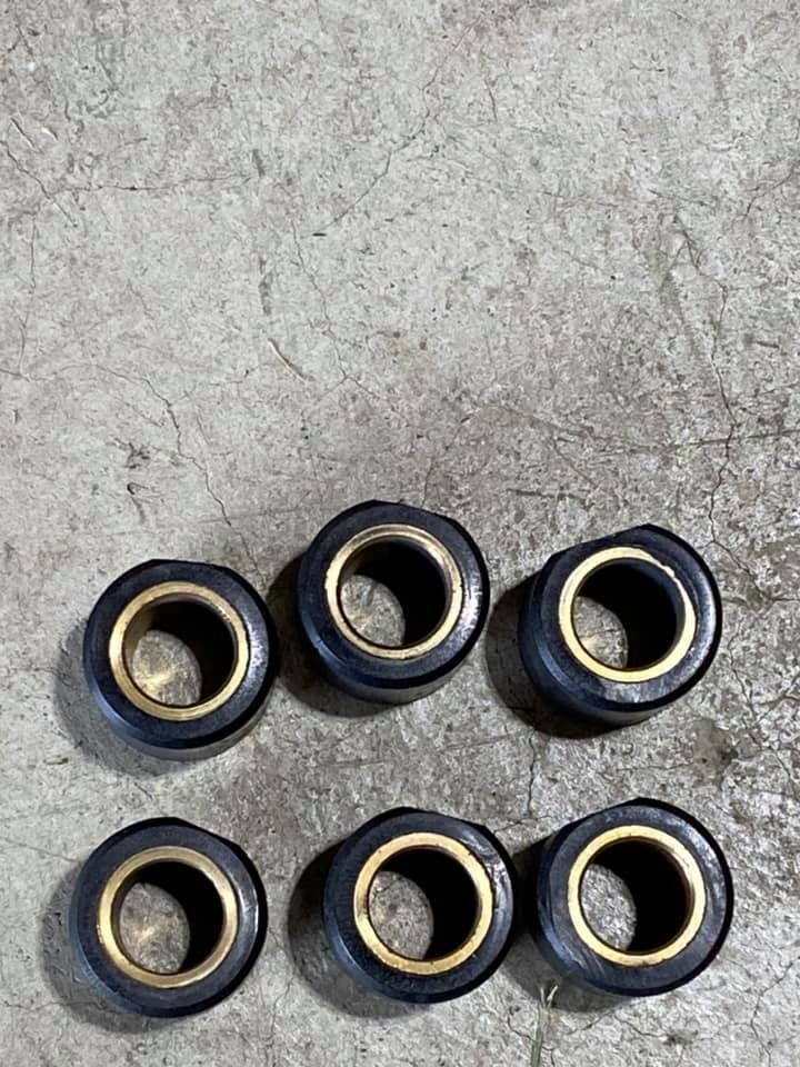

My rollers had significant flat spots when they were removed. The old belt still looked in good nick, but was .02" narrower than my new one (measured with my calipers) and was replaced.

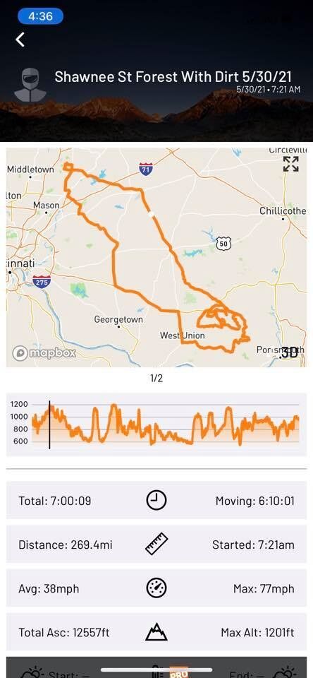

Buttoned all back up, all nuts torqued to correct specs, and went for a longish 270 mile ride. Now the bike has a hard time eclipsing 70 MPH on the flat roads where I was previously hitting 74 and the tach shows under 9K RPM. I did manage to hit 77 MPH on a long steep downhill, but still never hit the rev limiter. Prior to the service, it would hit rev limiter on this same downhill and just barely hit 75 mph. I'm also running a 140/70-12 Pirelli Angel rear tire, not sure if that would affect hitting the rev limiter.

9K miles on these Malossi rollers, with extended WOT riding

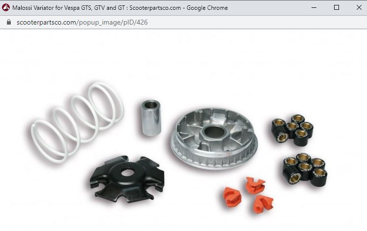

I bought what is pictured below, and it came with orange guides. I do have a set of black ones as well, perhaps I should swap them out?
