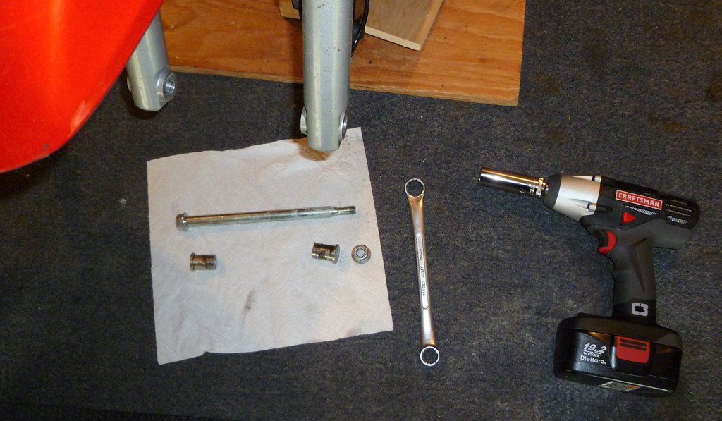

Hold the right side axle hex with a 19MM wench. Loosen the Left side axle nut with an 18MM*wrench. (*an odd size for me- had to run out and buy one!)

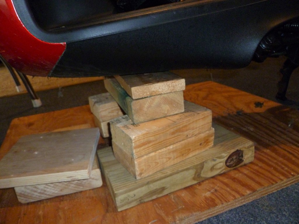

There is a hard frame member just inside the under-belly panel, feel it and use it to block up the scooter for front wheel removal.
Once scooter is safely blocked up - remove the Left side nut, pull out the axle paying attention t the order of things.
Axle nut is torqued to 46 ft lbs.
