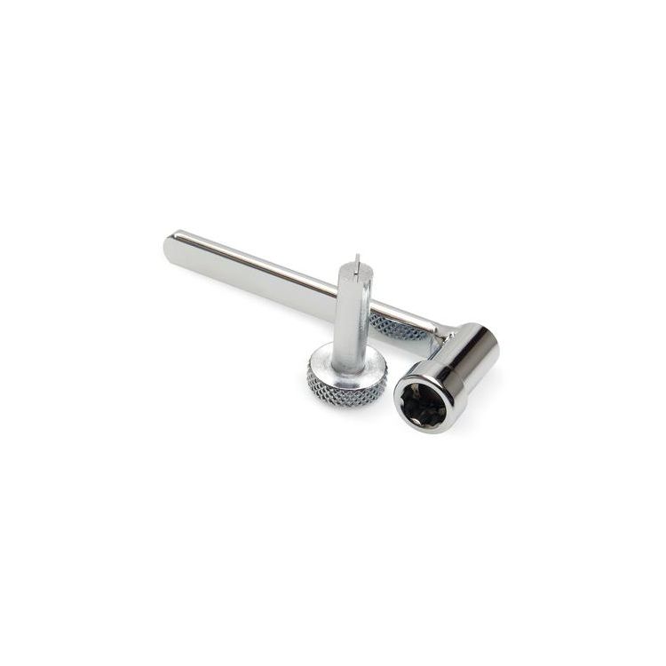

Bobke wrote:
I also had some fun way back doing valve adjust -- needed 3 hands --
Do you posses the correct tool for this work?
https://www.revzilla.com/motorcycle/motion-pro-tappet-adjuster-tool

Kevin -- I was using the right tools at the time but I was doing American V8 hotrod/dragster engines -- really easy access but I was always triple checking and readjusting to get it exactly right -- haven't worked on engines much since then -- 40- 50 years ago.
That is a nice looking tool but I will likely have dealer do the valves.
