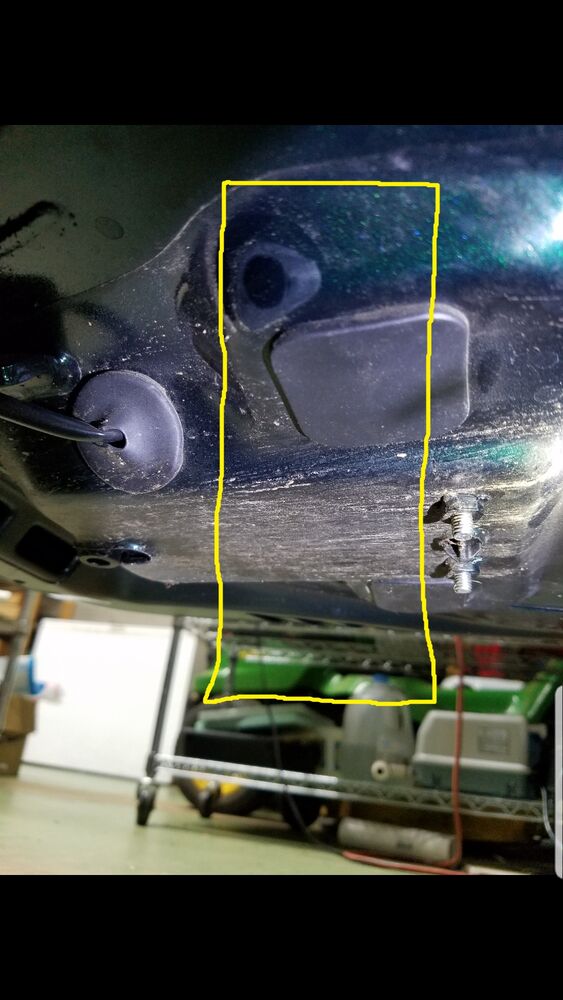

Thinking ahead to my 6000 mile service and dropping the motor: I've been looking under the bike and see two rubber pads that look like where the jack should go, but there are a couple of screws sticking through right between them. Should the jack be placed just in front of those screws? How critical is jack placement? My jack has a wooden top, so I could center it on those rubber pads and cut out the edge to accommodate the screws.

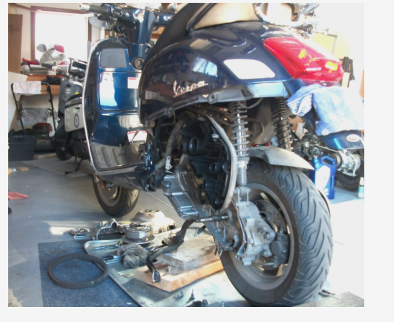

You don't need a jack. Hike your center stand up on a couple of 2x10 or 12 scraps. Undo the rear shocks at the top. Use another scrap 2x under your rear wheel to leverage things up and down. Be sure to uclip the coil wire, or anything else that will be uncomfortably stretched.

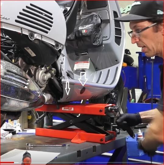

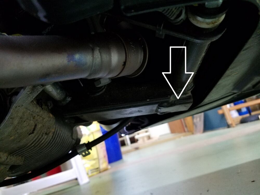

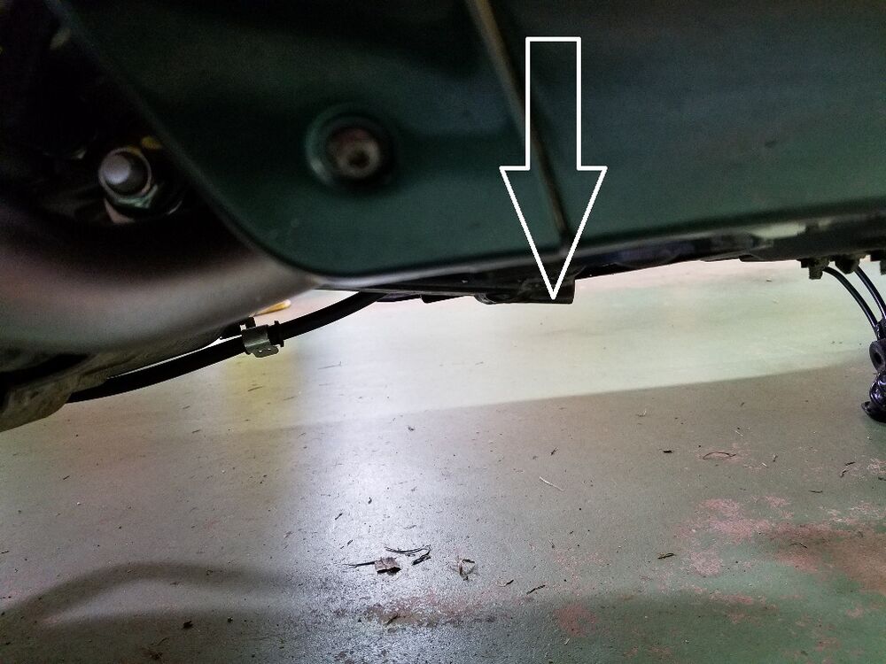

I re-watched Robot's 6000 mile service video. His jack is about 6" wide with a flat top. He has it placed way further back than those two rubber pads that I mentioned before. There is a solid steel part of the framework that sticks down below the sheet metal body. It looks like the jack is exerting all the force there and not touching the body at all.

Good pictures. I'll have to rethink the use of my HF jack. It may be too wide - it was perfect for heavy frame cruisers.
