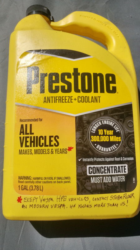

jerryd wrote:
coolant overflow tanks are see through for a reason. with a quick glance you can tell if coolant is low or contaminated. if you see rust or other contaminates its time to flush and replace. there is no such thing as wrong coolant or coolant that doesnt mix with another coolant. and there is no such thing as unseen contaminates that will harm your water pump seal.
when common sense fails Facepalm emoticon
but it is entertaining! thanks for that!
jerry, hello. You seem to have misunderstood the situation with coolants. You can mix brands if you are very careful and understand the coolant types and standards, but you cannot actually mix different types of coolant. And of course, as you know, some coolants cannot be used in some engines due to problems it causes with radiators and water pumps/cylinder head gaskets etc. You can check this yourself by contacting coolant manufacturers and/or reading up on it on some of the technical sites covering engine coolants.
Just a couple of casual reads, but take a look at the science too. Do your own search.
https://tap.fremontmotors.com/mix-different-types-coolant/
https://mechanicbase.com/coolant/mix-different-anti-freeze/

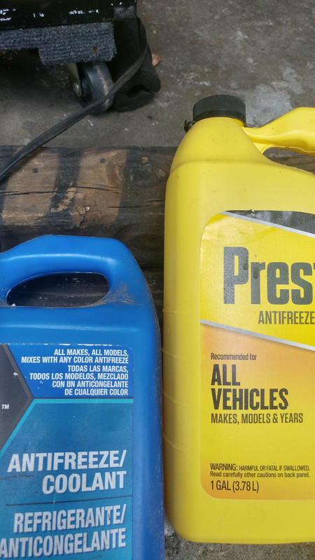

stormrider, I think you misunderstand. all coolants mix readily cause they are all designed to mix with water. this includes even ethylene glycol based and polypropylene based. the only difference is the chemical additives that are touted as extending the life. to say you cant add additives that extend the life of a coolant that didnt have the additive originally is Facepalm emoticon ..in the end what really causes early failure is when its left in too long and screaming to be changed due to how bad it looks in the expansion tank.
I asked you previously to provide simple proof to mix on purpose in a glass jar and see the ugly you tout. you failed to do so as you will this time as well. all the scary pictures on the net are useless once the fact revealed those coolants were used well beyond the "screaming to be changed window"
and you cant refute manufactures who dont like to be sued. picture worth a thousand words. I have been wrenching for 50 years. you are barking at the wrong person AND causing the uneducated to spend money and time when they didnt need to. so bravo to you.

Stromrider, coolants in the USA that state on the label that they can mix with any other coolant are AOK. Believe me, if there was the slightest chance of one of them causing damage to someone's engine, they'd have their butts sued off - probably in a class action that would put them out of business.

its the nature of any big business that creates this debate. selling coolant is no small business. the manufacture makes more money by selling the same dang thing with different labels. the dealer charges quadruple for the product. economics for them as well. super easy to say a certain coolant is vehicle specific and its best to buy from us. and it cant be proven otherwise because they aret required to tell you whats actually in the coolant. some just cant see through it. at least his heart is in the right place.
all hard parts in an engine are corrosive in water. always have been. what gets better and better is the number crunchers of manufactures who maximize profit at the consumer expense.
the reason coolant goes bad is no matter how good an engine is built small amounts of that 1600psi combustion go into your water jackets. head gaskets will never seal 100%. but they are getting better and better. it is that "better seal" that is allowing longer intervals before needing to change coolant.. antifreeze itself has not changed over the years.

Hi jim, yes it's the same the world over. But we are really not talking about mixing brands here which is where jerry is getting confused. We are talking about mixing "coolant types". It's this Grouper was concerned about and rightly so too. Mixing coolant types is something you cannot do without usually incurring nasty consequences over time. Hence Scooterwests warning not to mix Coolanol with Groupers factory OAT. The OAT has to be flushed out first. Anyone doubting this should look online for more information or contact their vehicle manufacturer. There's plenty of proper advice and information about this. Most techs already know this sort of stuff as we are trained to know about it so we don't damage customers engines.
But more widely it should be understood that different coolant 'types' use different methods to protect your engine from corrosion. Some lay down a "carpet" of protection on all internal cooling components to stop corrosion (IOAT does this and is still common in the States), and some just attack corrosion at source when the coolant comes into contact with it (eg: OAT). The two types of coolant must never come into contact with each other or a chemical reaction takes place that can render an engine useless over time. Mixing them in a glass does not produce the same result as in an engine either.
So if someone decides to replace their engine coolant you must know what "type" (not brand necessarily) of coolant has already been in the engine. That way you know what is safe to put back in or even to top off with. If it's been an IOAT it's very hard indeed to flush out the remnants of that coolant because the blanket of protective layer it has put inside the engine will not come out easily and it even sticks to the inside of hoses. In the workshop we have even had to replace the coolant hoses to get rid of the IOAT completely. We would never recommend replacing IOAT with an OAT coolant as it's an expensive procedure and we have done it when a customer has requested it only. It has to be done if refilling with a different "type" of coolant to be safe when you are working on a customers vehicle that may have cost them huge sums of money. If you don't do that the customer will get a nasty surprise and big bill in the future.
So best advice is not to mix coolant types (remember that's different to coolant brands) that are incompatible. There are dozens of differing types of coolant, each with a slightly different way of working. None of them completely mix properly with each other but they do mix just well enough to work, but usually less efficiently than that of a pure coolant of one type. Others, if mixed will cause considerable problems for the owner if mixed. That's why owners need to be extremely careful. Coolants are THE most misunderstood components of internal combustion engines.
