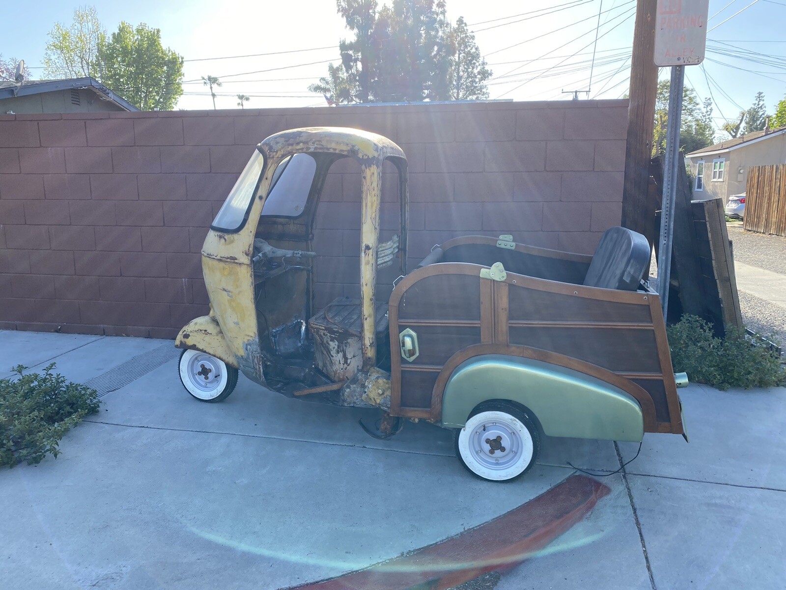

Well... I found another Ape. Or it found me. Too good of a deal almost to the point where I "had to" buy it. Or at least that's what I am telling myself!
This is a Piaggio Ape 400R (or 401R?). It was used as a display for World Expo 86.
Obviously a bodged "restoration" where the cab was cut and turned into the calessino/convertible version which was never available for this model. Then they bondo-ed over the front seal and welded patches over the fron turn indicators. Crying or Very sad emoticon All fixable but I'll probably leave it for now.
It was advertised as a tuktuk and after I asked for some better pictures, I confirmed that it was all legit Piaggio! Score. A complete engine with great compression is all there too!
Looks like I am averaging an Ape a year. Not bad I guess! Haha
