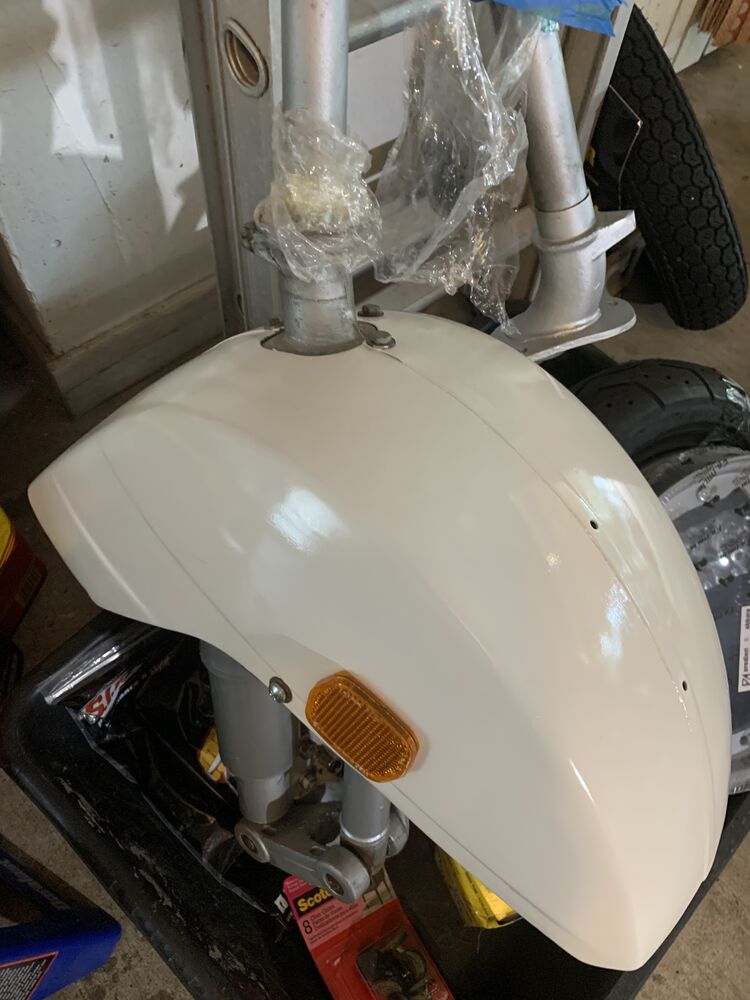

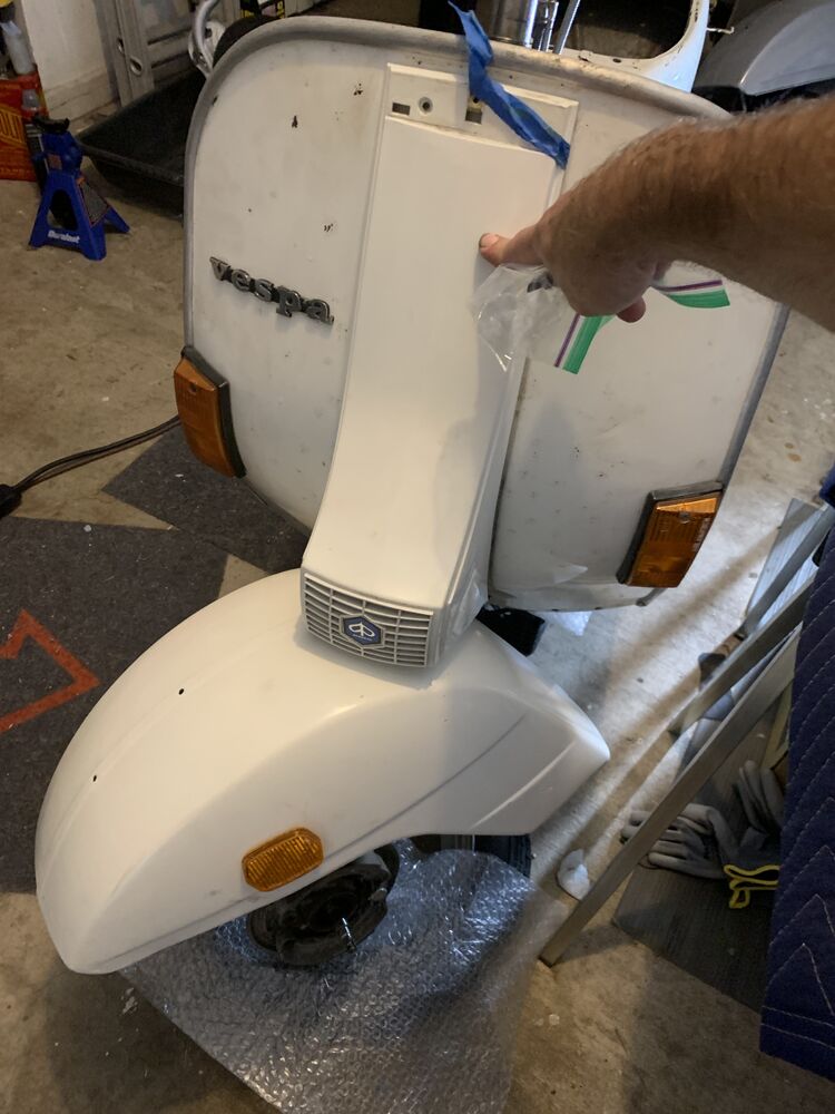

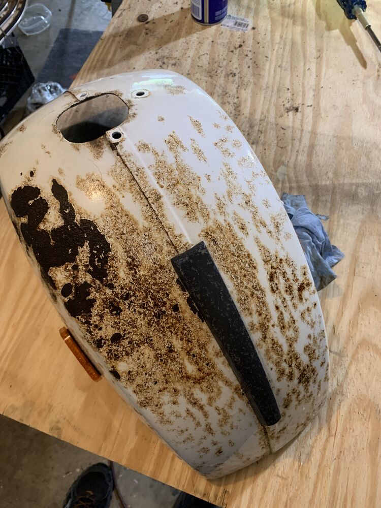

I got tired of trying to blend and distress one side of the fender so it matched the other. Went ahead and painted the whole thing. 6 one way half a dozen hours the other… or something like that.

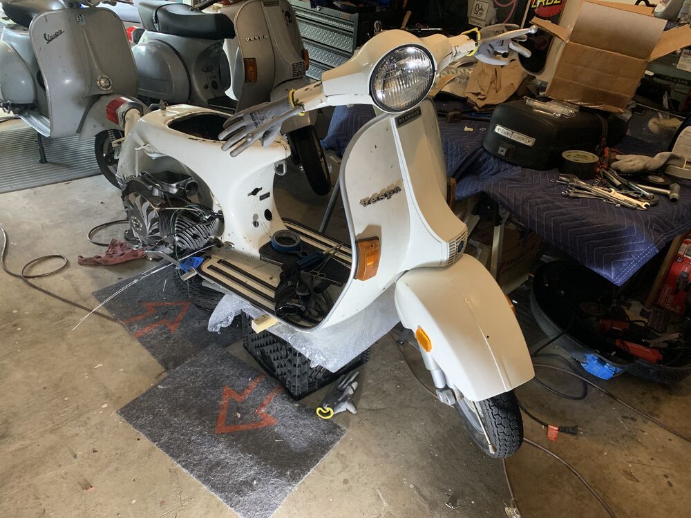

Starting to look like a scoot again.
*if* I have the engine mounting bolts will have a roller by then weekend. Hoping they are boxed up with the rebuilt engine. (I suspect I will need to order.)
Started here for reference
Other side after paint.

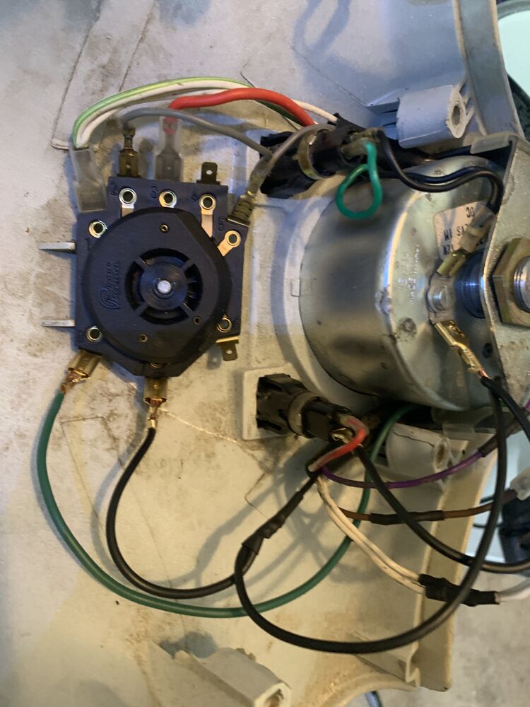

Good day in the garage….
Baseball on the radio and ran all the handlebar—switch looms… and finished soldering all the cut headset wires. Continuity test looks good.
Getting close.
Glad to have this bit done.

Alright boys… we gotta roller.
Well… as soon as I mount the back wheel.

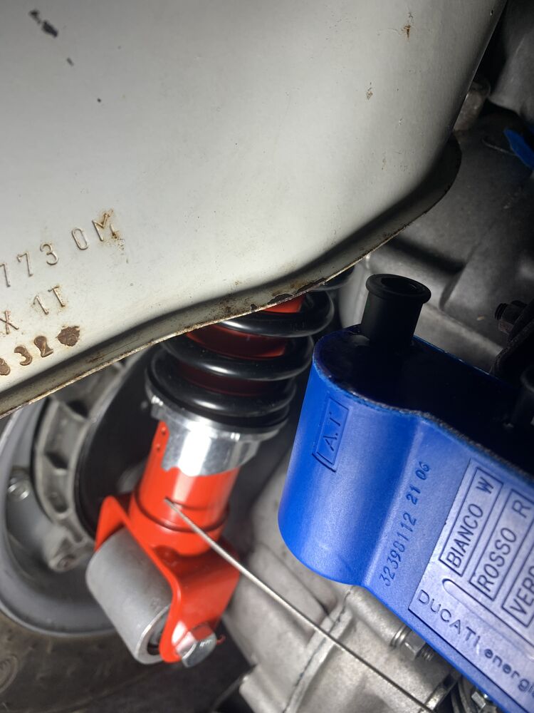

Nice, I'm coming to you with my fork drop / install questions. First one - what's with the gloves on the grips?
Laughing emoticon
VNB VSC VMA VSX - o9c vmb vse
Posts: 9469
Posts: 9469
Ha! That was all my better half.
My wife Lenny came out to place the big engine mount screw whilst I heaved the engine into place. She used gloves as the bolt was all oily/greasy....
she festooned them on the handle bars when she made her exit… muttering something about "Vespa Jazz Hands"

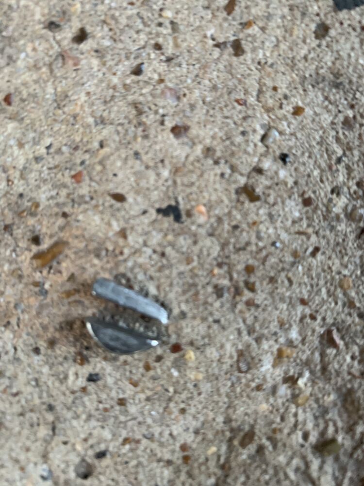

Update:
Found a sheared woodruff key…
No obvious worn wires, but still need to pull the stator and investigate further.
Put the timing back to factory and kicked it over…it ran well. Will do a proper deep dive over the weekend.
