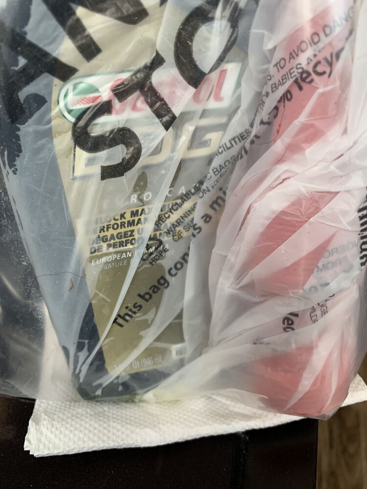

Had to carry spare oil in my backpack for a long ride recently. The bag wasn’t exactly the best 🙄 just wondering if something like a sealable water bottle is ok to keep oil in for a trip? So it doesn’t leak…..or do these oil bottles need to vent?
Oil is shipped and sold in containers which are not vented so I think the answer must be no. Small fuel containers for taking fuel backpacking should be good containers for bringing along small amounts of oil without worrying about leakage. I believe Primus makes several sizes including .35 L.
i figured, haha thanks man! are those kinds of bottles metal inside? the metal wouldnt affect the oil or the engine or anything would it? thanks again!

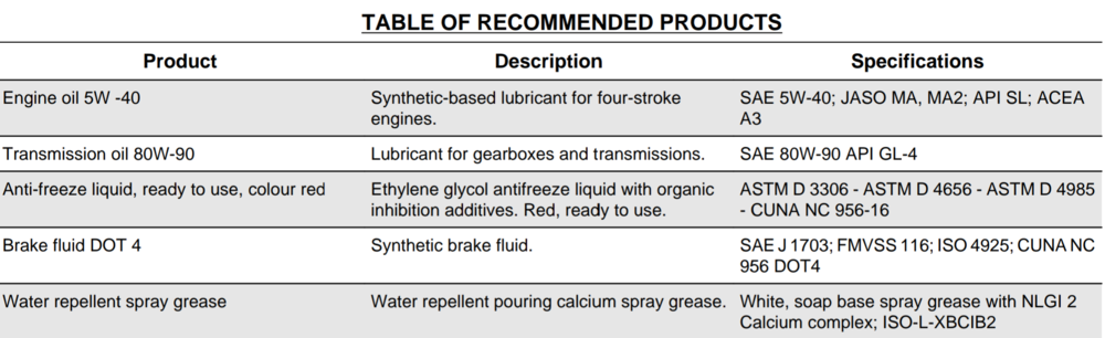

Morning all - can I just check what the correct oil is for a 300 HPE, my oil light just flickered on and off so I think I need to go and get some.
Posts: 7515
Posts: 7515
And the manual says

So 5w40 is the one...thanks for the advice.

Is any 5w40 oil suitable or does it have to be motorbike specific?
The 'experts' say it must be motorcycle specific. I just used the cheapest synthetic 5W-40 that Halfords had.
