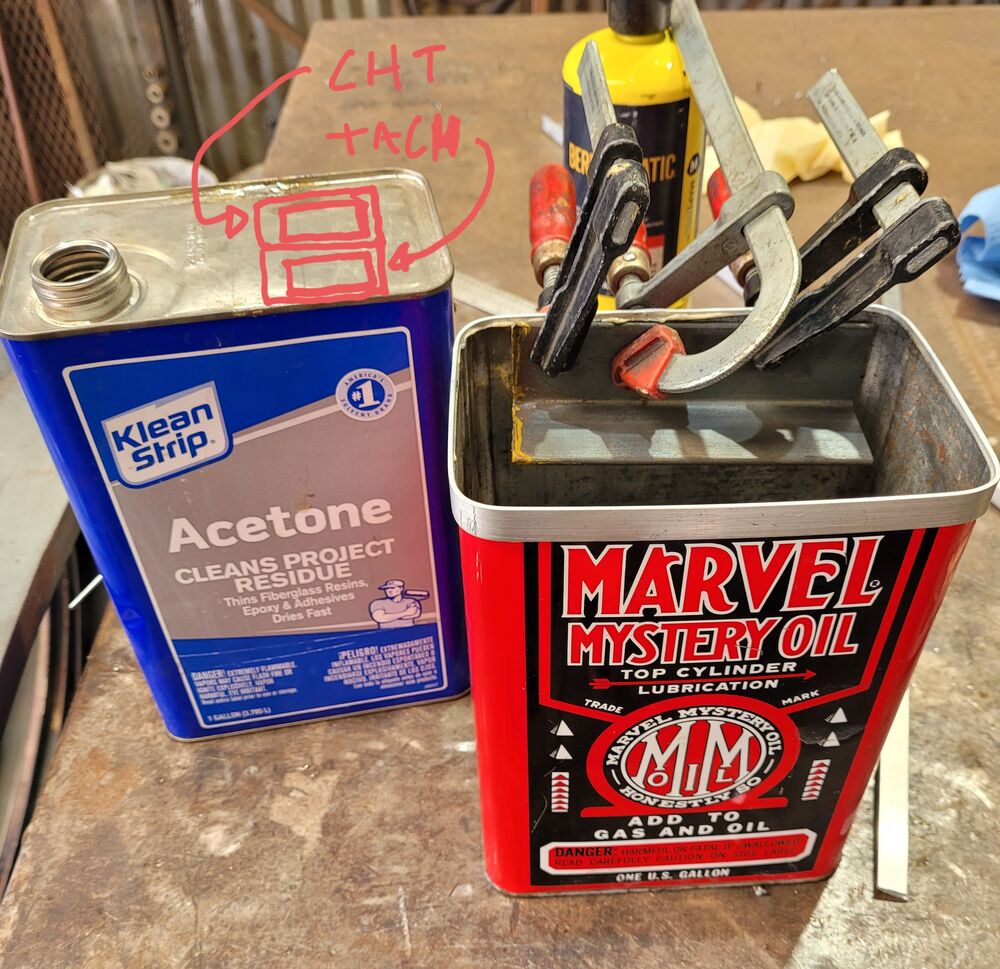

Borrowing an idea from an Allstate fan's Instagram photo.
Bought a vintage 1 gallon oil can on ebay.
Planning to use the spare wheel bolt holes to mount it. Bracket and can are ready.
Hoping to fit the CHT and tach on the lid (not sure if they'll fit yet), and making the rest into a glove box/secret stash keeper. In my case that stash will be two Modelo's.

Here's the project so far. Looks like the cht and tach will fit. Not sure if I'll be able to do a hinged setup or just make the lid a fitted cap.
I destroyed the original lid while cutting it off with a chop saw. Stupid. Going to use a new one from an acetone can and patina it later.
Oil can metal is like a paper bag without the top. Put an aluminum strap around it, PL glued. Solid now. Lid will have a steel strap to allow for patina.
Two 12oz bottles and insulation fit perfectly.

Here's where I'm at now. The lid is hinged. Lots more room than I expected inside.
Drilled a hole behind this setup to run the wires. Trashed one or two gear cables doing so Facepalm emoticon
Bracket is all 1/8" by 2" flat bar.
Bracket

Sweet! I'm diggin it R8 - very cool addition....

Using it as a storage box also since you have a hinged lid? I like the setup, gives me some ideas for my Allstate. I like the looks of a front mounted spare, maybe a version of this would fit in the middle of a spare tire.

Ray8 that's really slick. Nice work!
I ran mine up through the spare tire on my VNB.

I think I wanna get a spare tire like your setup BN. I gotta hunt down a bracket, then a rim...
